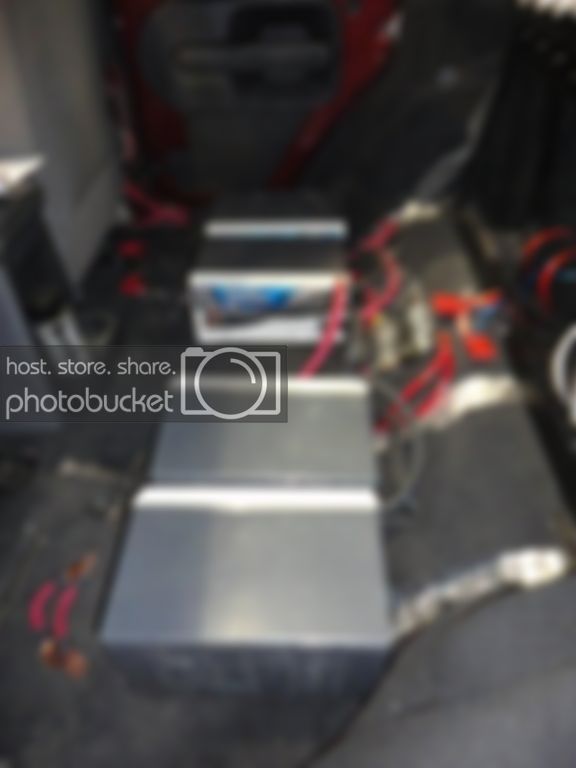

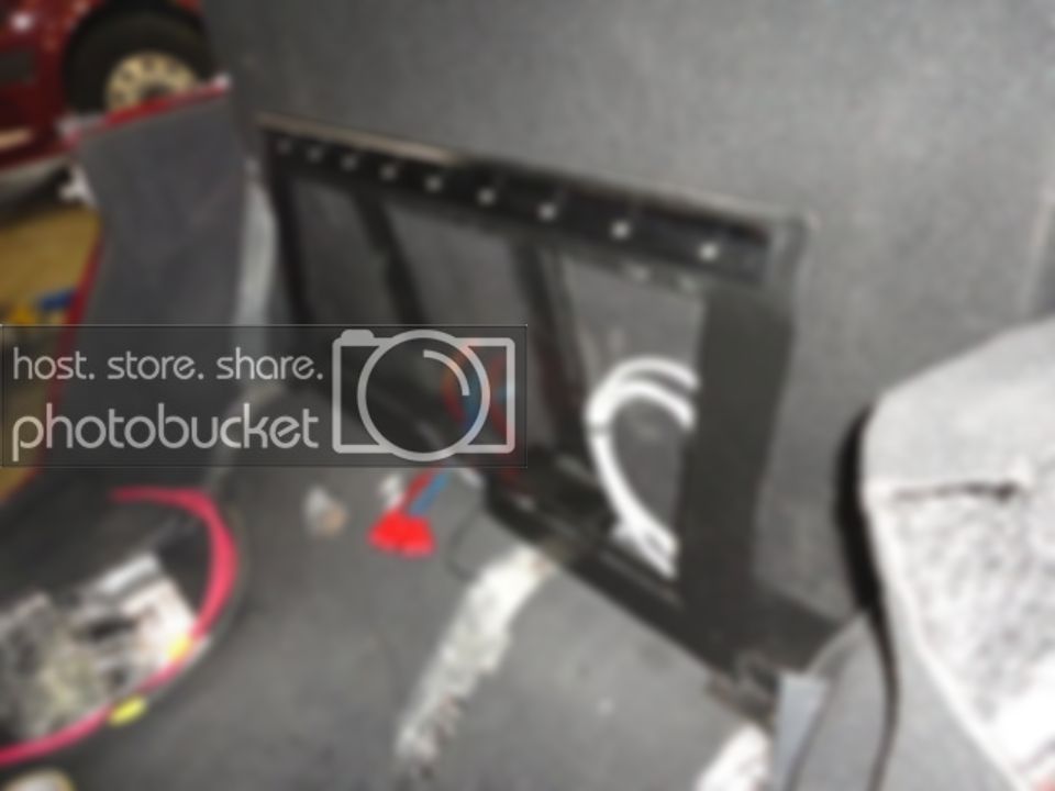

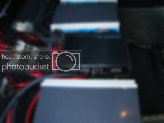

Made my amp rack using 1/8" steel plate

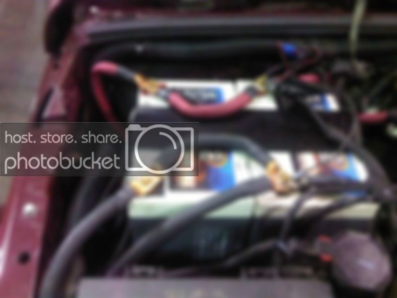

Also started adding the batteries

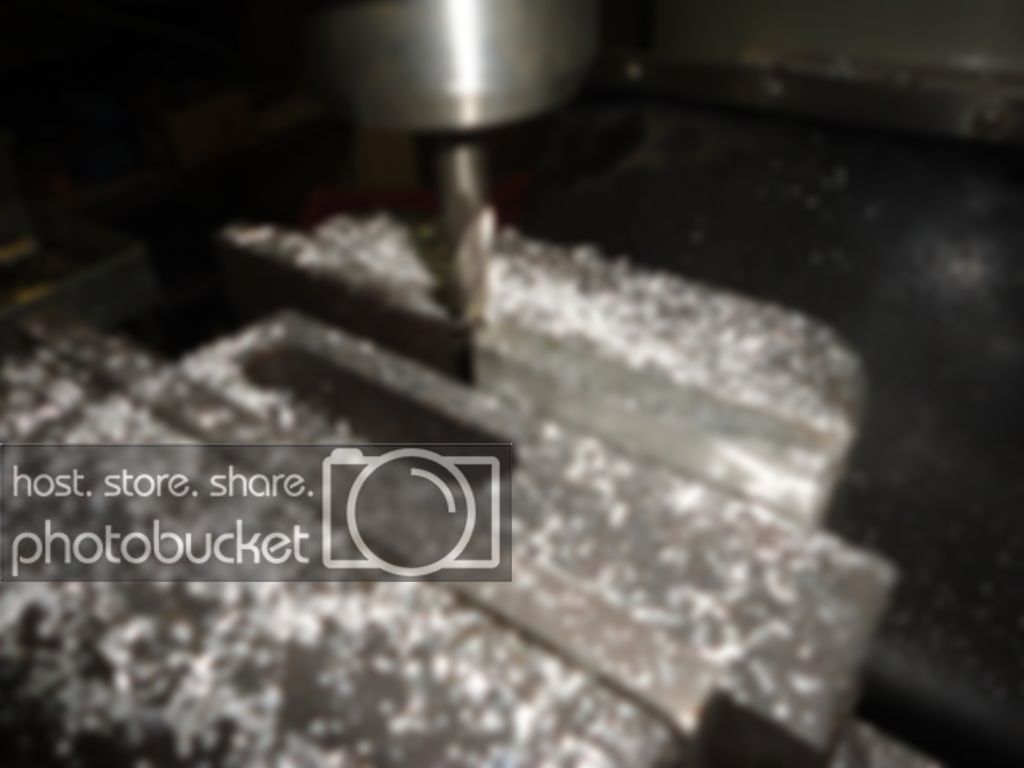

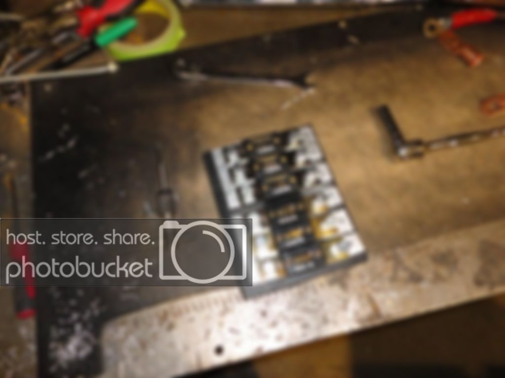

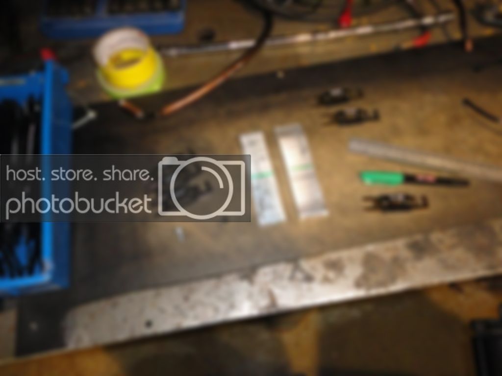

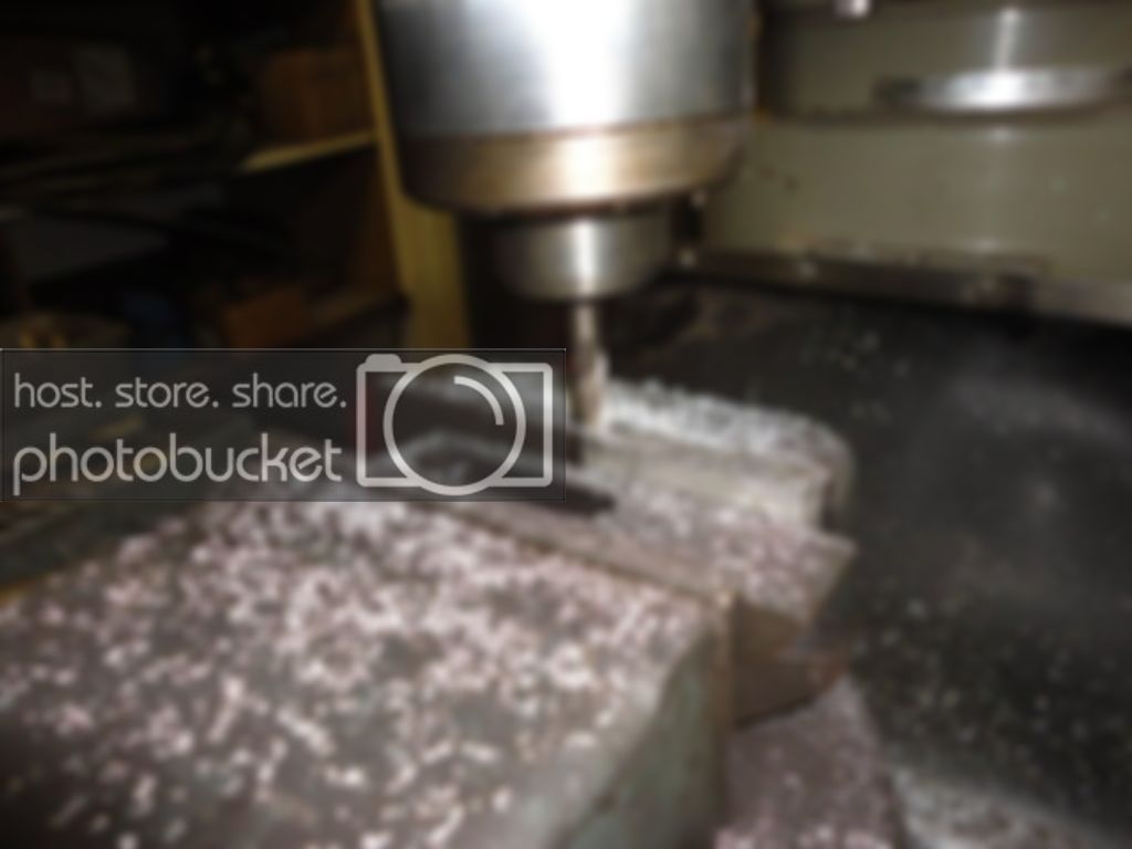

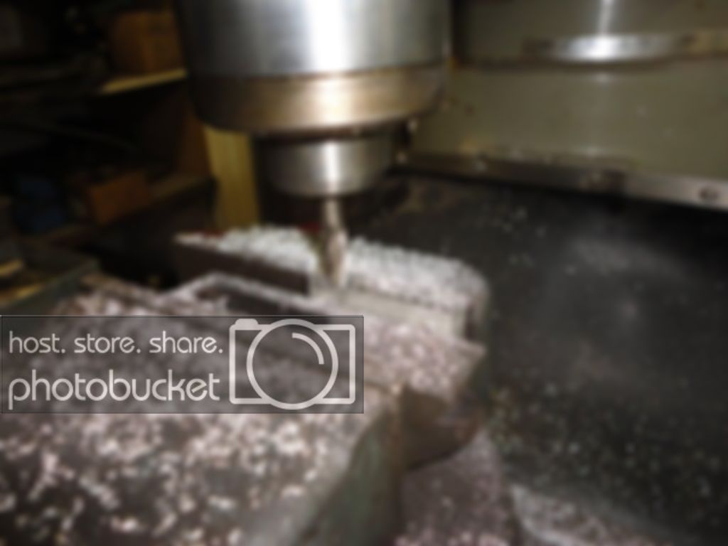

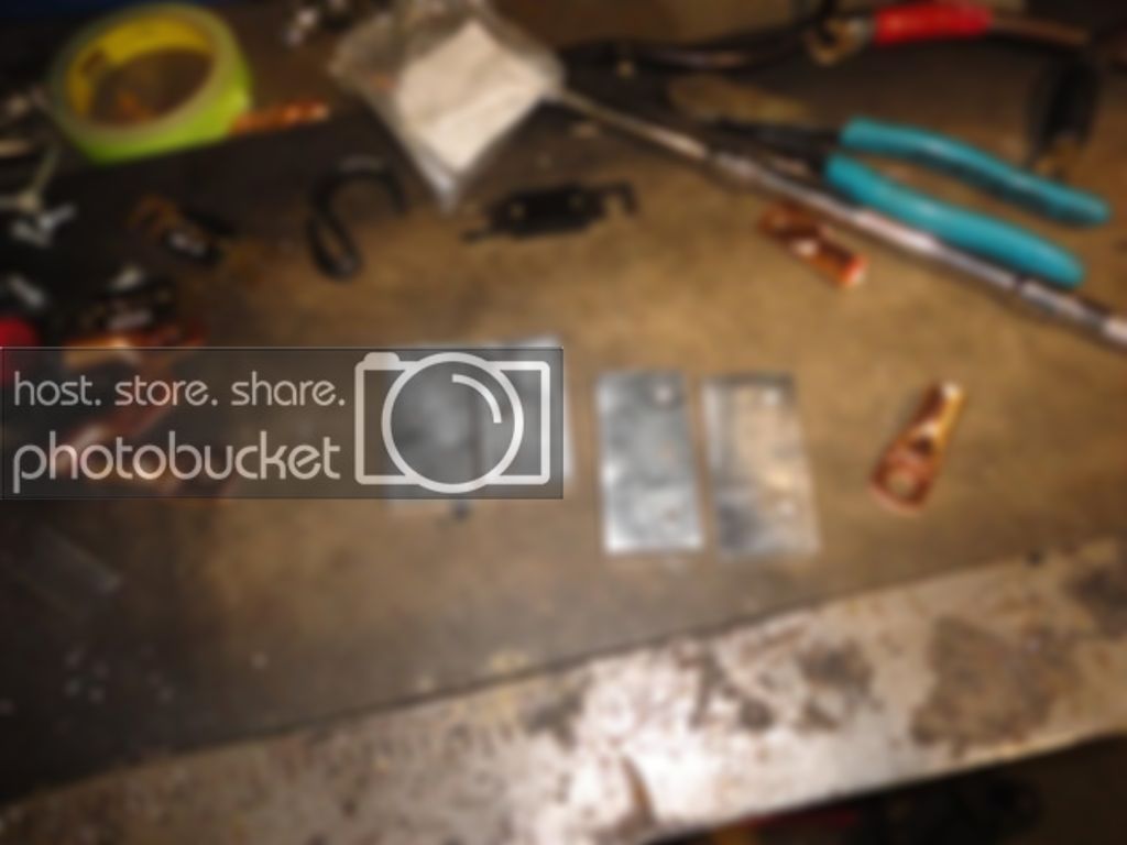

Then i cut some aluminum 1/4" plates for my fuses didn't wanna spend 80-100 bucks for a 6-fuse holder
Started milling the edges
and it turned out to be something like this

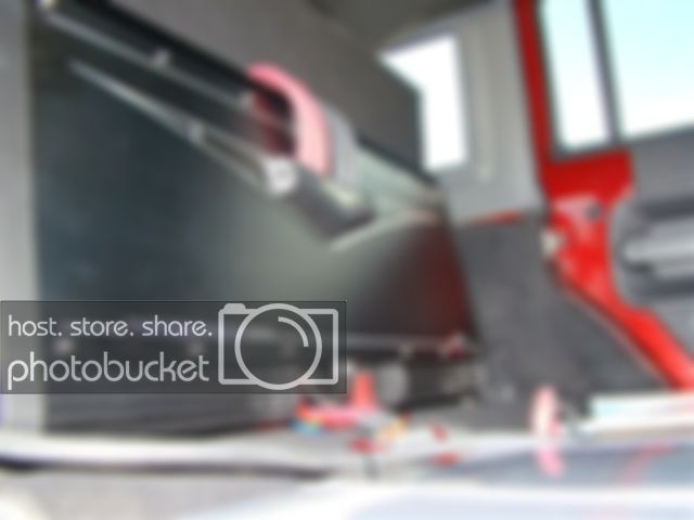

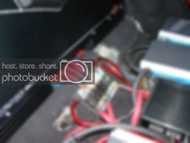

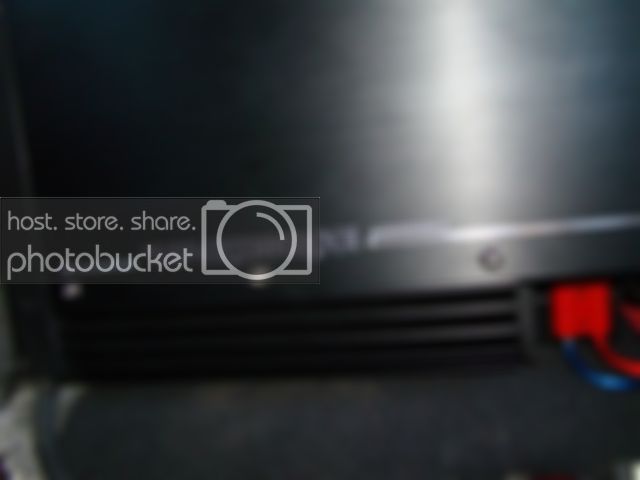

I finiished the front stage

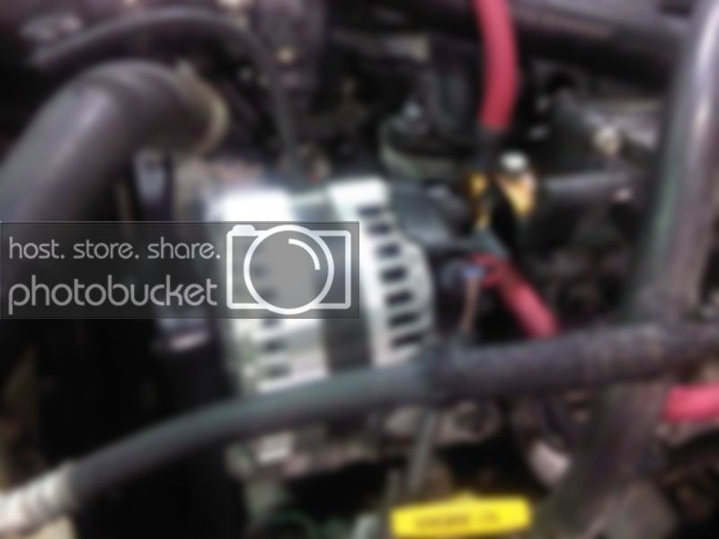

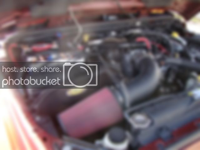

One going to the rear bank and one going to the front 2

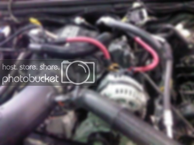

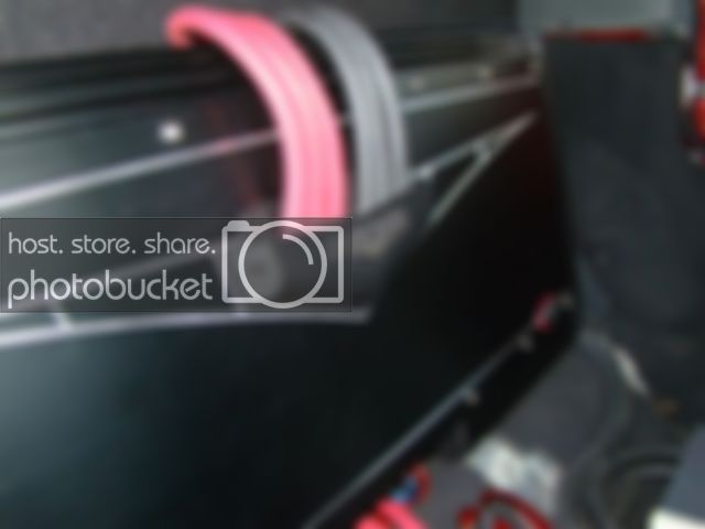

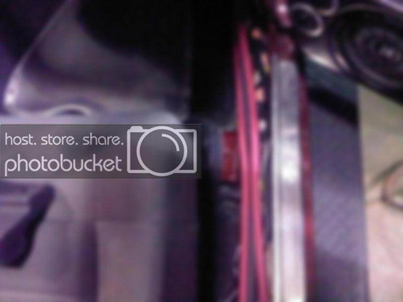

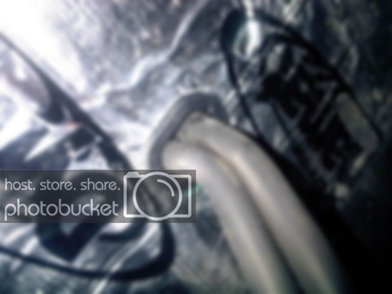

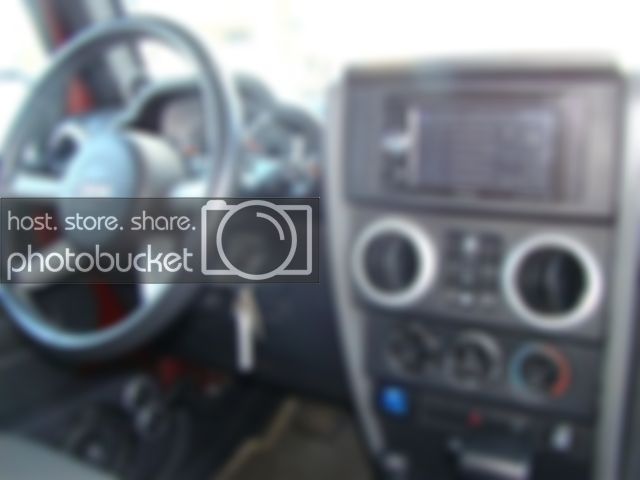

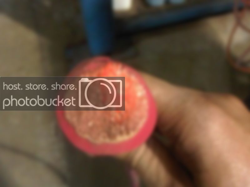

Ran the wires through my jeep
how thick the wire is

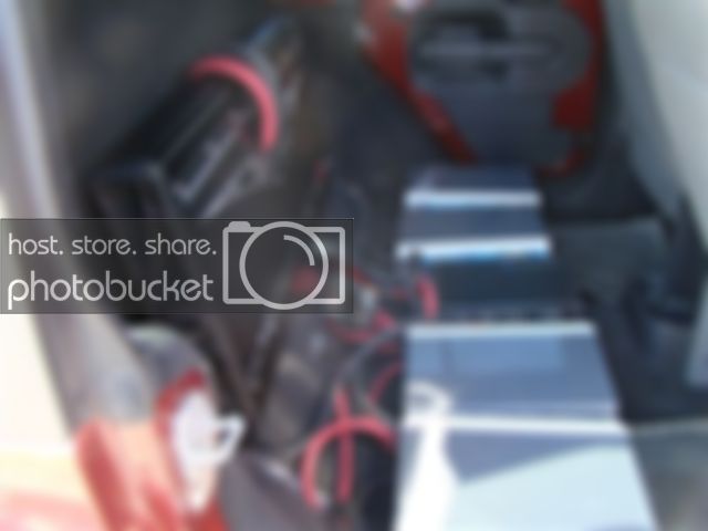

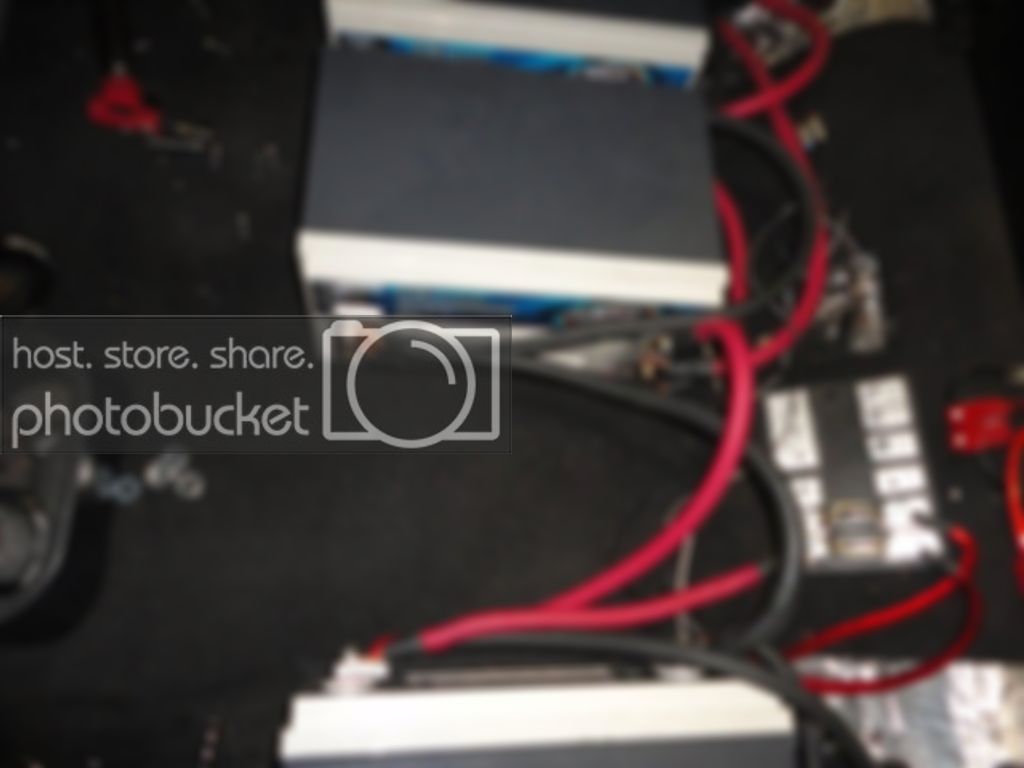

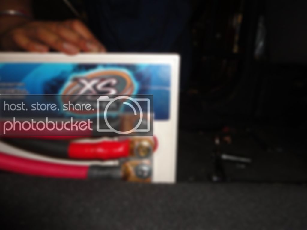

Milled out some more aluminum plates for my batteries, that way i can add 3 wires to one terminal
this is how it started to look, wiring all this was actually fun
as u can see one of the wires on the positive terminal is black, don't worry about that i cut an extra black wire and didn't wanna waste it

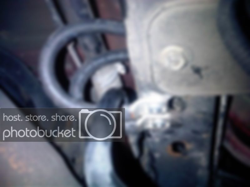

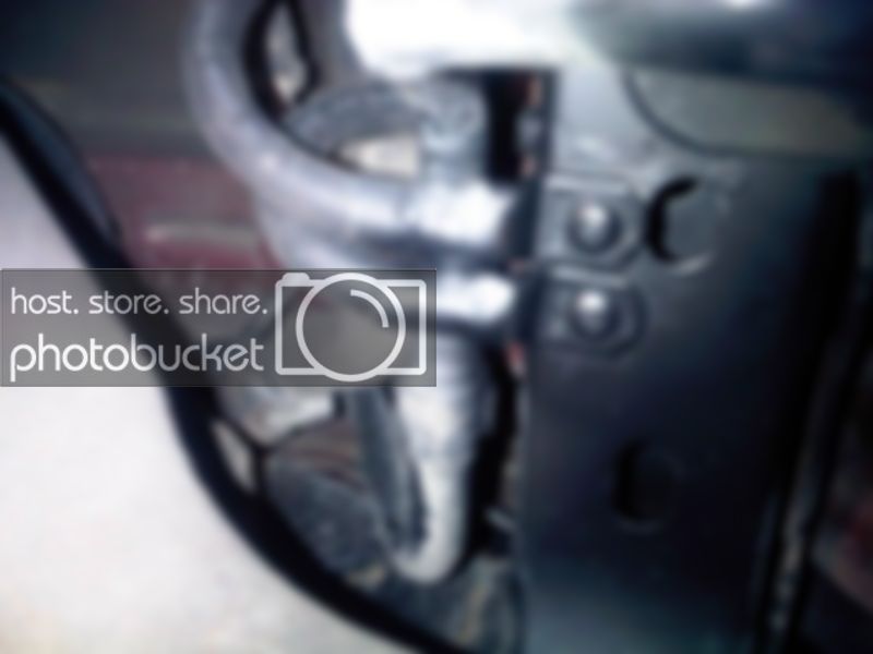

Luckily I saved alot of different types of grommets from working on various types of cars
this one was off a Toyota Corolla underneath near the torque boxes
it worked perfect for my application //content.invisioncic.com/y282845/emoticons/smile.gif.1ebc41e1811405b213edfc4622c41e27.gif

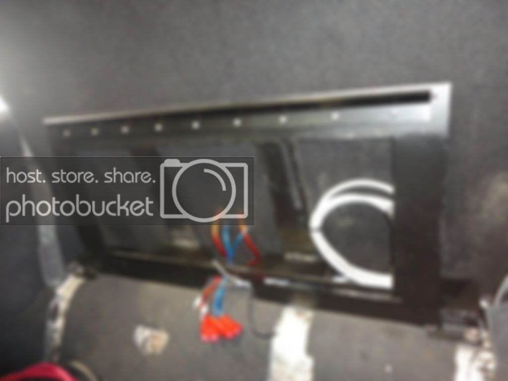

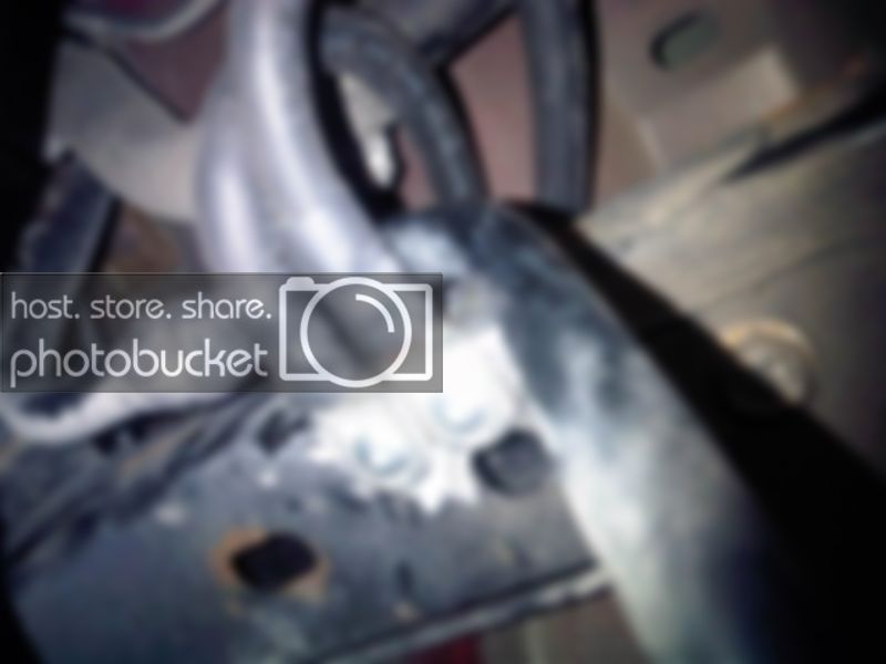

Found a nice place to ground my wires within 18" Like the Warhorse recommended and also they recommended that the wires be no more then 6" apart
Riveted these also since I couldn't get a nut behind the frame rail
Then i etch primered it, to prevent rust
Finished wiring all the wires
