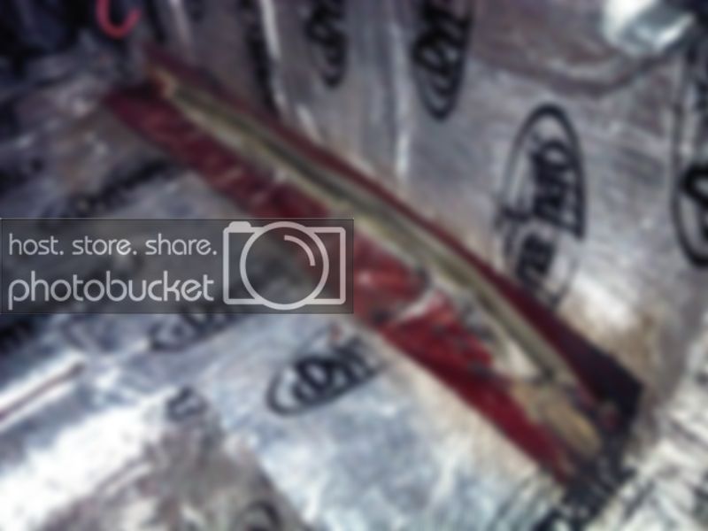

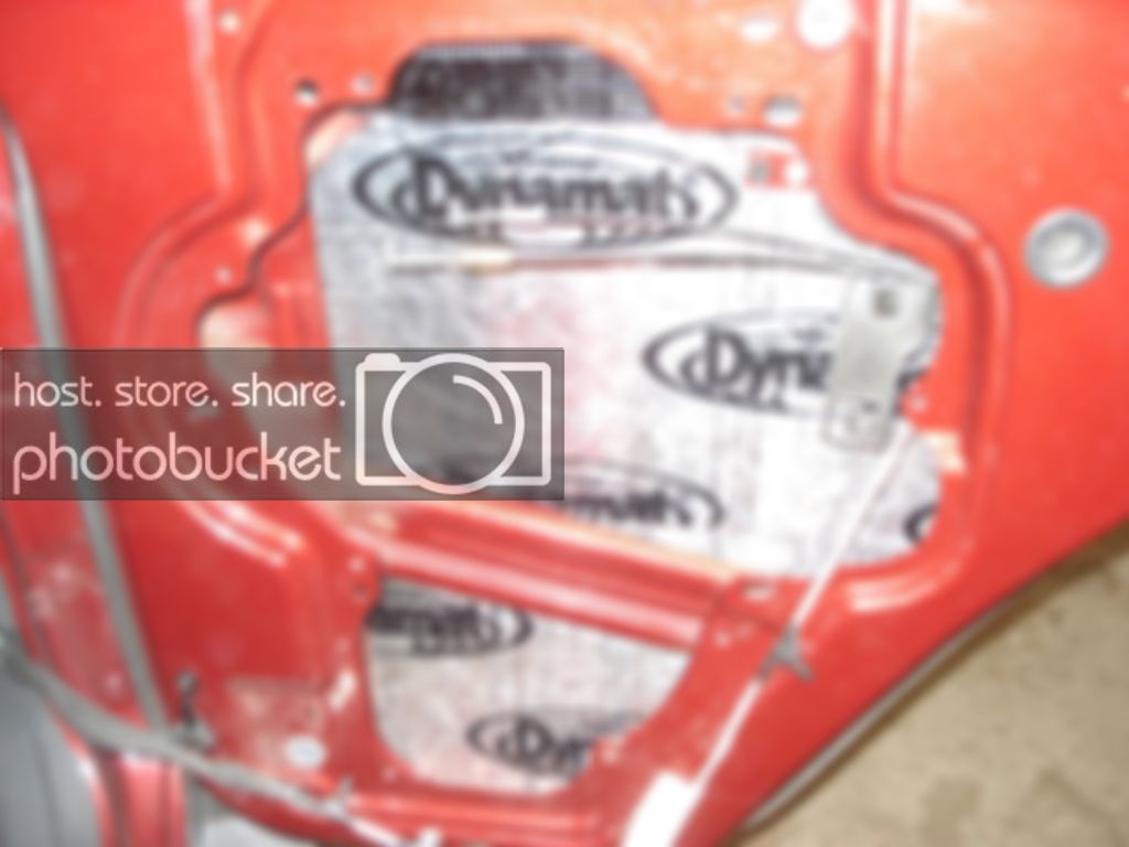

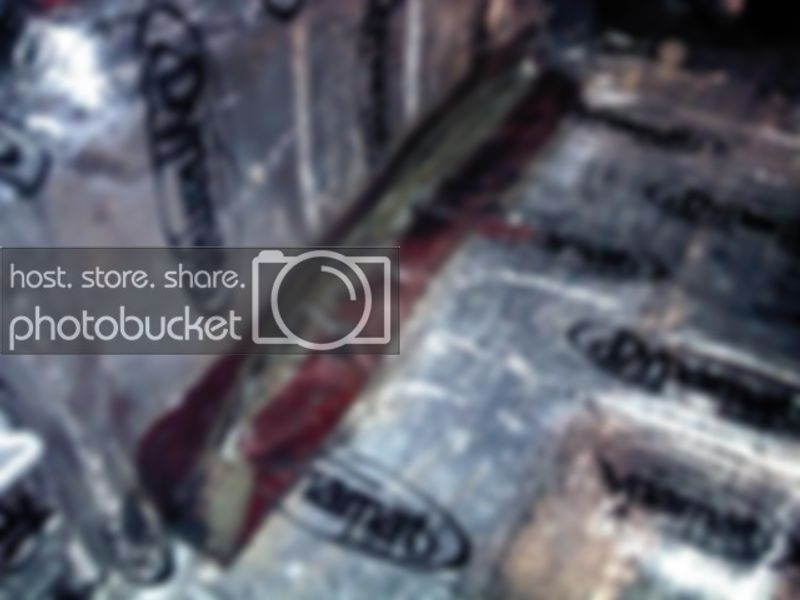

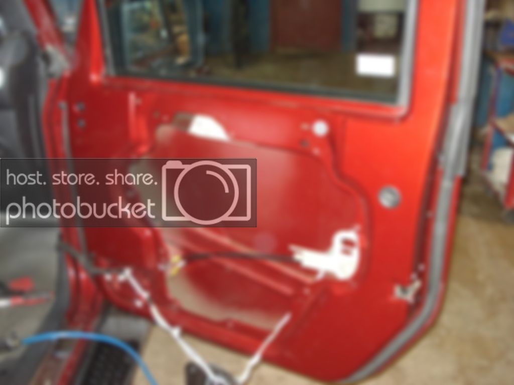

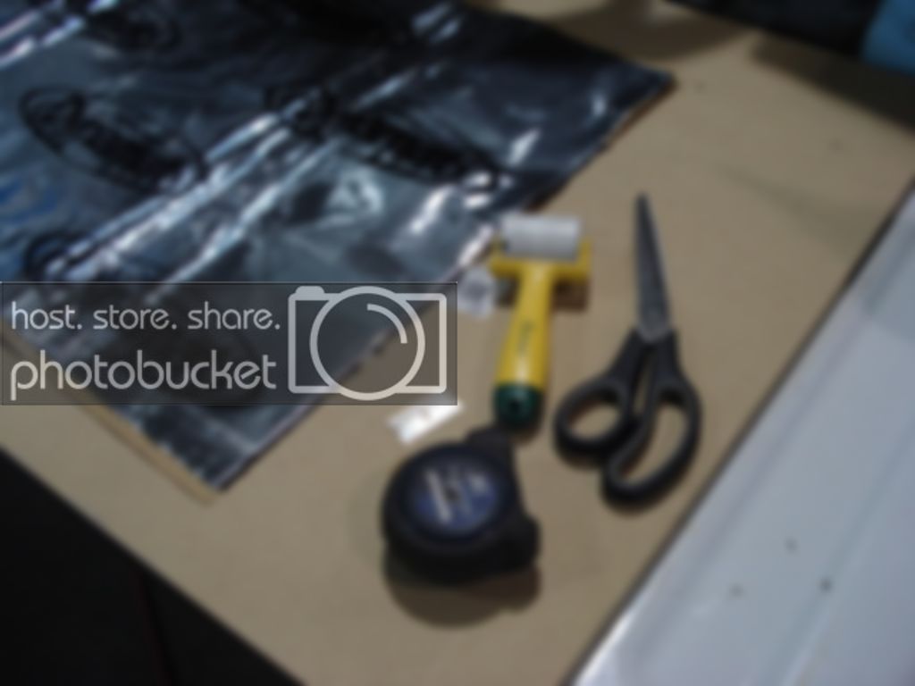

dynamating pics
Made sure the lettering was straight lol

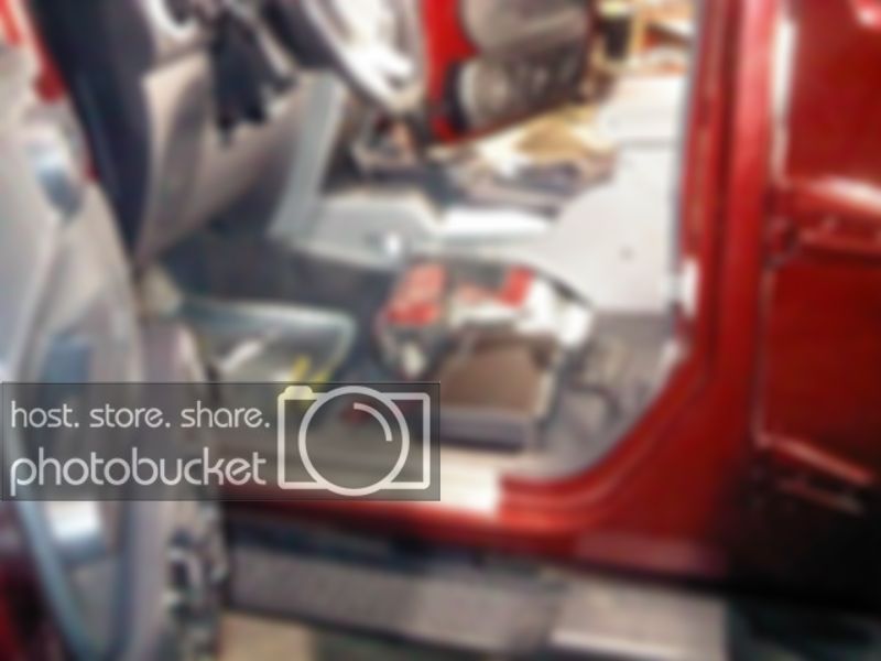

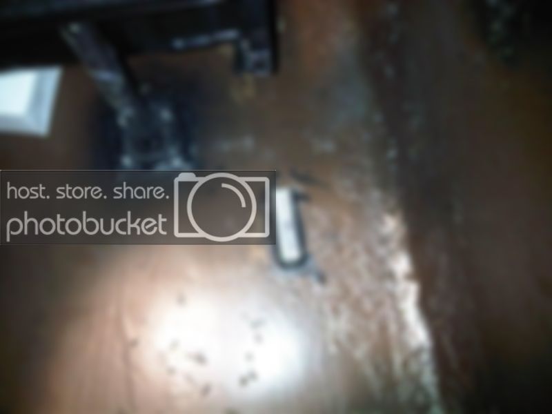

This was the amplifier for the doors, i also mounted this under my seat

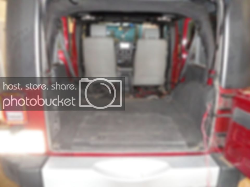

Pulled out my old 18

Had to knock these down, i later covered the holes with windshield urethane and put a layer of dynamat

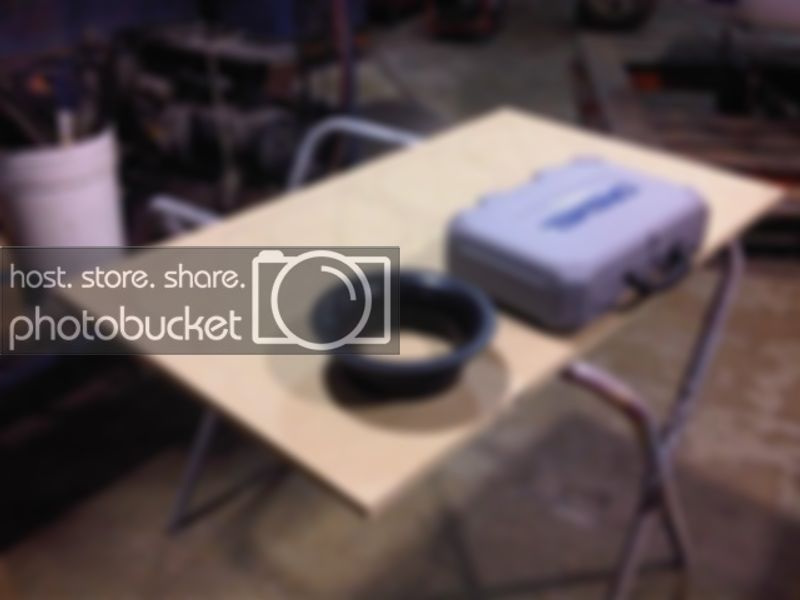

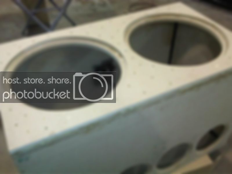

//content.invisioncic.com/y282845/emoticons/smile.gif.1ebc41e1811405b213edfc4622c41e27.gif This was my first box that i ever built!
So in the last picture i posted you can see that i brought out the dremel again //content.invisioncic.com/y282845/emoticons/up2something.gif.dd110ecf3ae4b76050d87598f2f8de7c.gif

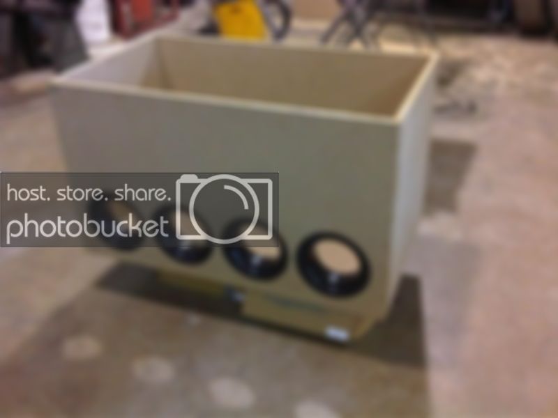

Started putting it together, made sure everything was square and flush

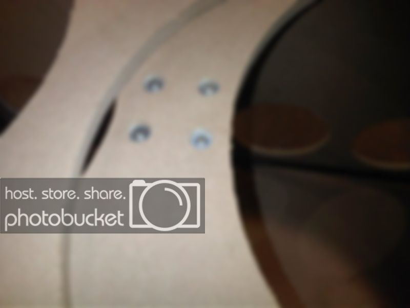

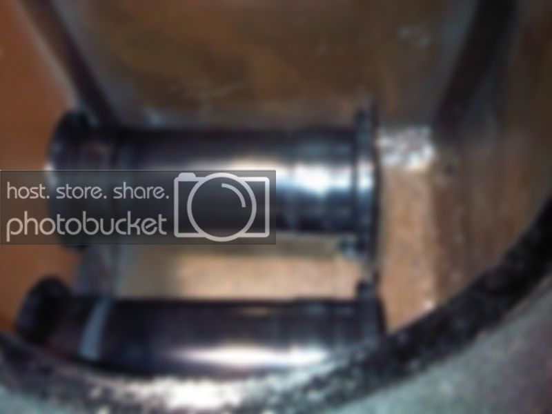

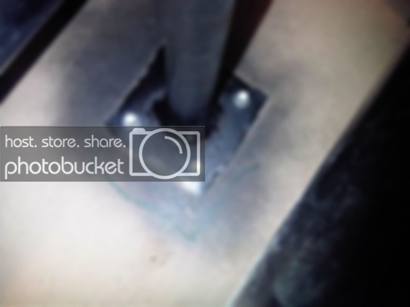

Rivets that i used for support, i made sure they were flush and didn't stick out

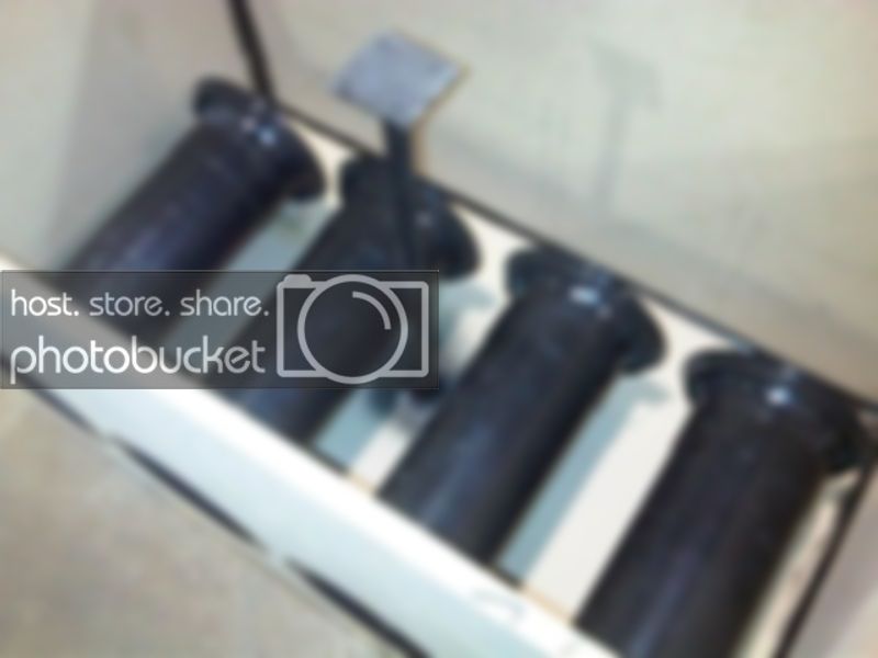

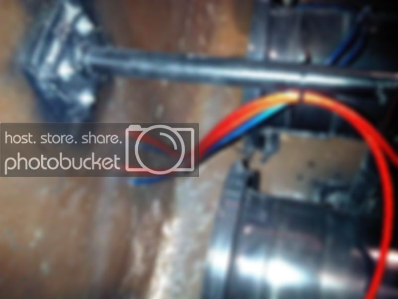

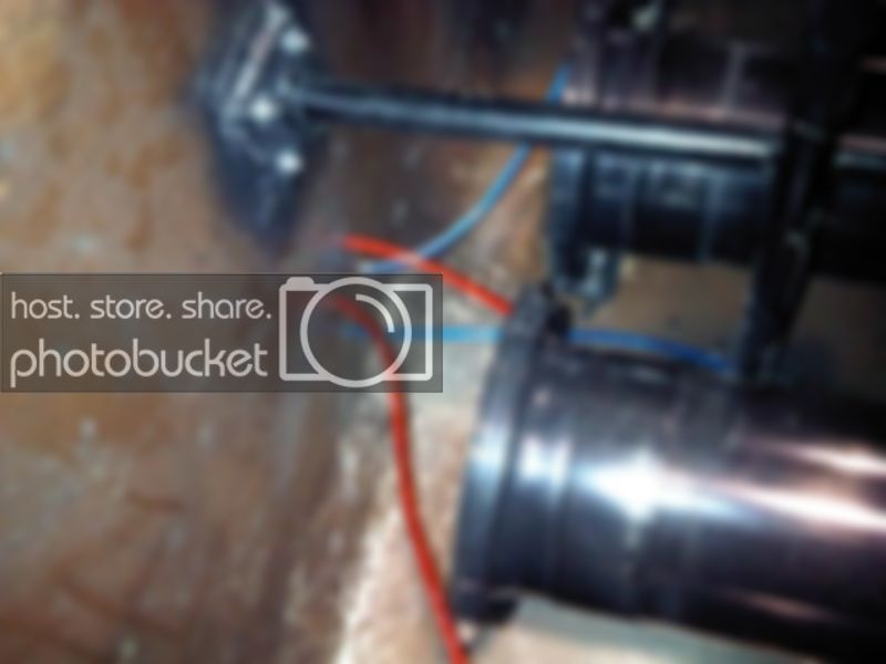

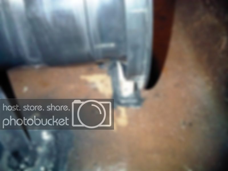

My supports, very strong 1" pipe with a 1/8" thick plate

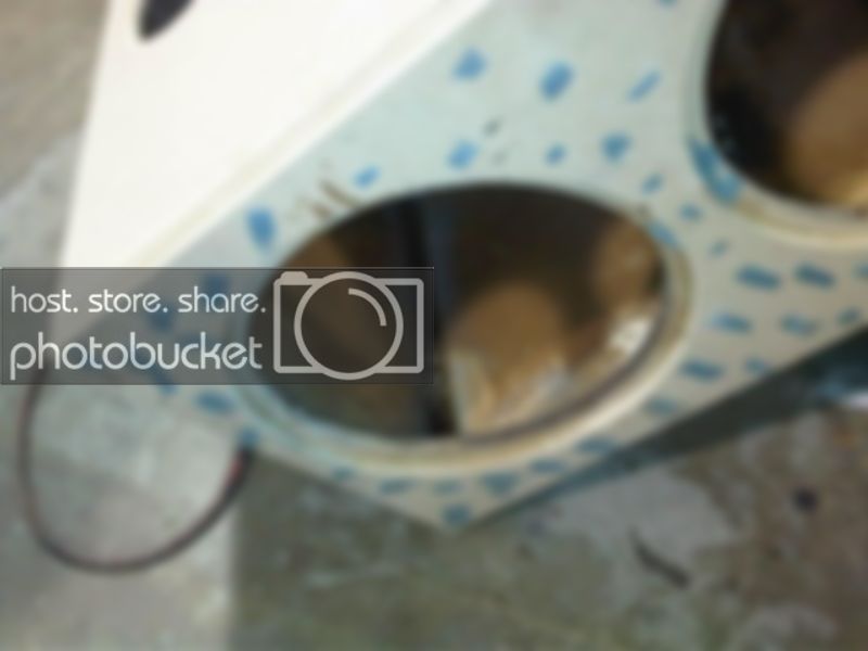

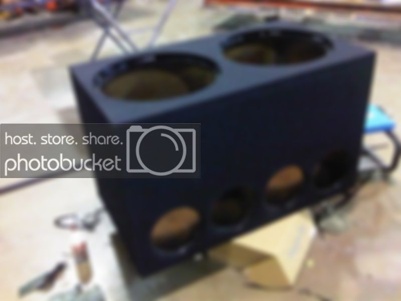

Double baffle
45'd resined the corners

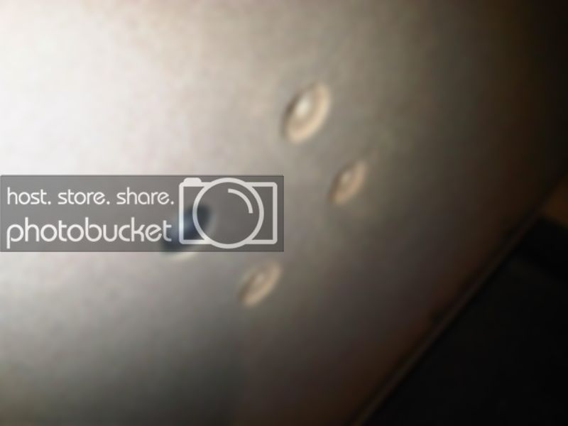

I also covered all the holes from the screws and rivets with some fiberglass bondo
The corners have fiberglass strands in it for extra strength
Carpeted the box
