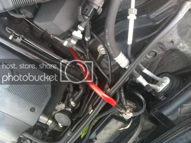

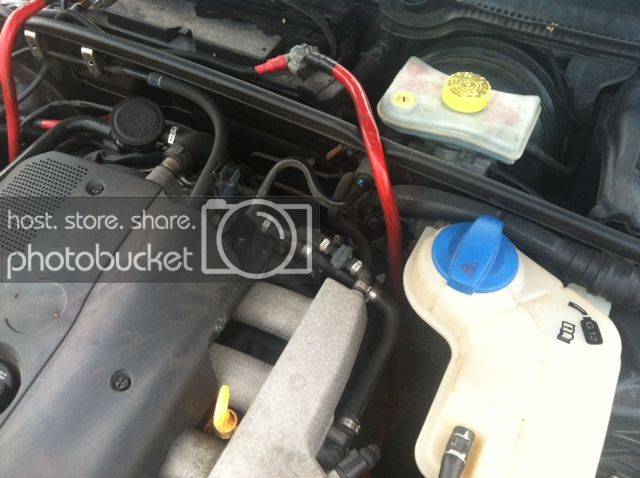

Started off with the big three. Nothing crazy, three pieces of scosche efx 1/0 Gauge wire added on to the car.

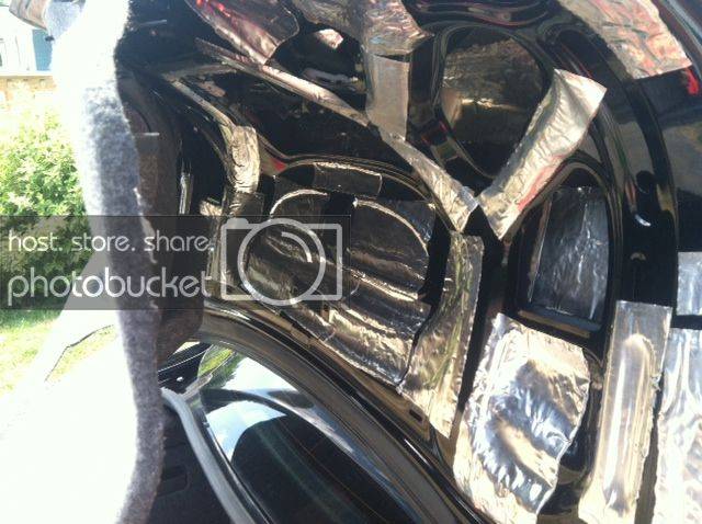

This is my trunk pre-deadened.

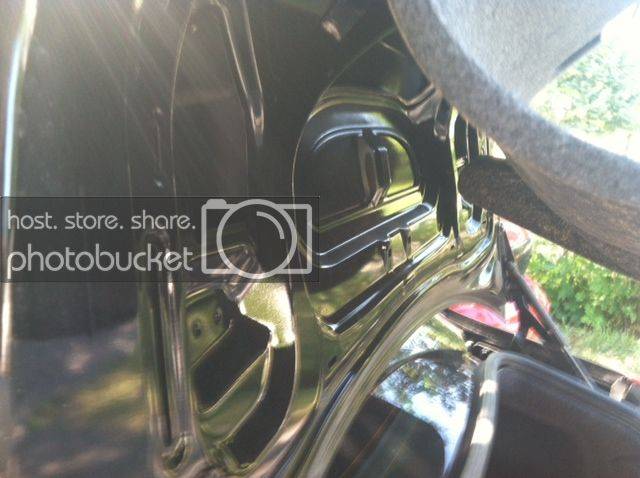

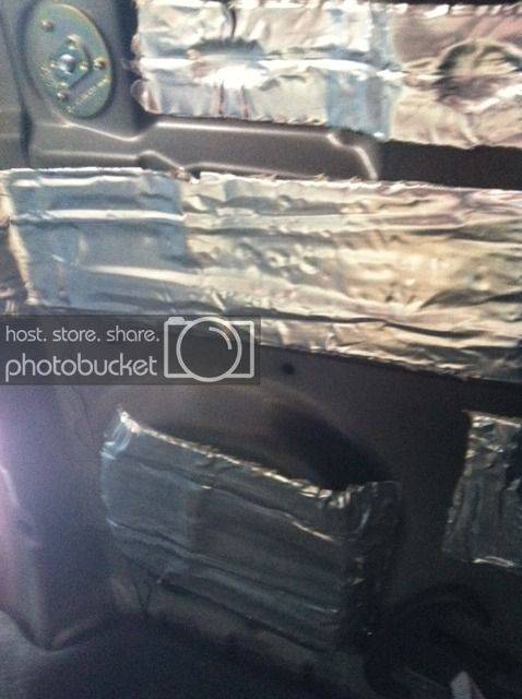

Here is a couple of pics of the trunk after it was deadened. I ended up going with about 35-40% coverage on the whole thing.

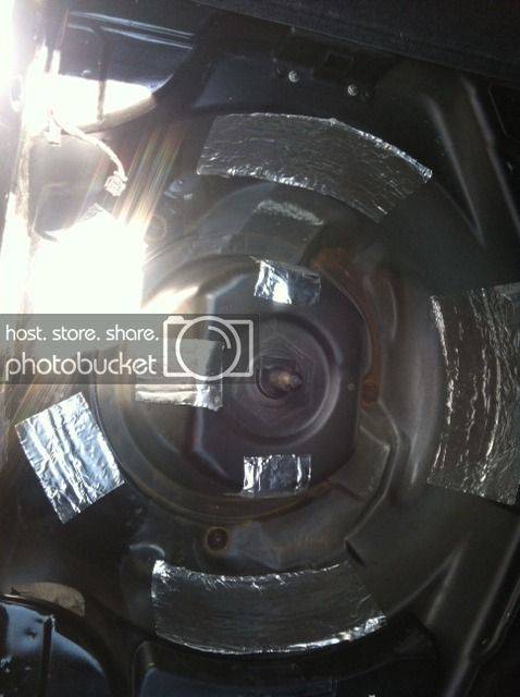

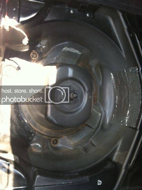

Now on to the spare tire well. this was after i cleaned it and put down one piece of deadener. You should have seen how rusty and dirty it was down there before i cleaned it.
Here is some post deadening pics. i didnt need to lay a whole lot down here.

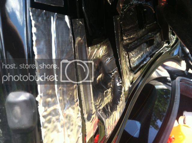

I also did below the rear deck. This made my stock sub shine.

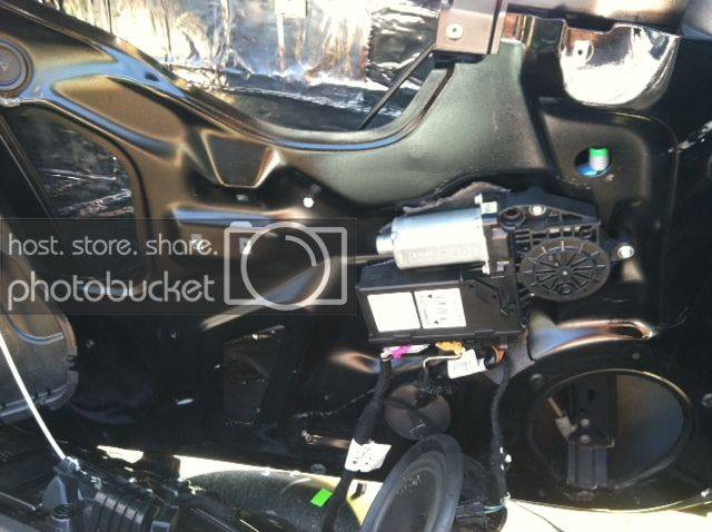

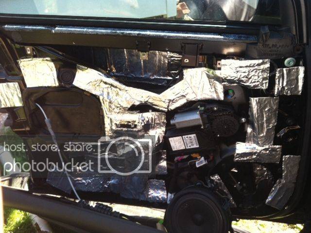

Then it was on to the doors. This took up the main portion of my day as i wanted to make them pretty solid while not trying to cover my entire door.
This is the driver side door predeadened. I took off some foam crap that audi thought would be sufficient enough in fixed panel resonance. they failed.
The post Deadened Product.

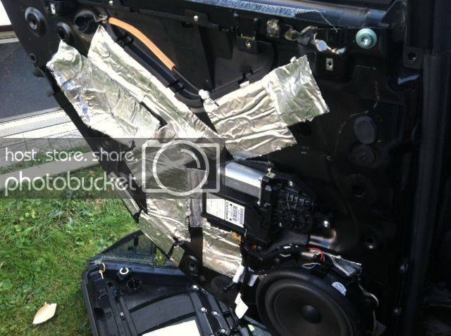

Now for my rear doors. These were a pain in the *** to get the panel back on. im gonna have to buy some new clips because some decided to break off. cheap plastic.
This is the final product of the rear door.
My overall experiance with audiotechnix sound deadener is this. if you havent bought it yet, even if your just running stock, you are an idiot. plain and simple. my trunk and doors sound like wood when i hit them, my midbass literally doubled in output in reference to my ears, my rearview shakes from my stock 8" sub and my seats even vibrate a little on the low notes. im not saying it is the end to all problems, but for a mere 100 bucks for 50 square feet of deadener, you cant beat it. and b-stock? should be called im giving this away cheaper for no reason. I had no trouble applying it, or taking of the paper backing. the job took me 9 hours, but it was well worth it!

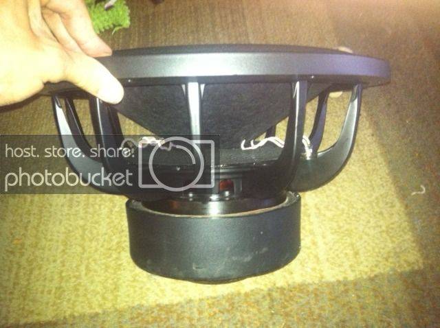

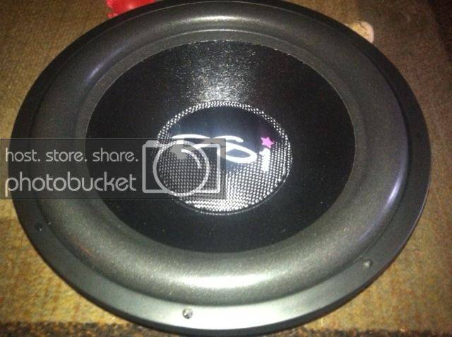

Now on to the subwoofer! I went through the ringer with this guy. was originally a memphis cm cast 2010 d4 mojo. sent it to psi to get a cf dustcap and reconed to a d1. the basket ended up getting cracked during shipping. dave contacted me and told me it was gonna need a new basket. so i just told him to put the new basket on and i would file a claim through UPS. literally just got the call that they denied my claim. last time ill be using them. dave did a great job with it though and im very happy with how it came out.
Thats all for now until mobile enclosures finishes my box design. he is almost done with it. then i can put up some pics of the box build. and my amp will be shipped july 30th, so hopefully by mid-august ill have some bump. Its been an exciting build so far!

i really suggest drilling the firewall between the engine bay and your battery just wedging the wire in between the foam and the hood could result in a fire or other electrical problems. even if you notched the fire wall so no pressure would be on the wire that would be better.
I'll figure that out when that day comes. Still gotta build the box this upcoming weekend. Either way im going with audiotechnix wire.
