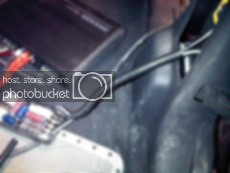

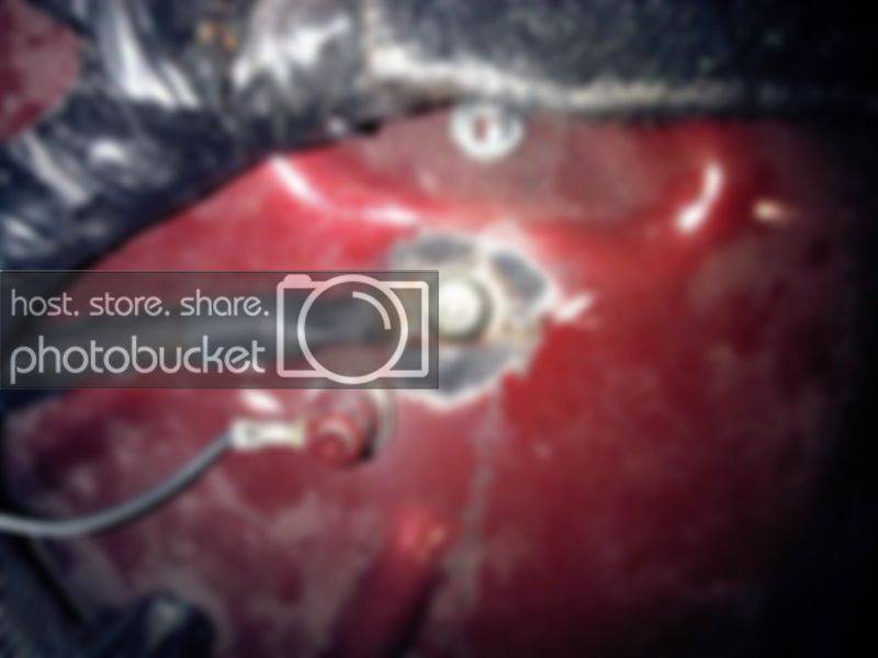

Around January, while i was driving 40 kms to Centennial College (I was taking a auto body apprenticeship course) my whole right side channel speakers popped, my t500.2 amplifier got messed and sh*t was just horrible. I didn't know what the problem was because i checked all my connections that i had modified and everything was tight and clean. So then one day i went bowling with my cousins and my Jeep broke down on me, it wouldn't start so then i had it towed to my dads autobody shop.
i later found out that the positive lead that goes to my fuse box had corroded and was loose. I sanded it down and and cleaned the corrosion off it. It fixed all my problems!

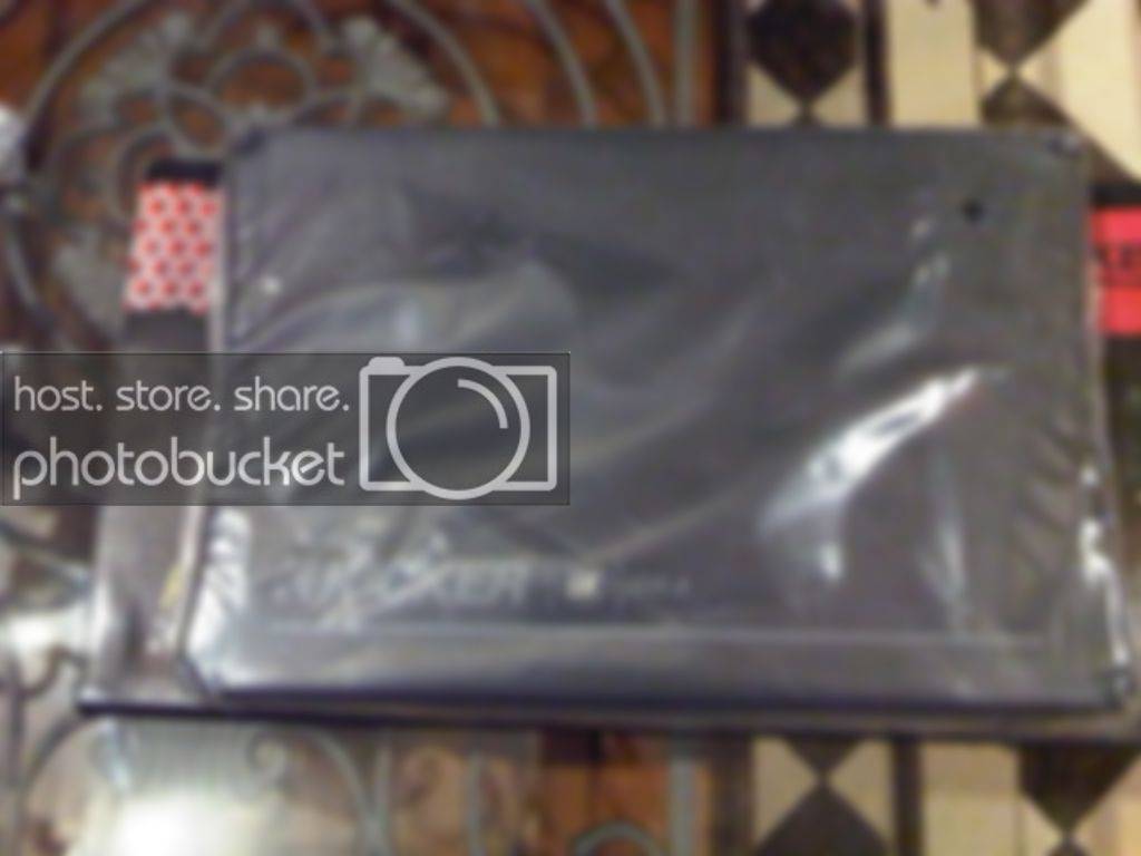

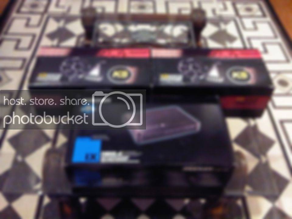

Some of the Amplifiers and Speakers

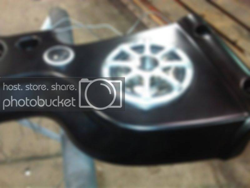

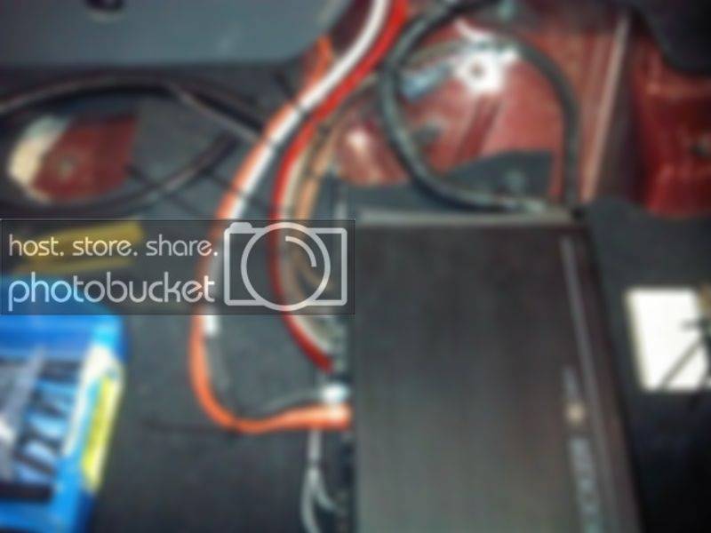

Thanks //content.invisioncic.com/y282845/emoticons/biggrin.gif.d71a5d36fcbab170f2364c9f2e3946cb.gif here are some more pictures

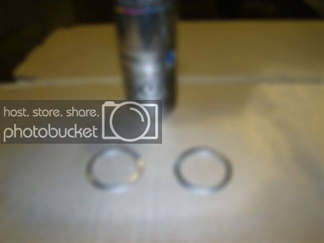

painted the trims so that it matched the interior of my Jeep
