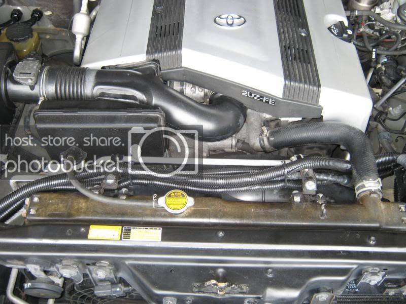

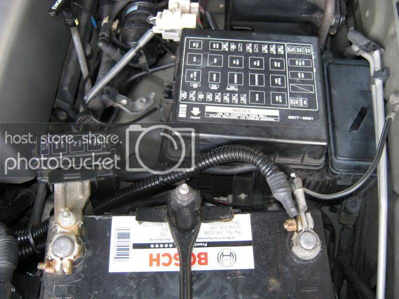

The electrical system was upgraded to accommodate the new audio system. The battery to chassis ground, battery to alternator, alternator to chassis ground were upgraded with 4ga wiring.
The OEM battery terminal had one open spot open and that was utilized for positive hook up.
The main fuse for the audio system is mounted on a fabricated metal mount that mounts using OEM mounting points.

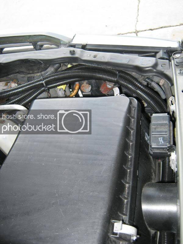

0ga power and ground wires were ran into the cabin using weatherproof grommets.
On the frame in the engine compartment there was an open threaded hole which was used for an upgraded grounding point.
The alternator had an unused stud that served as a point for an upgraded ground run to chassis.

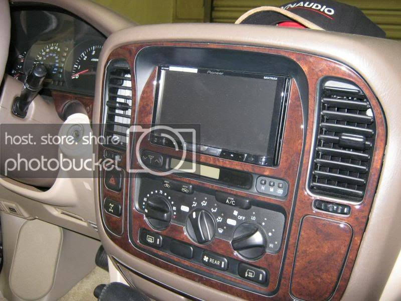

The Pioneer AVH-P8400BH mounted in the dash. A clean wiring harness makes for any future work in dash an easy venture.

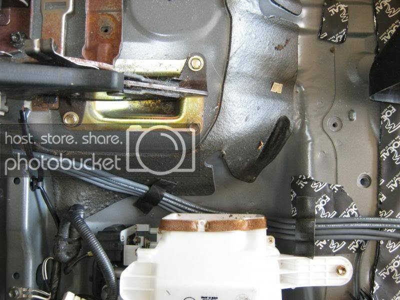

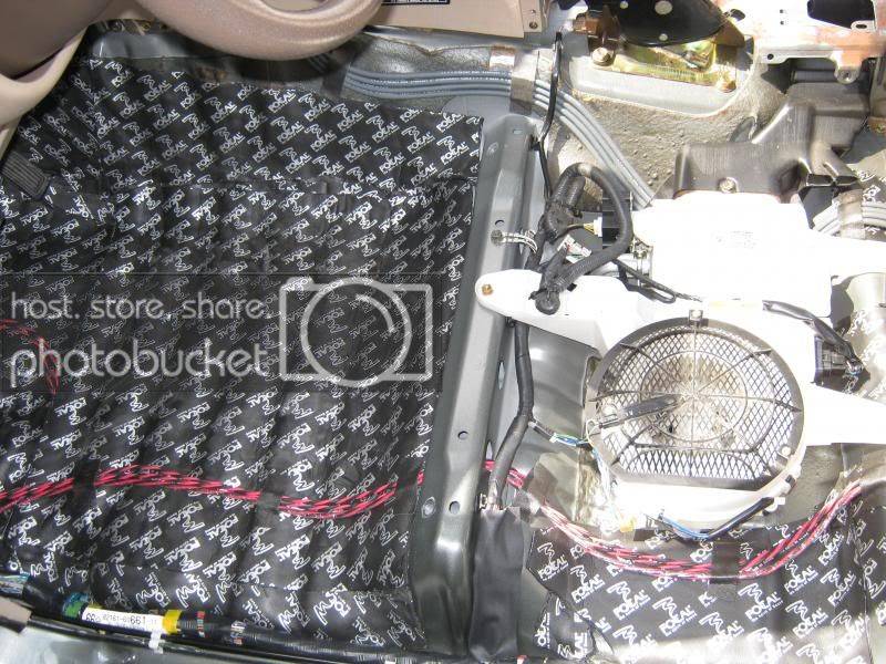

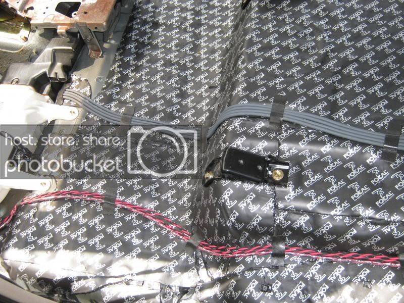

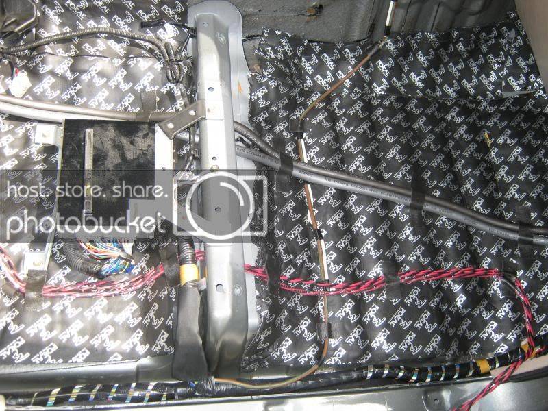

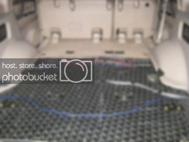

The entire floor of the truck received a layer of Focal BAM sound damping. All speaker wire and RCAs are held down with Hush Mat Quite Tape spaced at 8" increments. Straight Wire was tasked for the speaker wire and their Symphony RCAs.

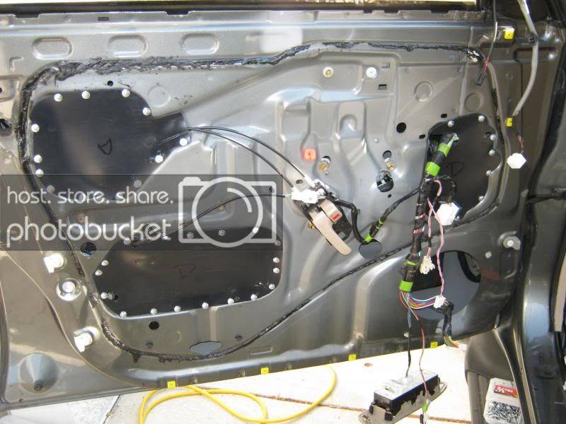

Black Hole Tiles were used inside the door to kill the rear speaker sound waves.
Removable 1/8" ABS panels were fabricated to seal up the holes in the inner door skin. They were also heat formed to follow the contours of the door for a better seal.

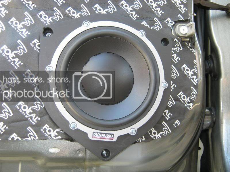

Once wired up the DynAudio Esotar E650 was mounted to the rings using #8 screws.

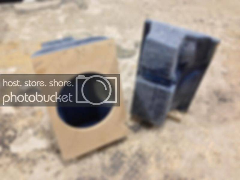

As to not take up rear cargo room fiberglass enclosures were fabricated to tuck into the back corners as far as possible.
1/4-20 nutserts were used to mount the enclosures.
Black Hole Stuff enclosure filled 100% of the interior of the enclosure less room for the driver. Black Hole Stuff enclosure filled 100% of the interior of the enclosure less room for the driver. With the enclosures coming in at .43cuft the Stuff fill will provide the extra compliance to allow the subwoofers to have a lower end extension that will not have been possible with such a small enclosure. The stuff is magic (pardon the pun).

Rear cargo wiring was held down with Hush Mat Quite Tape at 8" intervals and wiring intersections are at 90*.

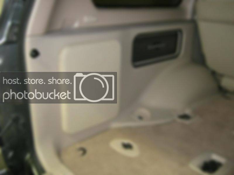

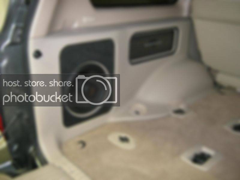

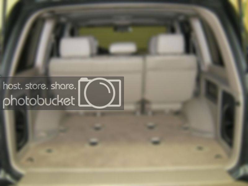

The rear panels were designed to take advantage of the OEM plastic panels as a base. The finished side panels were wrapped in OEM vinyl. Following the look of the kick panels black Alcantara was used to give a great contrast to the rear components. As you can see with the subwoofer grilles and amplifier cover panels in place the rear cargo area looks very OEM and the best part being the audio system took up 0 rear cargo room. With this set up if John ever wishes to put the third row seating back in the audio system will not interfere with them going back in.
And to protect the subwoofers removable grilles were made and wrapped in the same grille cloth as the doors and kick panels.
