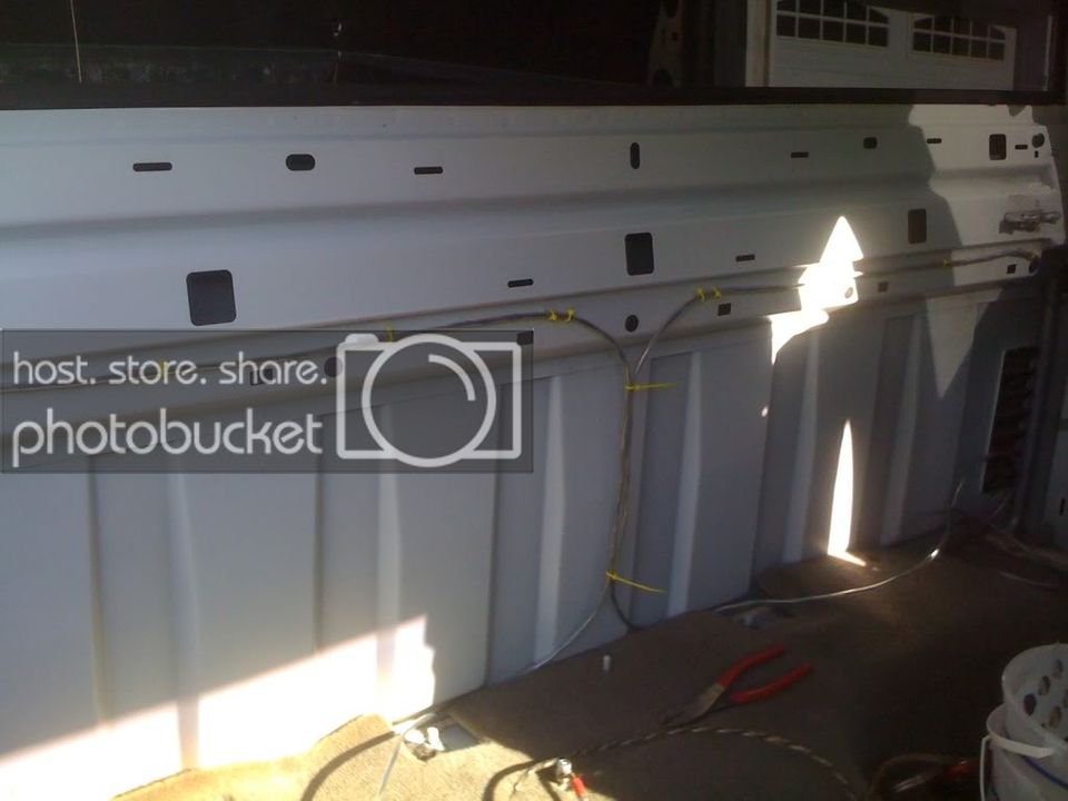

i prefer to run my own wiring, that way i minimize resistance through wire gauge and connections. factory wire is usually small with very long runs.

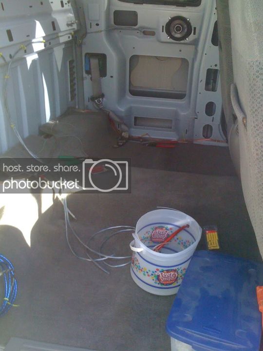

Some updates...

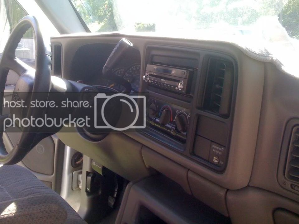

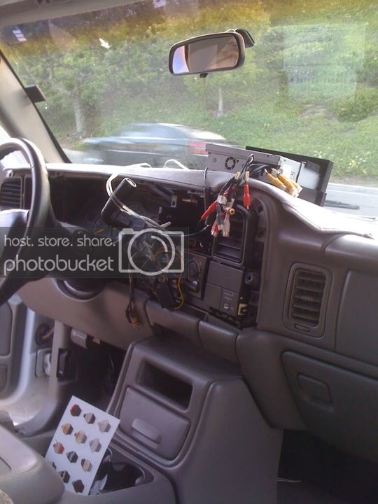

This is what my truck has looked like the past few days.

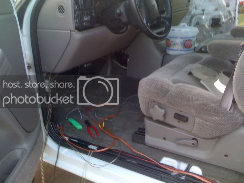

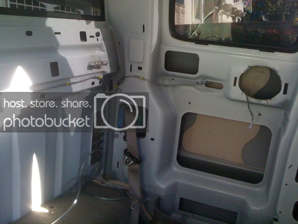

Today I got around to cleaning things up and wiring in the speakers //content.invisioncic.com/y282845/emoticons/happydance.gif.a963168fea27d8453c3ec467ddcf9e1c.gif

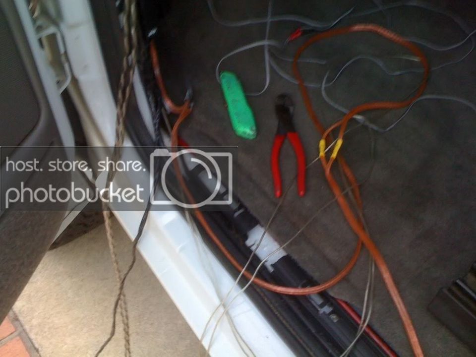

They had nice little clips that were holding the factory wiring up, so I was able to zip tie my new speaker wire to it //content.invisioncic.com/y282845/emoticons/smile.gif.1ebc41e1811405b213edfc4622c41e27.gif
Got my speakers back in hooked up with some good wiring!

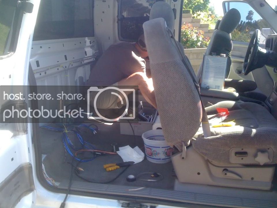

And best part is, my dad came out to see how it was going and decided he wanted to help me!

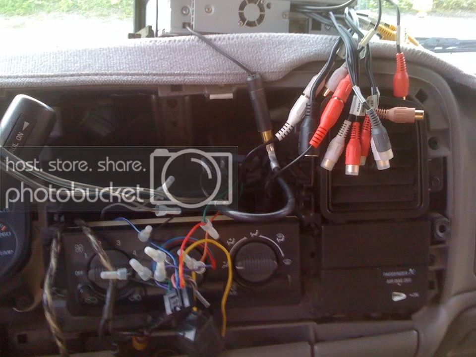

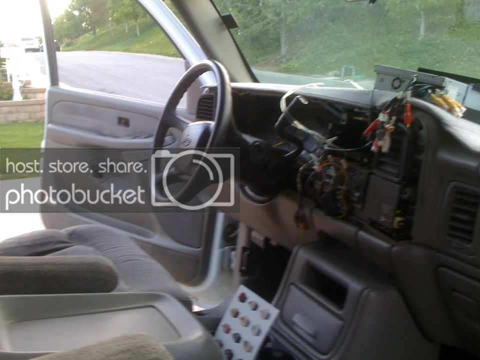

Got the head unit back in and everything cleaned up...
Just waiting for some wiring to come in the mail, along with the fatmat, fuses, and a few do dads. Once the fatmat comes I can put that down and the get the carpet back down and put the stuff back up on the wall. Then I will be able to build my amp rack and stick that in. Once that's done, the subs will be in motion! //content.invisioncic.com/y282845/emoticons/happydance.gif.a963168fea27d8453c3ec467ddcf9e1c.gif

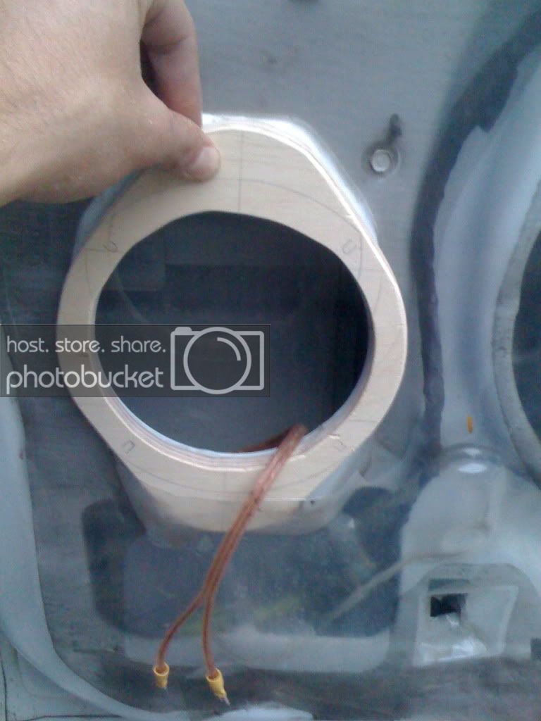

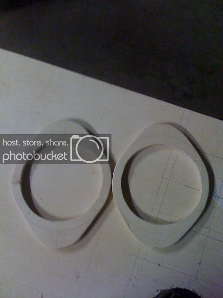

What do you mean seals around the front speakers? And Ya i decided I really didn't like driving around listening to the sound of my exhaust(although it sounds awesome, just no beat to it ya know?), so I was first going to make my truck music mobile lol.
notice how the rear speakers are mounted in doors that have lots of holes. it's like listening to a speaker while holding it in your hand. the back wave combines with the front wave - causing cancellation. this is why they lack midbass output and sound distorted in midrange. seals that make the rear cavity air tight are the key to good midbass and clear midrange.
some sheet metal, silicone or foam weatherstripping, and self piercing screws can easily seal up those holes.
i use weatherstripping foam at every speaker. closed cell between speaker and metal. open cell between speaker and factory panel/grill. without closing the holes, you rely on the plastic panel to cancel a back wave.

Thanks for the advice! But I don't have the money to buy enough deadener and ensolite to cover all my doors to close up all the holes, it's just too expensive. And they sounded alright before, what they lacked in bass the subs made up for. And doing it with sheet metal might be a little difficult, and not sure how much or where I can buy sheet metal.

Making some speaker baffles to create a better seal around the speaker. Not sure if you can see it but the person who had the truck before me just hacked up the metal trying to create a bigger opening, so these should help to create a good seal.
