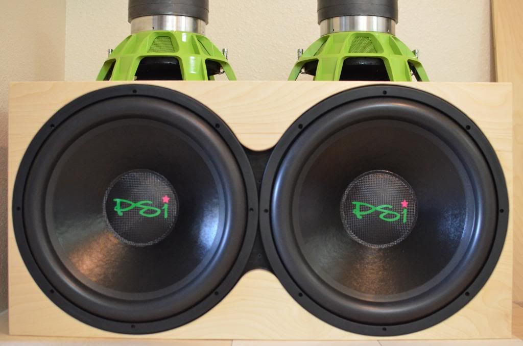

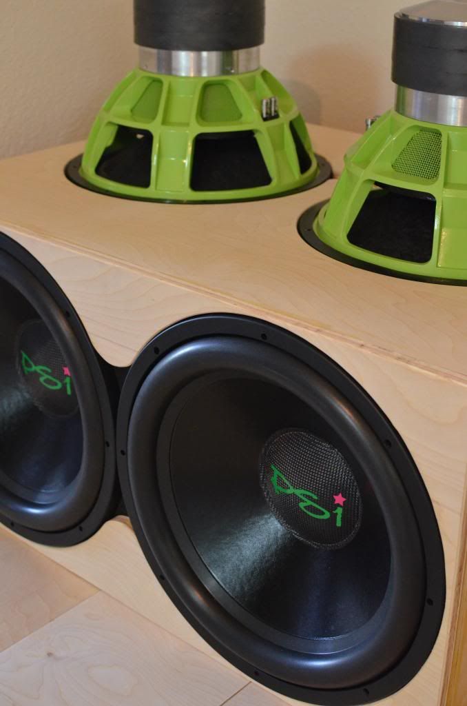

Got the two baffles cut and routed with a 1/8" roundover:
I'm kinda stuck and need help. Don't know what order to stain the two baffles, glue them on, and carpet the rest of the box in. I am thinking glue them on, hit all edges with a flush trim bit, stain them, tape them off well, and then carpet the rest of the box. Anyone have any ideas?

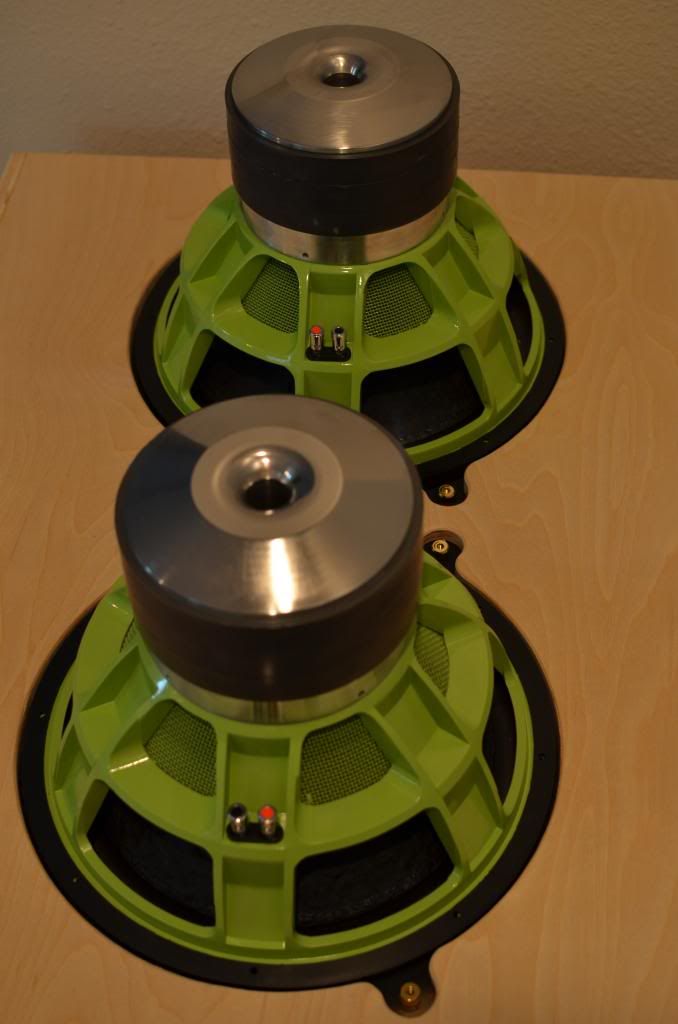

More work on muh box. Here it is being glued down, and I also added screws from the inside:
Next day:

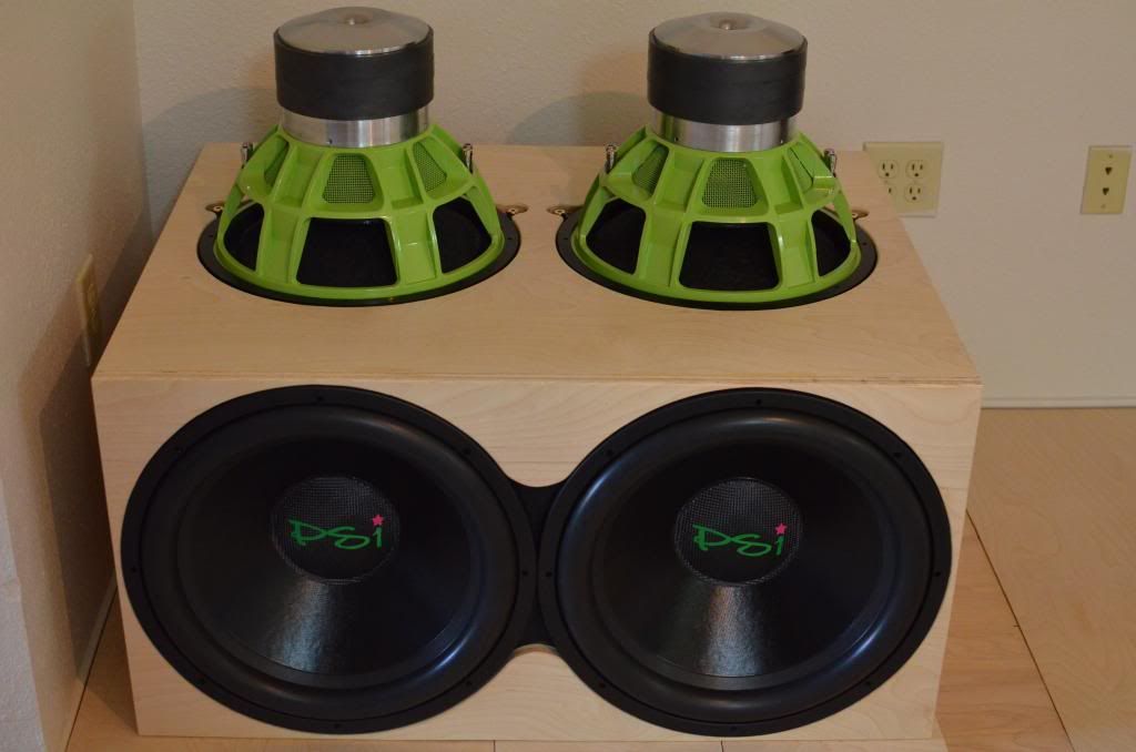

Final mockup before stain and carpet. And of course, I had to snap a few extra pics //content.invisioncic.com/y282845/emoticons/smile.gif.1ebc41e1811405b213edfc4622c41e27.gif
//content.invisioncic.com/y282845/emoticons/biggrin.gif.d71a5d36fcbab170f2364c9f2e3946cb.gif
Edit: WOW, horrible picture. Don't worry, more to come after polyurethane //content.invisioncic.com/y282845/emoticons/wink.gif.608e3ea05f1a9f98611af0861652f8fb.gif

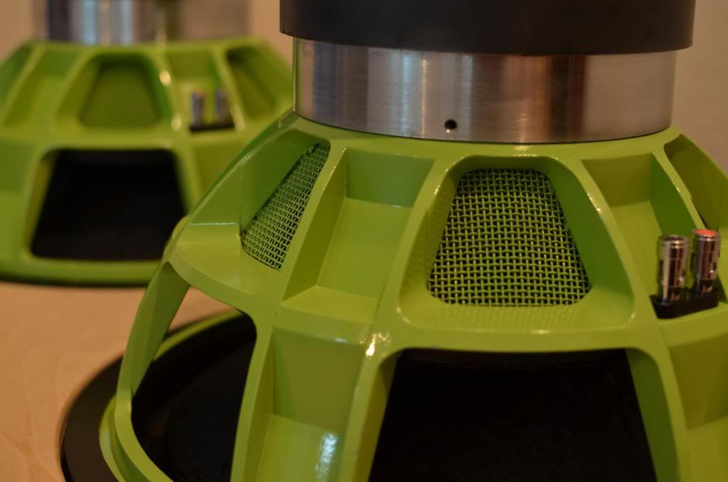

You're doing the wood work / cutting in your apartment? Everything looks good. Those subs look so ****. Maybe re-finish the rubber on the magnets so they're nice and black.
Yep, everything in my apartment. Well, cut most of the wood out on the porch. And there's no boot on the magnets, that's a bare ass //content.invisioncic.com/y282845/emoticons/biggrin.gif.d71a5d36fcbab170f2364c9f2e3946cb.gif

What is the gross volume of your box?
Really? How did you learn the fiberglassing?I am seriously impressed. You've learned more than I have that is for sure.
I want to do a Passive radiator set up too. But don't have the $ yet. But I do want to try it.
Fiberglass I just did. It takes some practice lol. That was my first time and it didn't turn out that great. My box is right around 8.5 cubes. I don't remember the exact number.
