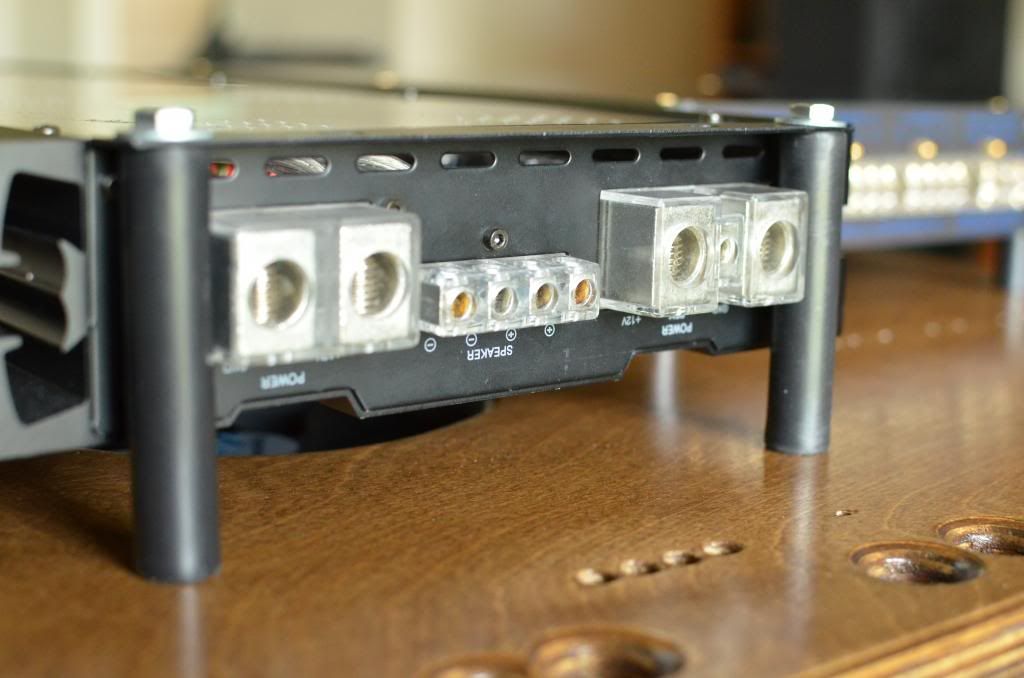

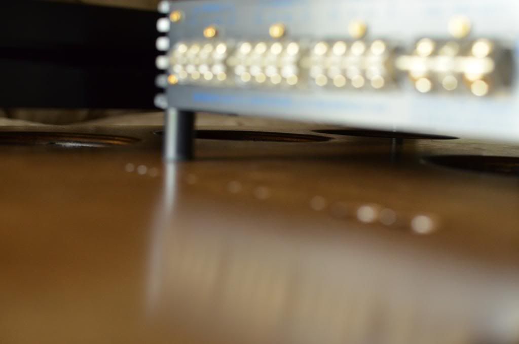

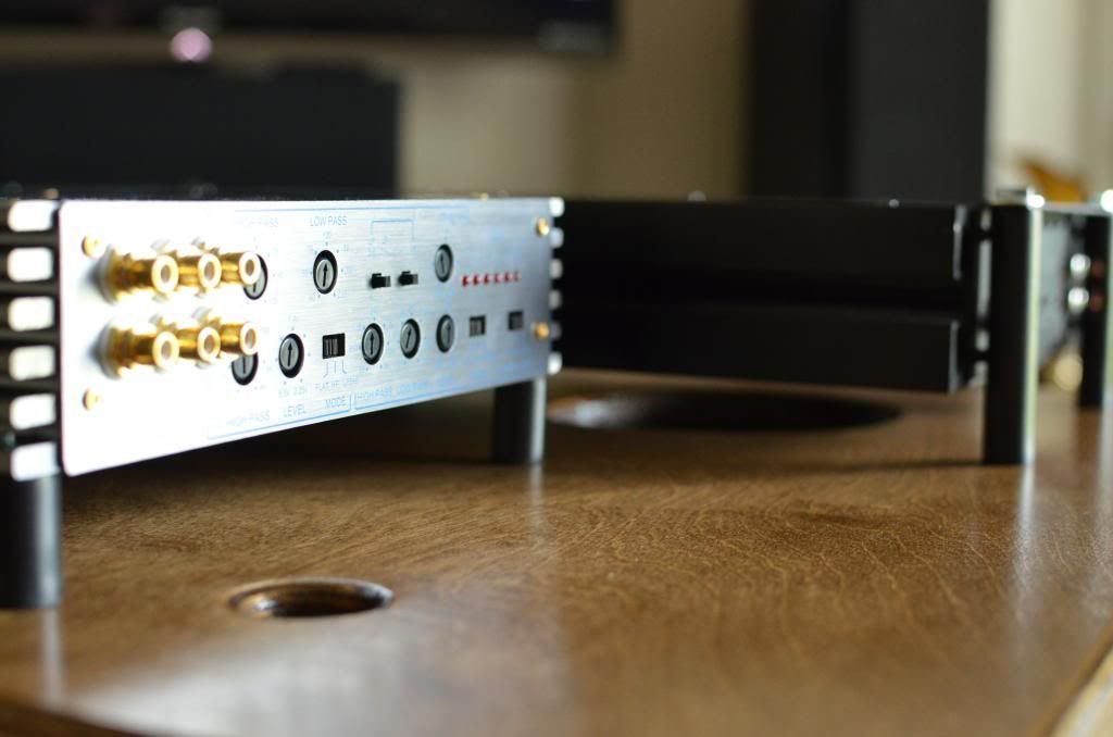

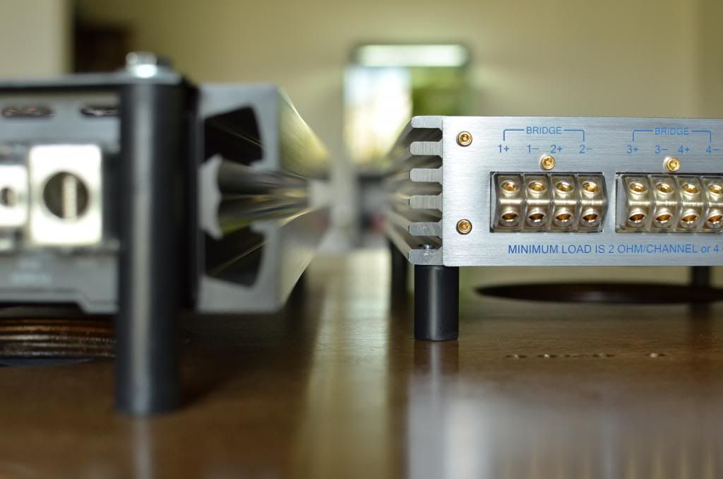

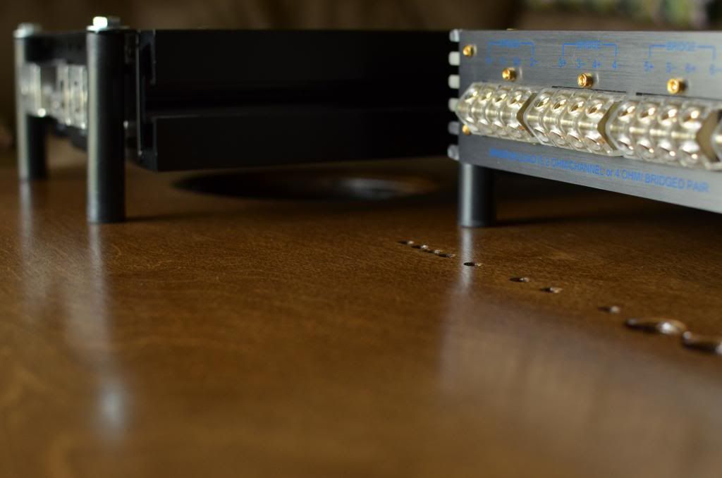

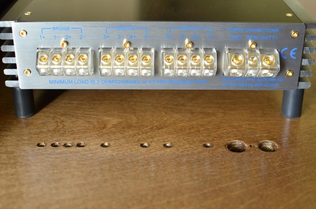

Also figured out the possible amp stand-off problem. I was apprehensive about using the plastic pieces, but I liked the look of them, so I snagged some brass pipe and cut it to fit inside, pounded it in, and voila, no more problems. @keep_hope_alive and @audiobaun led me to this.

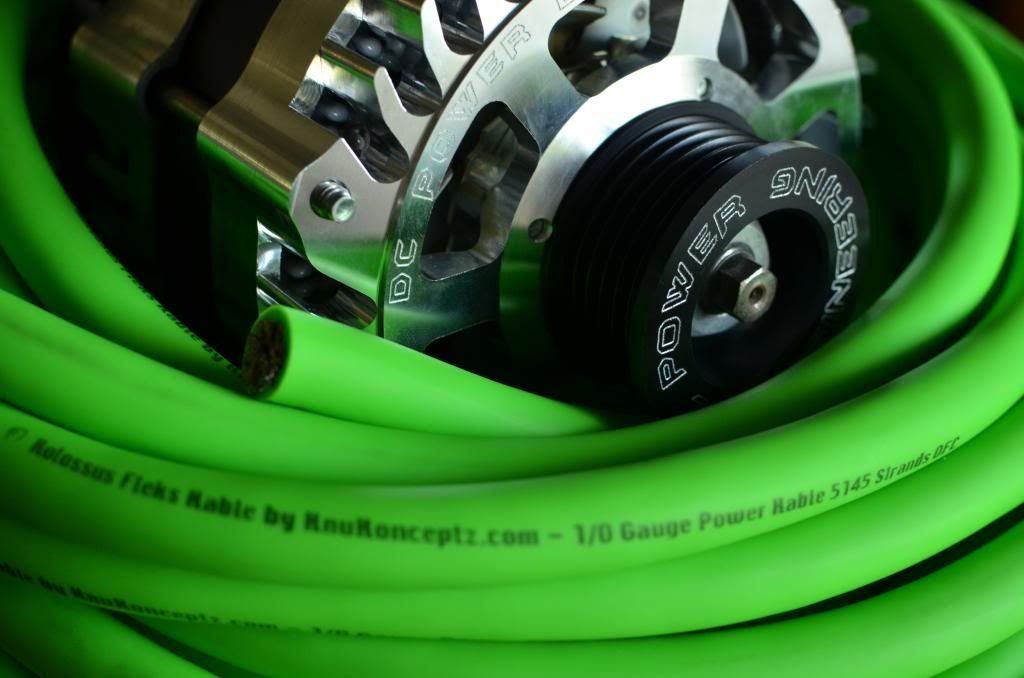

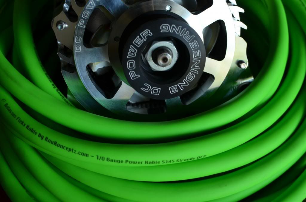

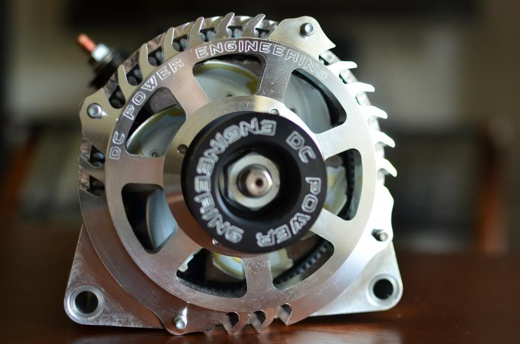

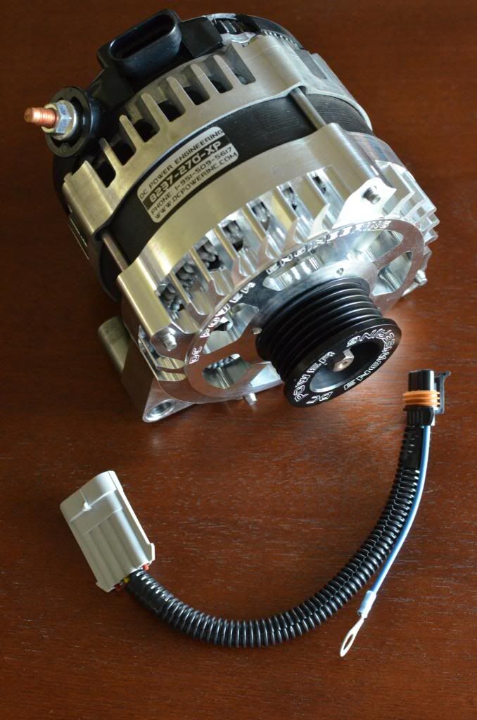

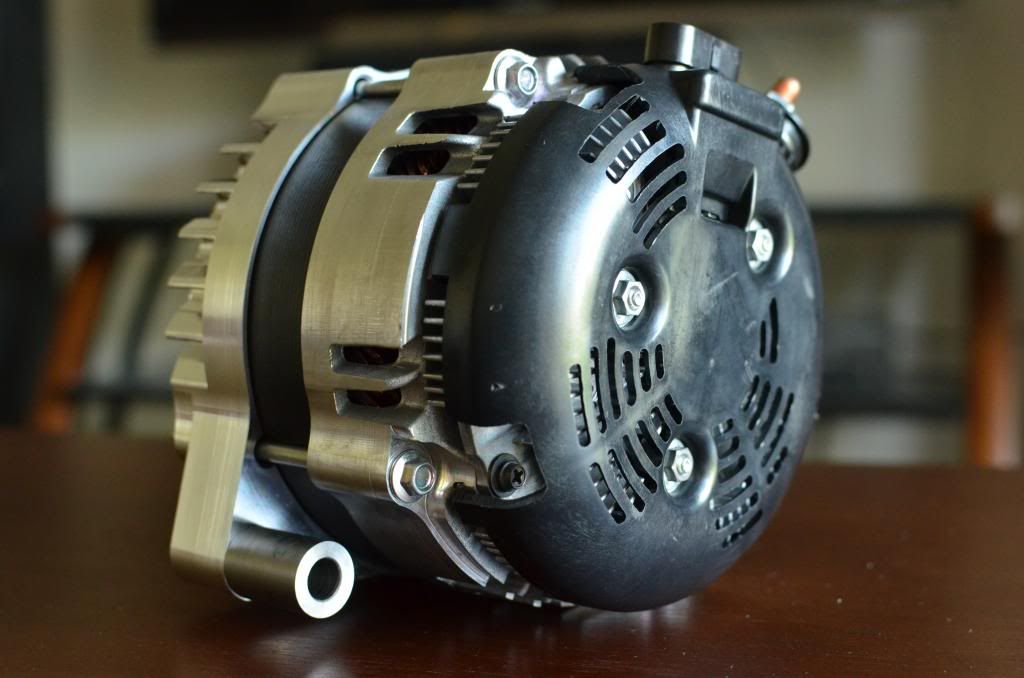

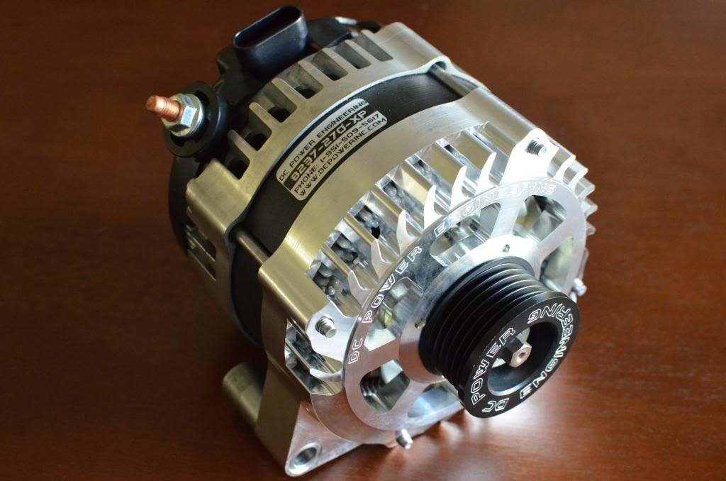

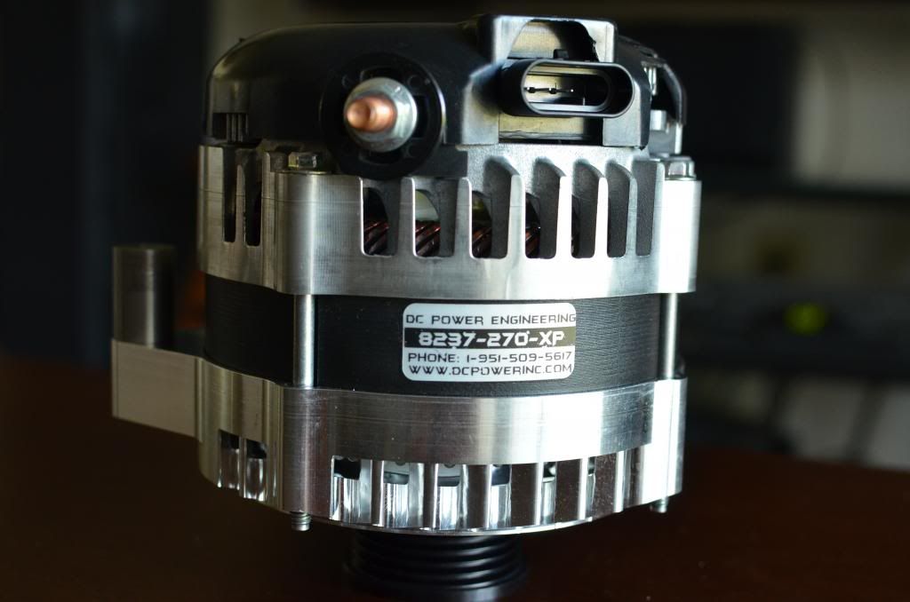

Got my alternator back from DC Power today. I had this alt on my last car, and I sent it back to them to get recased for this vehicle. They recase for $150 (I got a bit cheaper, they do military discounts //content.invisioncic.com/y282845/emoticons/biggrin.gif.d71a5d36fcbab170f2364c9f2e3946cb.gif). My, and others, only complaint about DC was the wait times. Well, I got this done really quick. I shipped it to them, and they received it on the 25th. They called me on Monday, the 1st, and told me it was ready. I paid, and they shipped and I got tracking that night. Received it tonight, the 5th. So either this was fast because it was only a recase, and it does actually take the couple months people normally wait to build a whole new one, or they have finally caught up on orders. Either way I'm happy. Now for pics!
