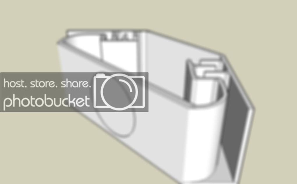

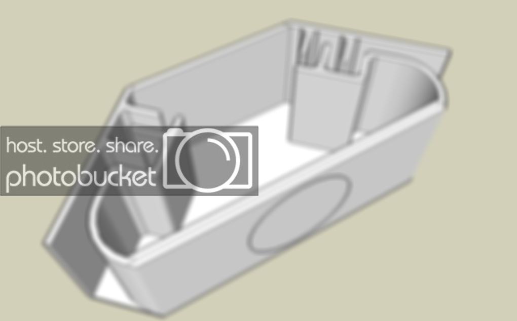

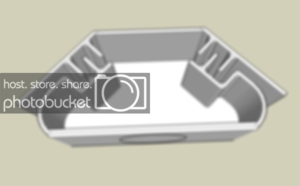

But here they are..
dont feel like finding where I orginally posted it //content.invisioncic.com/y282845/emoticons/smile.gif.1ebc41e1811405b213edfc4622c41e27.gif

Uhh?
And... "HOLY NEGATIVE VELOCITY, BATMAN!"
Might sound good... but the output would be lowered due to those really small and cramped folded ports... I'd separate the ports a little bit more. Also, with the ports like that, might cause some turbulent air. But since it's a HT app, you might not hear it.
Can you send me the Sketch-up file of that?
I'd have it straight back and folded back on the left where Rash put the U shaped-thingy-ma-bob.
Uhh?
I'm sure he knows all this and is just being complicated for the fun of it //content.invisioncic.com/y282845/emoticons/wink.gif.608e3ea05f1a9f98611af0861652f8fb.gif
Haha, yea...I could have easily done a pretty straight-shot and a simple bend-back of the ports...but this was just me being bored one night...I honestly have a much simpler plan than these for one of my 15's for HT //content.invisioncic.com/y282845/emoticons/biggrin.gif.d71a5d36fcbab170f2364c9f2e3946cb.gif
you do reaslize that every corner in the port will add resistance....
if you use the standard port length with all those corners your tuning will drasticaly drop
not to mention the port noise that will probably be generated
for example.......adding a 90* corner to a 4" pipe is like adding 10ft of strait pipe
I used to make alot of labarynth ports that had the same problem..they end up hitting
much lower than attended
very cool scetch up though
Thanks //content.invisioncic.com/y282845/emoticons/smile.gif.1ebc41e1811405b213edfc4622c41e27.gif...and yea, I cut down the turns on a couple newer designs for this...I could see it becoming a problem //content.invisioncic.com/y282845/emoticons/crap.gif.7f4dd41e3e9b23fbd170a1ee6f65cecc.gif..not to mention the construction being very tedious (sp?) and time consuming //content.invisioncic.com/y282845/emoticons/frown.gif.a3531fa0534503350665a1e957861287.gif
