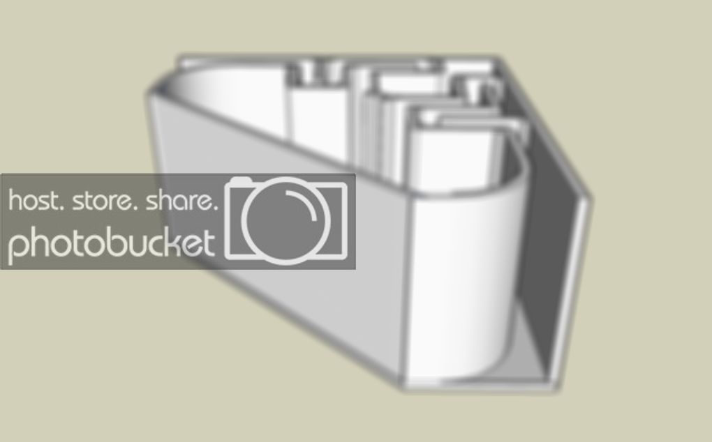

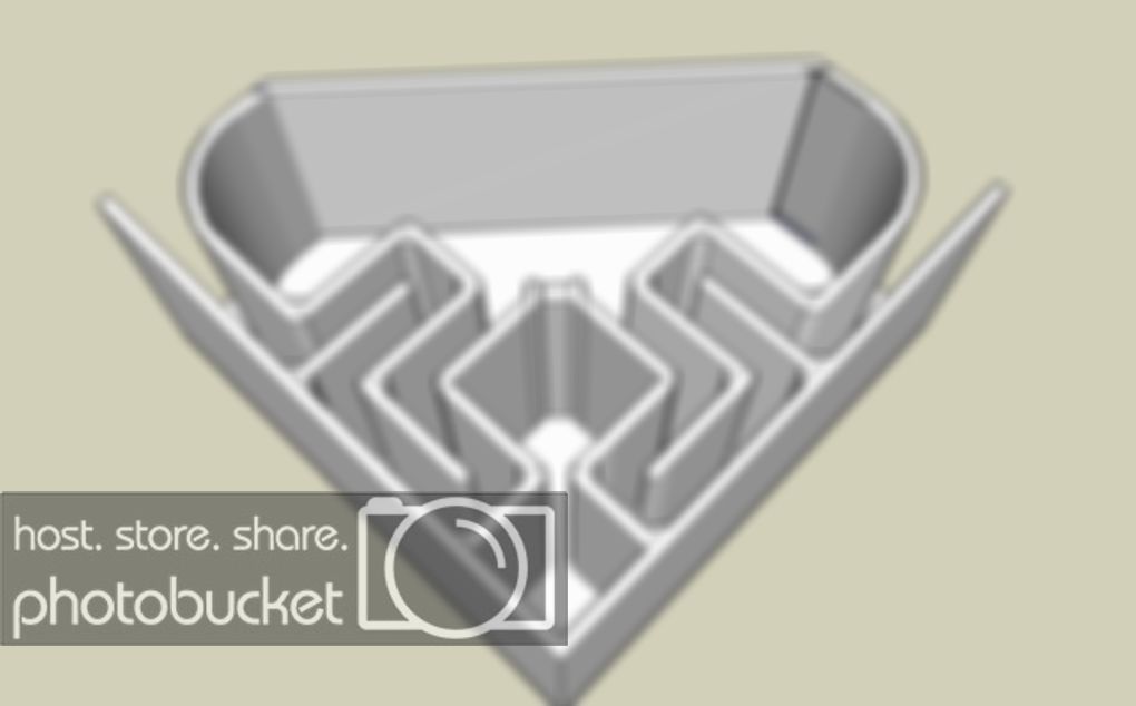

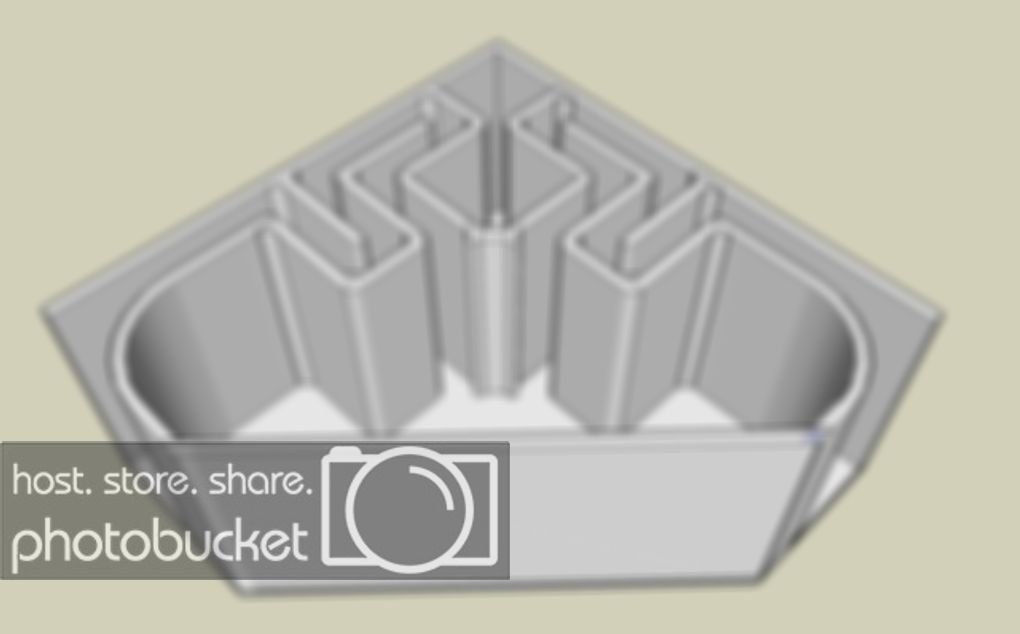

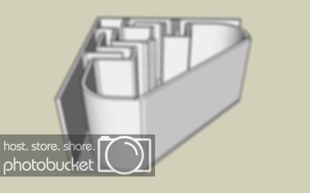

Hey guys,
Just posting up some plans for my enclosure build for the 15" TC-3000 on it's way //content.invisioncic.com/y282845/emoticons/wink.gif.608e3ea05f1a9f98611af0861652f8fb.gif
It will be 4.19 cubes, tuned to 26Hz, and 64 sq inches of port area //content.invisioncic.com/y282845/emoticons/biggrin.gif.d71a5d36fcbab170f2364c9f2e3946cb.gif
Here she is..
Im hoping to start this in the near future but I don't think it's going to be the quickest build in the world //content.invisioncic.com/y282845/emoticons/frown.gif.a3531fa0534503350665a1e957861287.gif
how the hell do you calculate that internal volume of something like that!?
Using sketch up //content.invisioncic.com/y282845/emoticons/tongue.gif.6130eb82179565f6db8d26d6001dcd24.gif you just highlight the area that the port doesn't cover and then multiply that by the height and you get the airspace left for the submoofer //content.invisioncic.com/y282845/emoticons/biggrin.gif.d71a5d36fcbab170f2364c9f2e3946cb.gif
HOLY ****ING ***** SHIT MONKEY *** BALL ****!
That Should either Pound or Fail horribly.
Ro Mry Grawd //content.invisioncic.com/y282845/emoticons/crazy.gif.c13912c32de98515d3142759a824dae7.gif//content.invisioncic.com/y282845/emoticons/biggrin.gif.d71a5d36fcbab170f2364c9f2e3946cb.gif
And I forgot to mention the front face will have another layer outside of that to countersink the sub //content.invisioncic.com/y282845/emoticons/smile.gif.1ebc41e1811405b213edfc4622c41e27.gif
I can't imagine its necessary for you to have made it so complicated, there are empty spaces, why?
imo you'd be better off redesigning the port more properly/linearly, though it does look crazy
Because //content.invisioncic.com/y282845/emoticons/smile.gif.1ebc41e1811405b213edfc4622c41e27.gif And if I were to fill the empty spaces with the port and redesign it the airspace would increase and Id really like to keep it at around 4 cubes for the sub...
