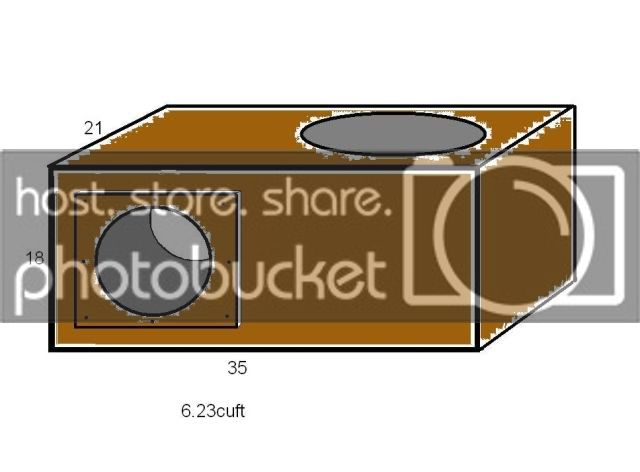

so this is the box that i came up with,those are the max dimensions that i have,
plan to do 4.8cuft 32hz
with a remobable pvc tube 8" x 15" its 36hz and with a 6" x 11" i get 32hz
do you guys think i can get away with the 6"one keeping in mind its a street box 3000 RMS
I would rather rock a 6'' PSP instead of a stock 8'' pipe. Will look 50x better too. I think it would be hard to tell the difference between the two soundwise.
