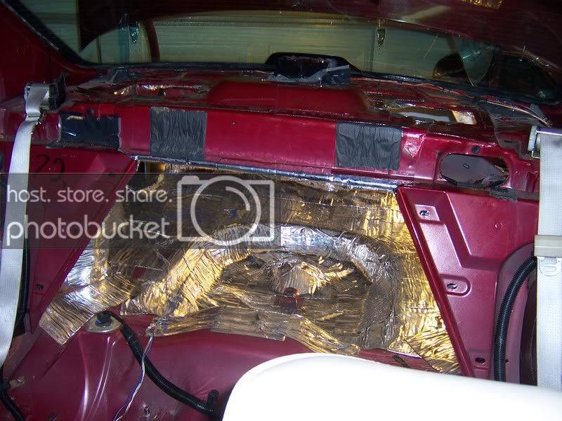

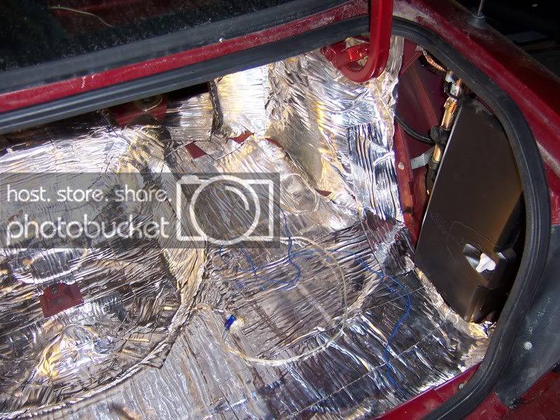

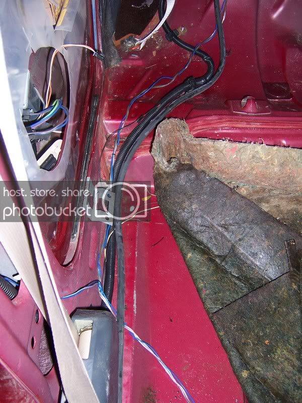

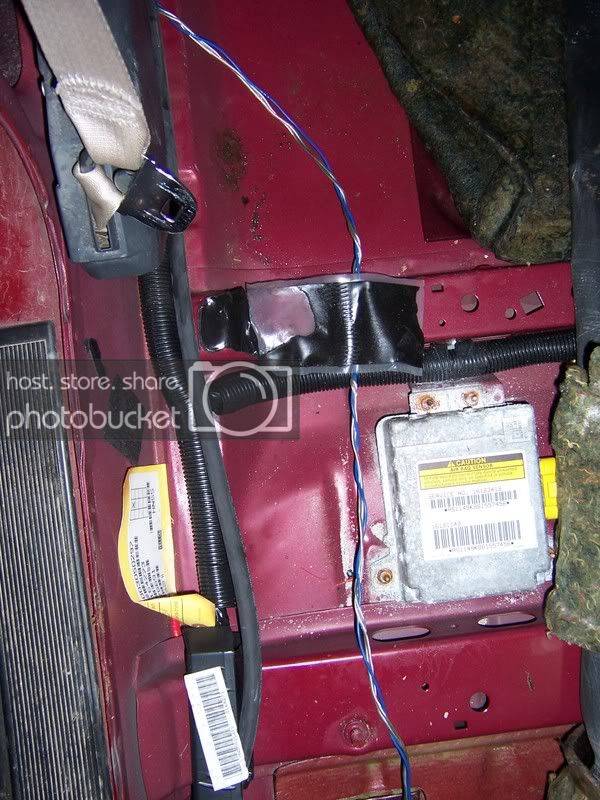

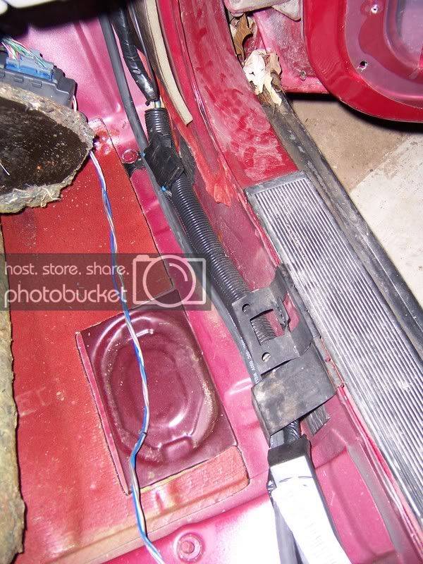

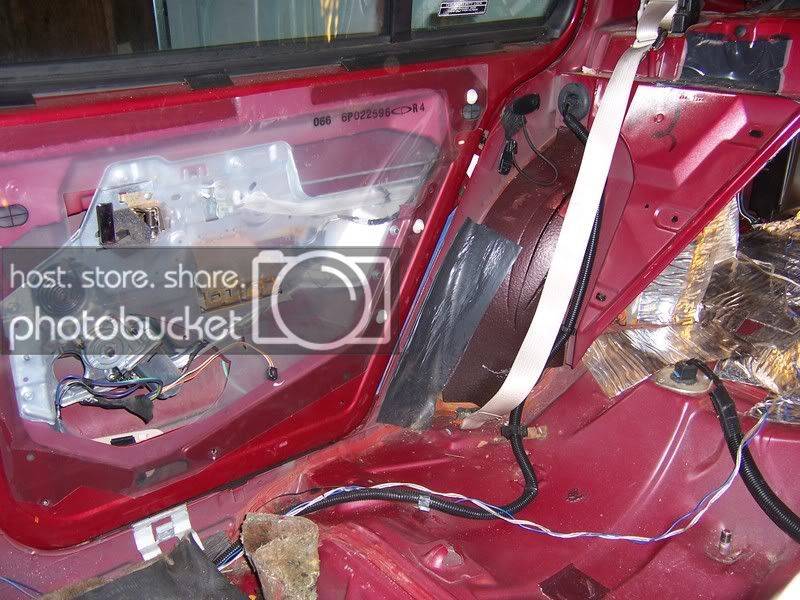

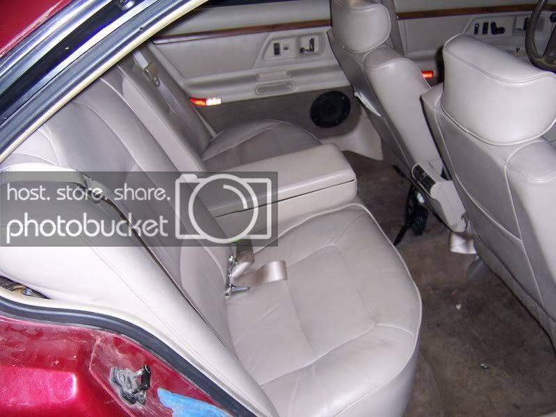

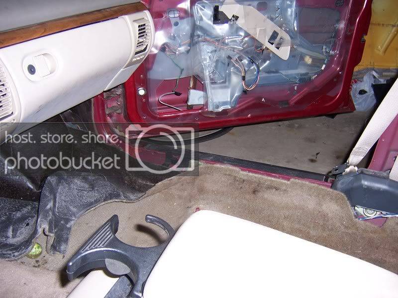

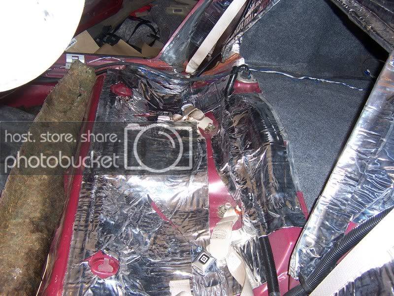

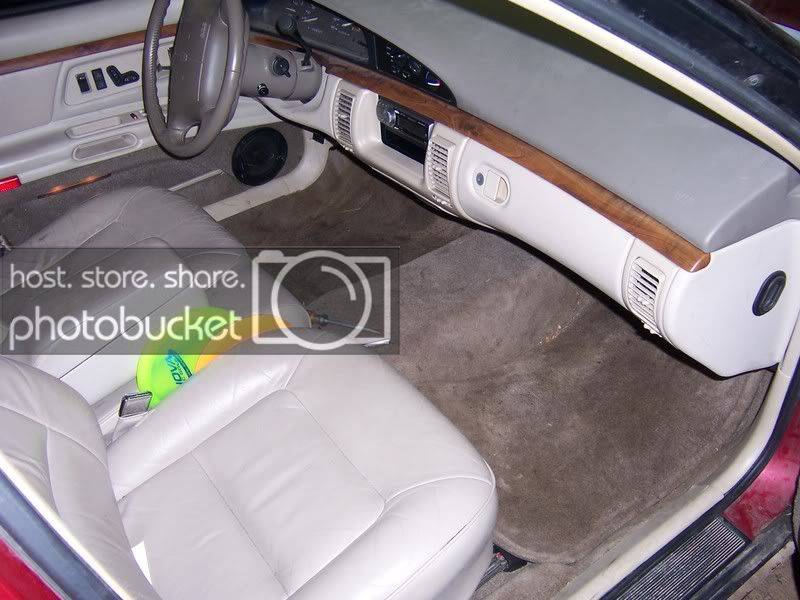

Well I finally decided to upload the pics from a little build I did in my buddies oldsmobile. I forgot to snap pics of the headunit, and the sub installed in the box with the amp but Ive got some pics of a little wiring and all the deadner.

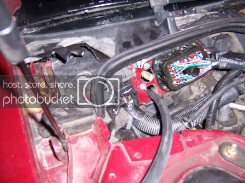

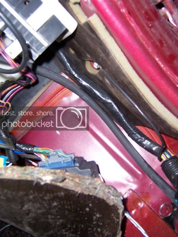

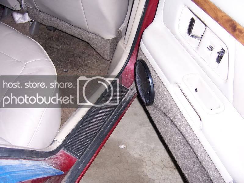

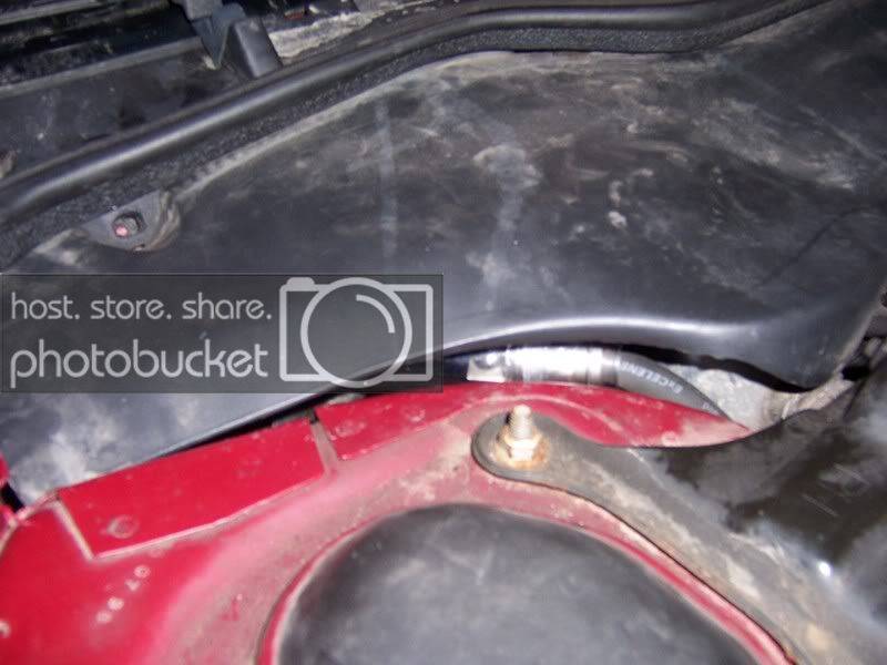

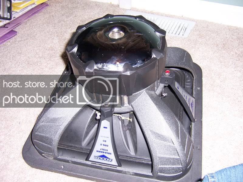

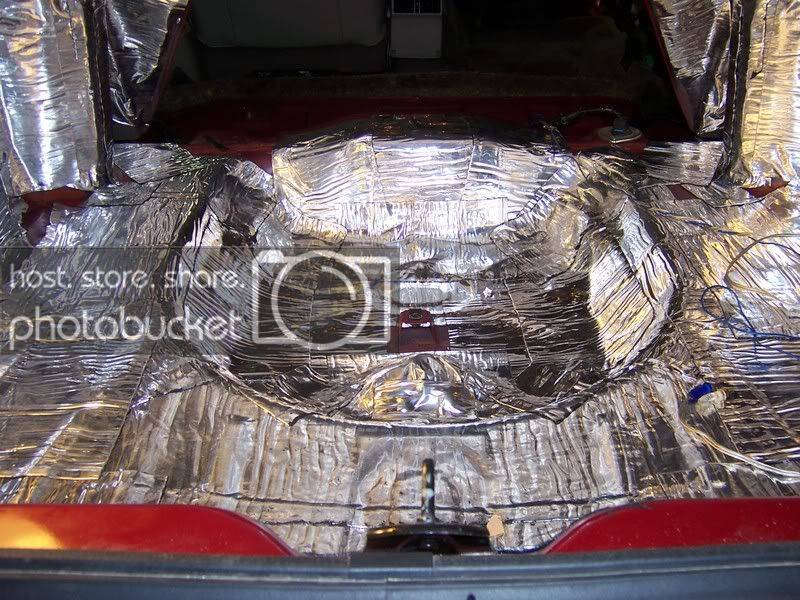

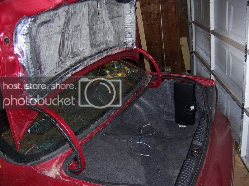

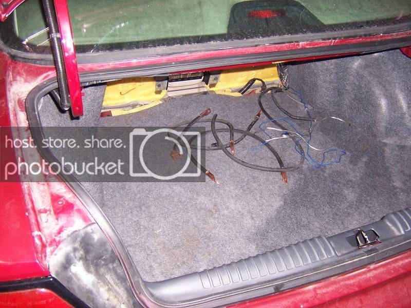

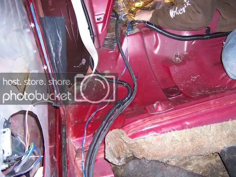

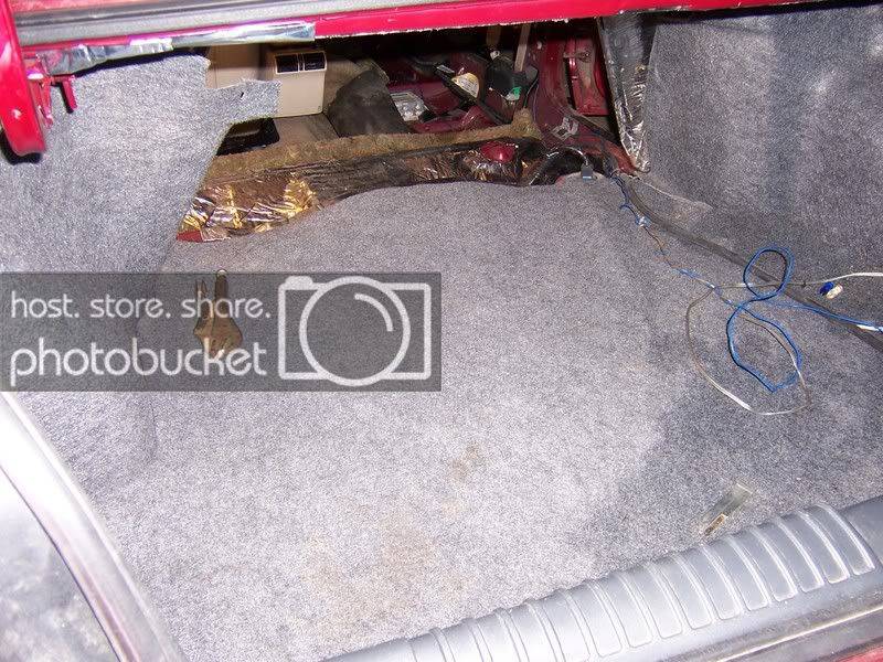

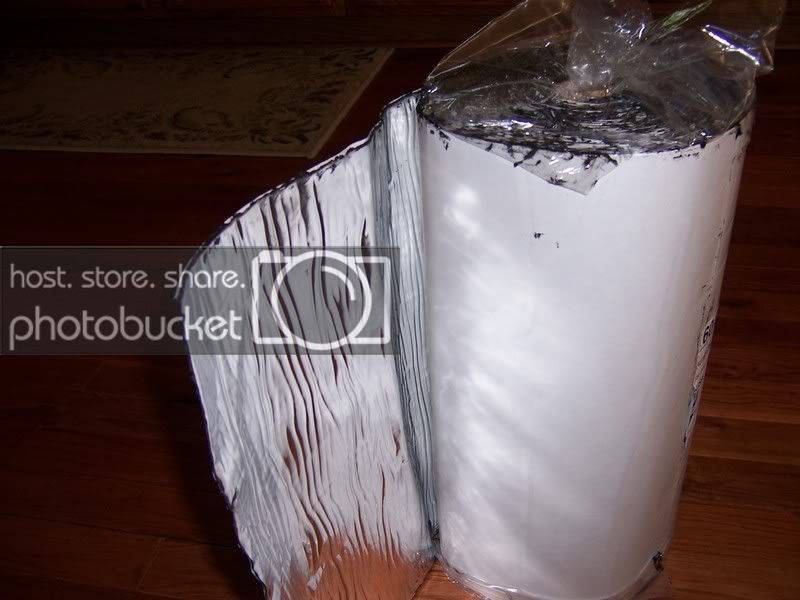

The system consists of a pioneer hu, with 6.5 pioneers in the doors. 125 sq ft of Raamat(great stuff), 50ft of 1/0 from welding supply, big 3 and two runs to the back, and a 15"L7 off a HCCA-2400. Sounds fantastic, I am very impressed with the sq of the L7, couldnt believe it. It has a very potent low-end as well. Were gonna play around with a couple more boxes to try and get it fine-tuned to his liking but it would be perfect if it were mine. The lows are great and it still maintains the upper end very well. If I remember the box I made was around ~4.3 cube tuned to 33hz. Ill get some pics of the trunk and a couple vids in the next day or two whenever I meet up with him. But on to the pics......

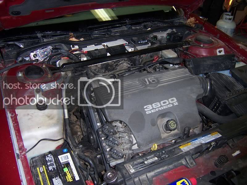

I need to get under the hood pics too, the big 3 turned out awesome, as well as all the wiring on the batt, we pretty much set this all up to add another HCCA-2400 and L7 //content.invisioncic.com/y282845/emoticons/biggrin.gif.d71a5d36fcbab170f2364c9f2e3946cb.gif

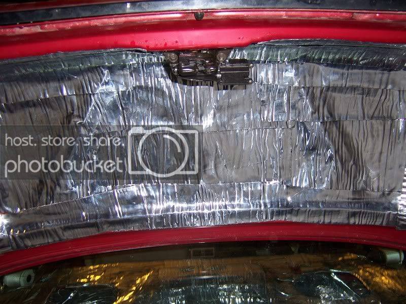

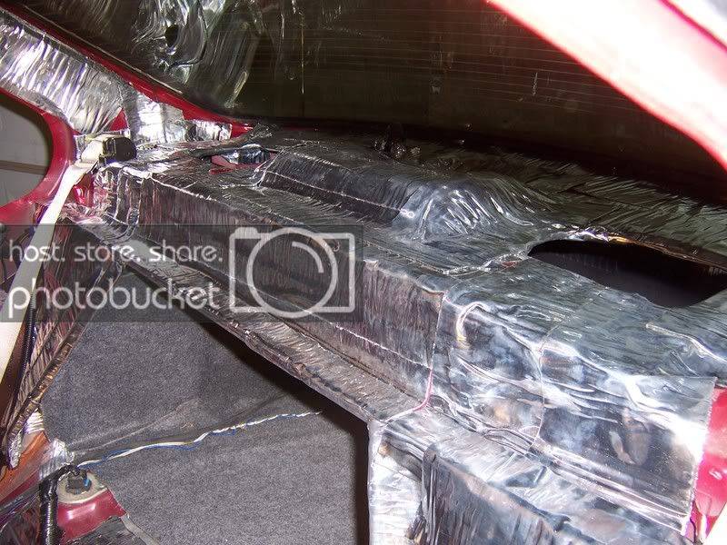

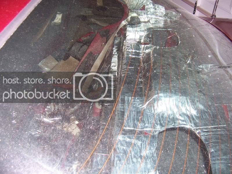

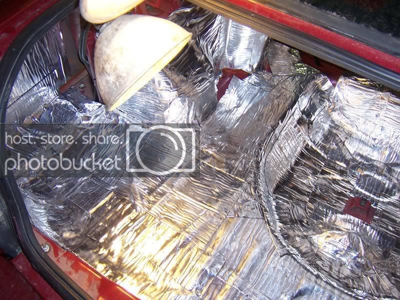

BTW the deadner was such an awesome investment for him. We did the whole back half of the car, and have a little left over, I did a couple strips behind a trim piece on the trunk and the license plate, NO RATTLES AT ALL, NONE! Sounds great even from outside, well, you can barely even hear it from outside, unless the windows are down.
Definately recommend it to all noobs with terrible rattles, good investment for $235
Did pretty much just one layer, but I doubled up in the spots that needed it. Ill get vids as soon as I can, this thing sounds insane from the outside. You literally cant even tell theres a sub in it with the windows up. Other than the trunk and rear bumper flexing all over the place lol
nice.....FYI, just helped a buddy put in a new motor this weeknd, JUST like yours....what a pain !!!!!!!!!!!!!!!!!
lol, thankfully he shouldnt need a new motor anytime soon, I think his car only has around 50,000 miles on it, maybe less. He should definately get his use out all the deadner:D
