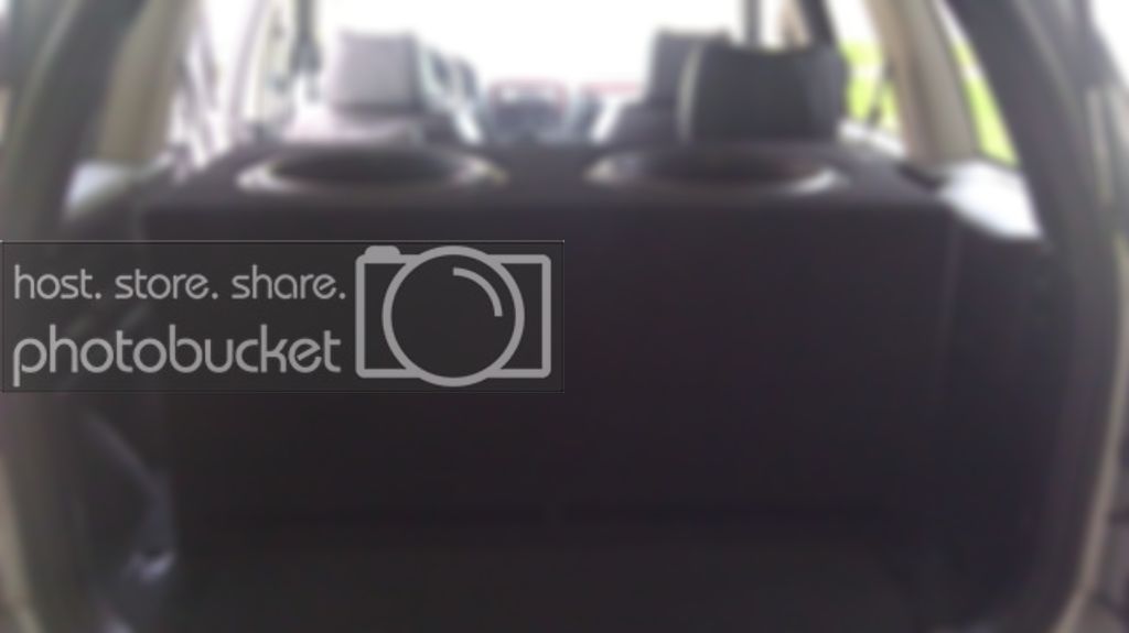

pics of current setup

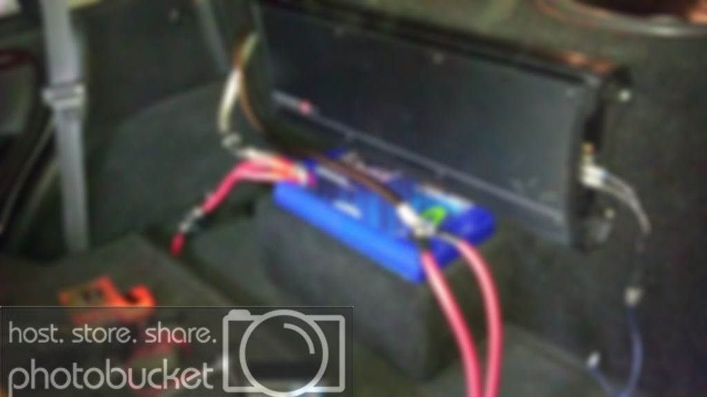

kind of a bad pic, you can see the skinny ports at the bottom though

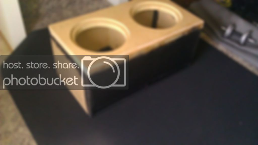

pretty good shot of the box construction, I can link you in to my complete build log if you want.
IMO you're not going to have 150 with that power and cone area unles you tune 45hz and up. Also odds are you haven't found your peak frequency (should be in the neighborhood of 55hz) which is what kills most novice competitors on the meter.
Fact is, if it sounds good it is good. Can you get more out of it? ALWAYS! but you will need to make some sawdust and start cranking out some new boxes to chase that.

I have heard that what sounds good to your ear does not sound good on the meter, and vice-versa. I am really more concerned with the musical side of things compared to just metering high numbers. But I would also like to be as loud as I can while still maintaining the fairly musical abilities of the box/subs.

I suspect you have a 42 in that anyway if you do some testing (find your peak frequency, moving seats around, closing vents, etc.). Also not knowing how that amp is hooked up you may be only seeing a few hundred watts out of it anyway at peak. I can gain big by dropping impedence for burps, but that doesn't translate well into everyday music listening.

What do you mean by I may only be seeing a few hundred watts? are you just refering to the impendence rise caused by the box?
