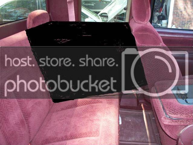

Here is a picture of what kind of enclosure I am looking at making:
That is about 2ft^2. Would it be better to make it upfiring or make it not so close to the drivers seat and fire towards it? Also, will it matter where I put the port? I will not be making the box but I wanted to know so I could kinda tell the guy. I havent talked to him yet. I would appreciate any help. Thanks
^^wow you're going to sit the box on your seat like that????
Stay away from Elememtal Designs, what did you say your budget was??
you know your car has a really big cabin??
why not make a box & figue out a way to put the sub under that seat, driving around with a box that big behind you isnt the ideal in the world.
some one can steal it or have you thought about if you got into a really bad accident it could kill you.

If I were in your shoes, I'd go for the Pioneer over the eD. The group may not agree, but I'd make a box of similar shape to your design. Sub would be up-firing, and back by the headrest. The slot port would be S-shaped, and snakes into the foot-well, firing towards the passenger side.
Pioneer's recommended box size is 1.2 cubic feet, tuned down to 40-42 Hz-ish, but tuning lower can give you a bit more rumble. I'd do 2"x8" port, 15" long.
Since it's a relatively small air volume in your truck, and the sub is near your head... be sure to design your box not to get boomy. The port area needs to be small-ish, and you want to add some stuffing on the walls of the box. Boomy truck boxes get annoying (to me atleast).
You'd still have room for 1.5 passengers in the back... and can be easily removed for more cargo/people. Just my 2 cents.
Unless you are going for SQ a single 2ft3 ported sitting in the seat ,ain't going to do much and you probably aren't going to be very happy with it anyway , and if you fire the port and sub upward it is going to rattle the s!@t out of that thin back wall and glass, if you have to use the seat, do a single 15" with the sub and port firing forward ,with the port located up high or in between the buckets and fab brackets to bolt the enclosure to the back wall, for safty concerns, and either way tint your windows and invest in a black sheet to cover when not in use and a good alarm is always a good idea.
but I vote removing the seat if possible.
