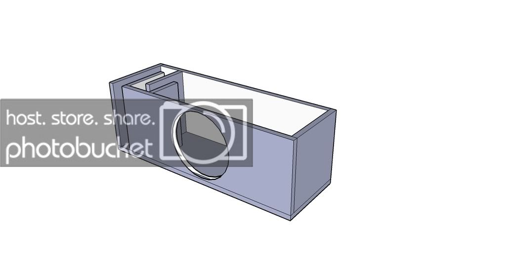

Would this box be alright? I'm pretty sure it is, just getting some opinion before I build it. Dimensions are 31.75X11.25x10.5 with ~1.4 ft^3 of volume and 30.5 inches of port tuned to 33 hz.

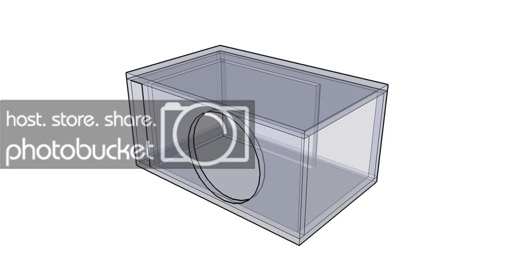

I had my 2-10" Type Rs in a 2.15 cu ft box (after displacement) tuned to 35 hz...I thought it needed a bit more of the lowend stuff

1.4 before sub displacement?
if so, I think you will be fine. If you want lower bass and want the sub to be more efficient you can make the box bigger...but it will probably get a bit boomy.
