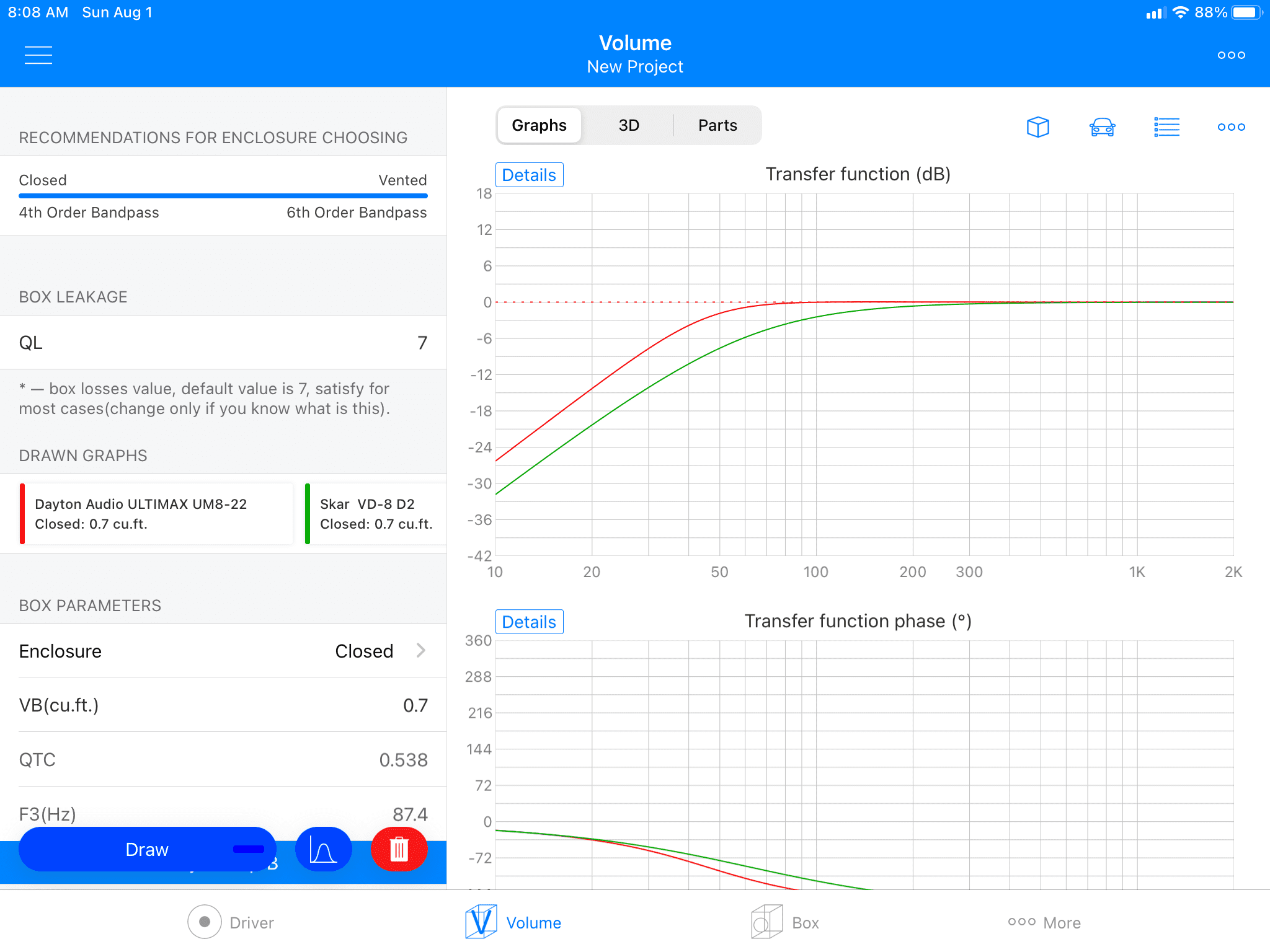

I’ve done a ton of comparisons on 8 inch subs. I specifically modeled the Dayton ultimax and the skar vd against each other in real life and in simulation. Here was my sealed box graphs when I built the box. I had the Dayton in .7 cubes with a little less than 1 pound of polyfill in the box. It rocked for a little 8. The Skar, not so much. Here is the graph I saved.

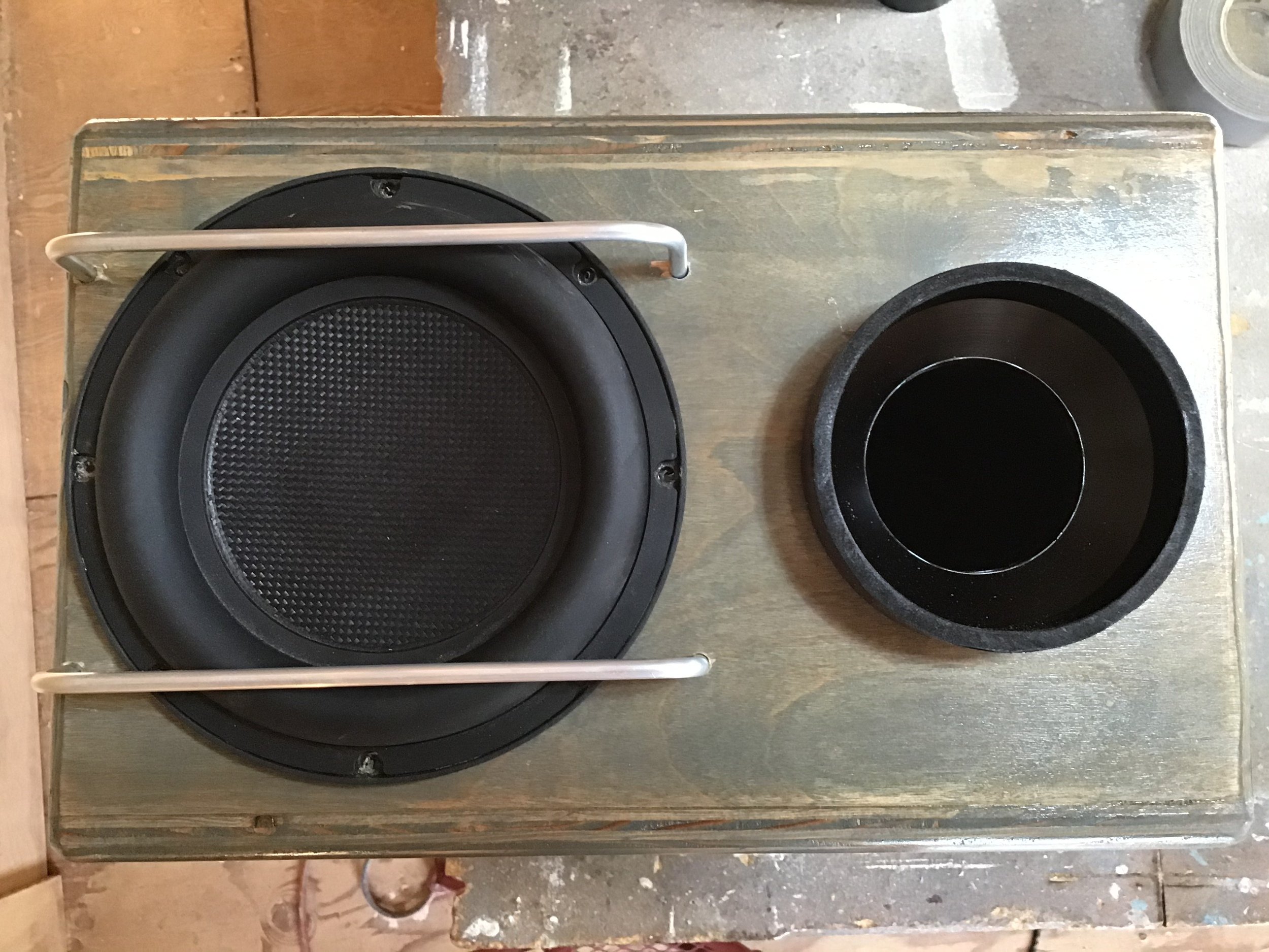

I blew my little Dayton unfortunately being an idiot and over driving it in a ported enclosure, which it is absolutely not meant to be in technically. The skar is more of a ported box 8 , so it doesn’t do very well sealed. Here is the Dayton in a ported box before I burned it up. My plan is to run 4 Dayton ultimax 8s sealed in .7 cubes per sub with a few pounds of polyfill. It’s a far better sub than Skar if you’re not an idiot like me and run it on 1200 watts before really tuning the DSP. I’m still sick about it. Lol
Four of these 8’s sealed has got me curious
