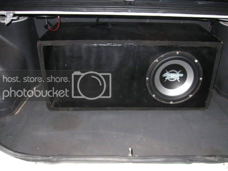

What kind of trunk dimensions do you have to work with?
this box is about 32" long ,14" deep, and 14" tall. its a pretty big trunk.
