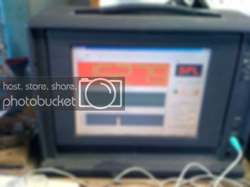

Ok now for some numbers. The entire goal from the beginning was to have a 149-150db capable music vehicle and we met that goal. Even though Jordan will rarely listen to it that loud for extended periods of time he wanted to be able to listen to around 145-146db with out stressing subs or equipment and this set up is perfect for that.
Port ended up being best tuned at around 10" over all length.
Here is the spl from 40-48hz with the tuned port.
40hz 149.0db
43hz 149.5db
44hz 150.0db
45hz 149.9db
46hz 149.7db
47hz 149.3db
50hz 148.0db
60hz 143db but xover on at 63hz
So right where we wanted it tuned at for the type of music Jordan listens to. And still plays over a 148db in the 35-40hz range for when he plays some rap and what not. Nice and tight clean and loud.

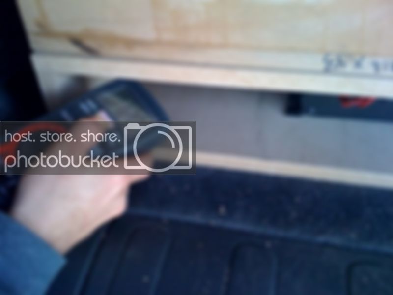

Here is power results but again with stock alternator voltage was anywhere from 11.5-11.8v at the back battery and .5v higher at the front battery
44hz 111.4v and 27amps @ 4.12ohms=3008w voltage 11.5v at the back battery. Not bad considering rating is 2800w at 4ohms at 12.6v.
So as you can see voltage was killing power again due to stock alternator. And I think there was a post on here from an owner of an xterra that said the stock alternator is weak which I agree. Easy 500-1000w gain with alternator. And I'm honestly not to sure about how strong the Kinetik's are.
