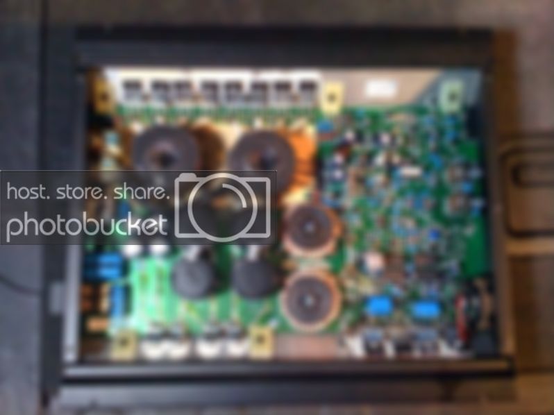

I can't get over how tiny that amp is for the power it puts out.
Yes they are little monsters. Low amperage and high voltage power. //content.invisioncic.com/y282845/emoticons/smile.gif.1ebc41e1811405b213edfc4622c41e27.gif I had my friend listen to another build I helped with two 12's powered by a 4k2d music 149db and he was sold.
