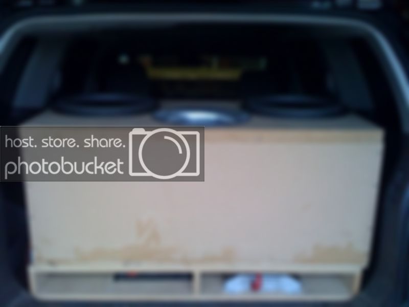

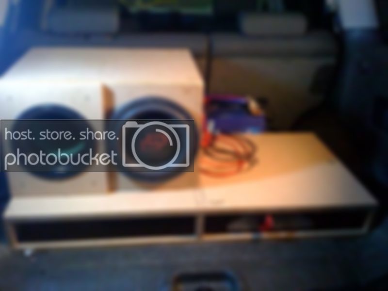

I would think it would meter / sound better firing the port back. Either way good work. I would love to get a listen sometime. I have not had bass for over a year.//content.invisioncic.com/y282845/emoticons/crap.gif.7f4dd41e3e9b23fbd170a1ee6f65cecc.gif
It's a little bit of a misconception about firing back sounding better. In general yes it'll tune lower and load port more depending on vehicle. It's all abut the way you tune port and box. When firing port back you lengthen the wave which depending on how you have the box tuned it'll sometimes will be louder and tune lower then flipping the box forward or up. To compensate when firing up or forward you just need to have the port longer and possibly the box a little bigger depending on how low you want to tune the box.
In this application since we where short on space and I didn't want to destroy his hatch I opted to fire it up. It does two things, it won't rattle the hell out to the hatch compared to firing it back and possibly in this application be louder. I've done firing up and forward and it can sound very good and loud.

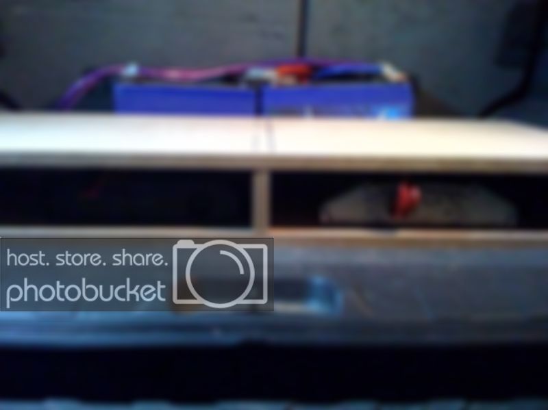

Amp rack and testing amp with DD 9510.
So I am the one with the Xterra and building the car. Jeff has been helping the entire way with the design and planning.

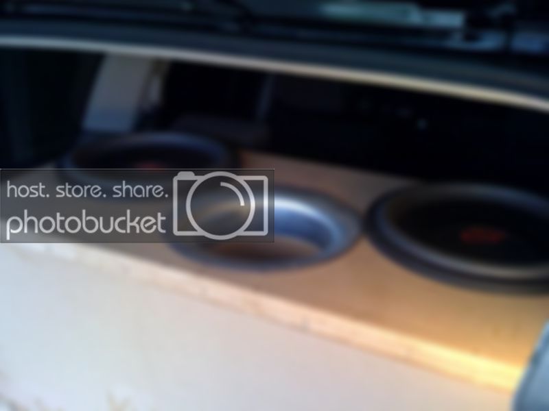

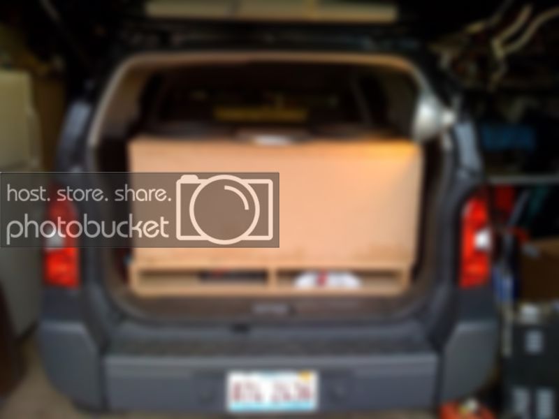

is that box going to smash through that amp rack lift? lol it has to weigh at least 100+ lbs.
The sub box weighs about 210 pounds. The amp rack is supported in the middle and sides. Also built from 3/4 inch mdf. The rack doesnt even budge, and the box is secured to the amp rack from the inside the box to prevent sliding or rattle. So far so good.

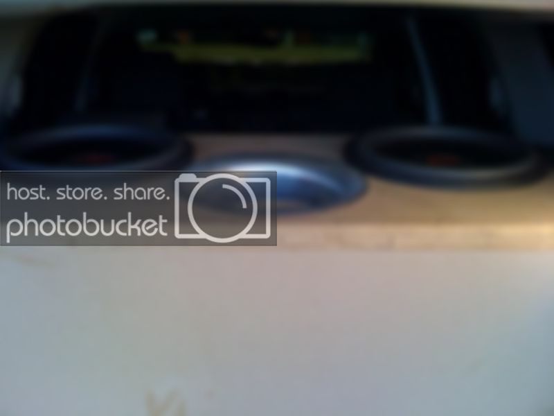

How 'bout now?
Currently it is untuned, we are doing that tomorrow with the power tests, and it is already awesome. Can't believe how loud it is with that Stetsom amp.
