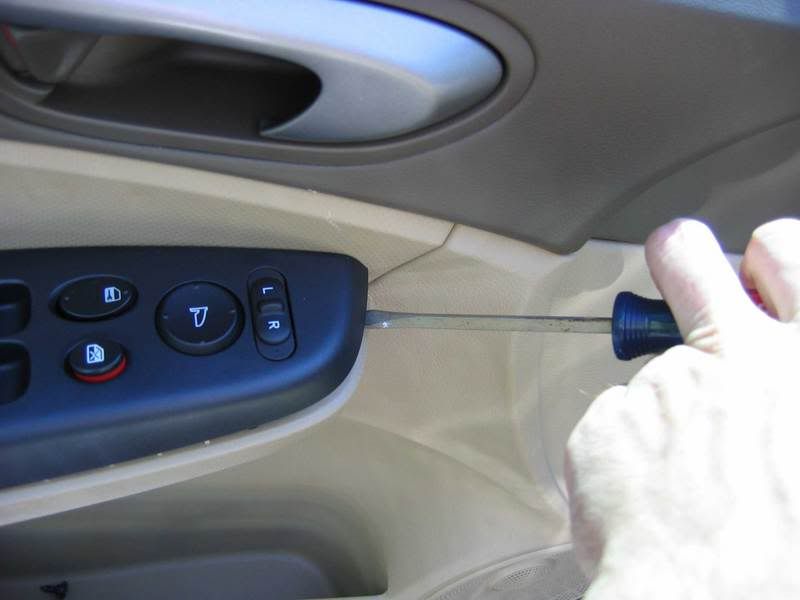

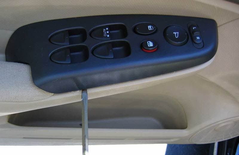

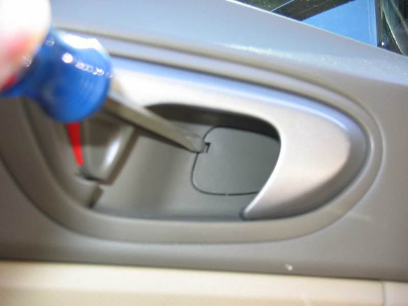

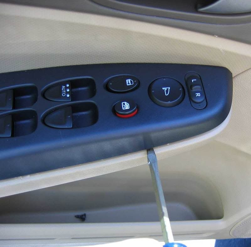

First steps: Pop off door handle thingamabob (sp?!). Then, apply a VERY thin tipped flat-head screwdriver to the interface of the door's control panel and pry upwards on these 3 locations. The peice pops off pretty easily.

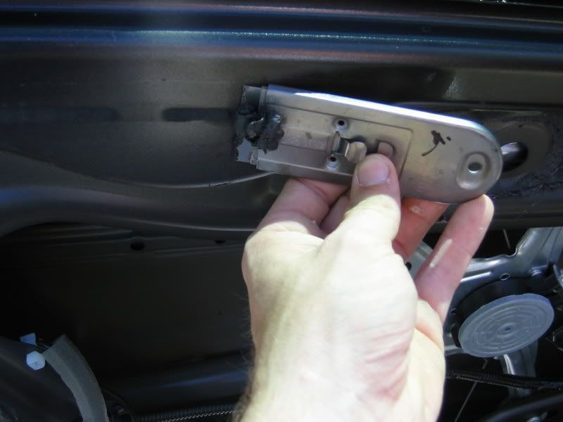

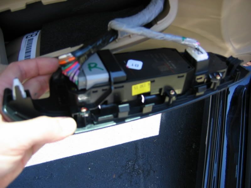

Disconnect the wires off the black peice.

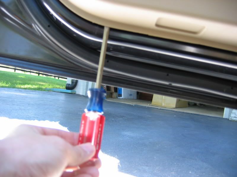

Go along the bottom of the door with the screwdriver and pop the door outward. You can get the rest of the door off with fingers after you get a few of them done with the screwdriver.

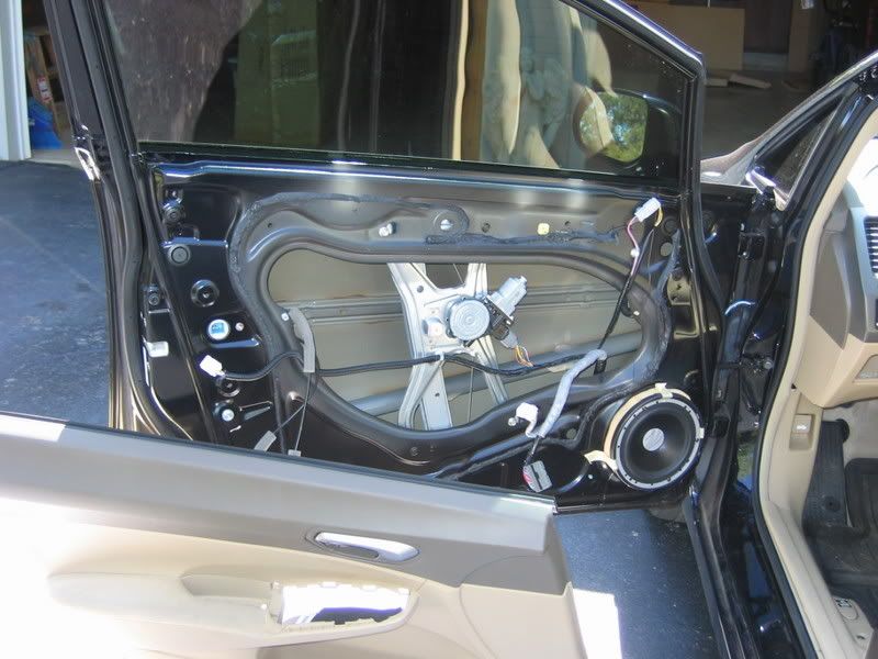

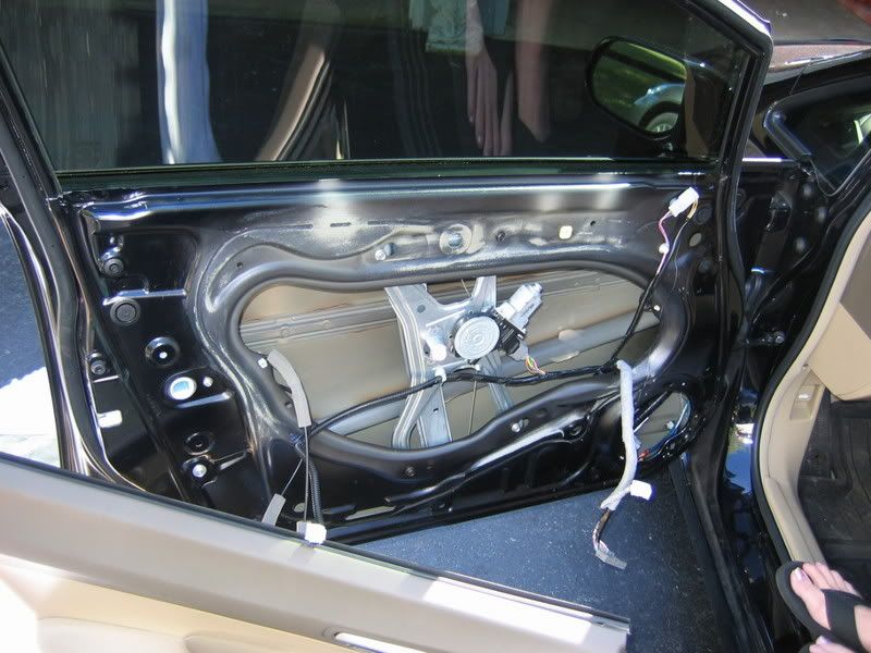

Door stock:

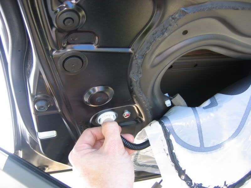

Disconnect all wires.
After the moisture barrier has been removed. Just peel it off. Don't worry about that tar crap right now.

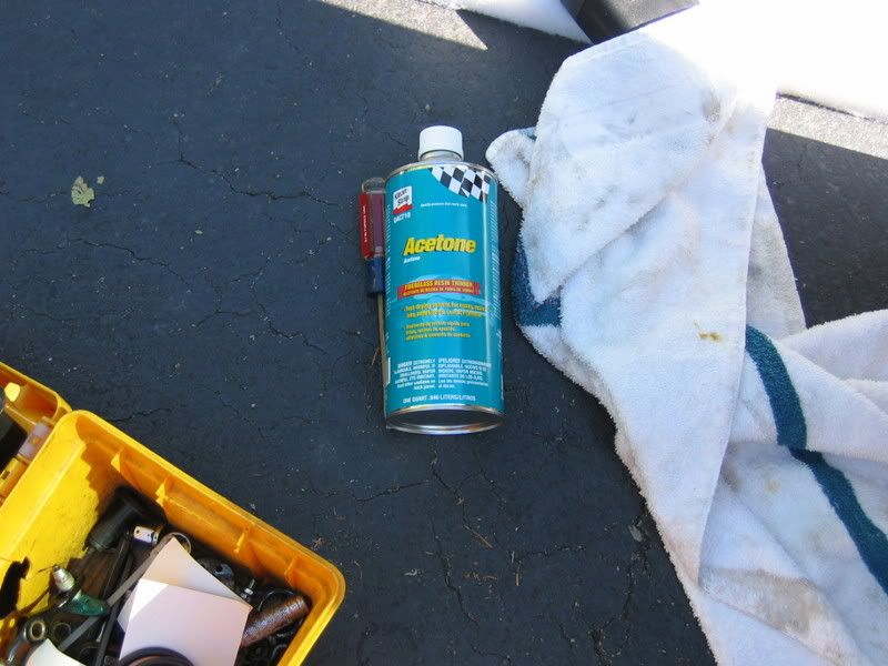

Scrape off the tar with a putty knife, or razor (as in this case). Then use Acetone-WORKS LIKE A CHARM- in an abundant amount to get the rest of that crap off. Don't use a little bit, USE A LOT. Be careful though, and use gloves and maybe a paint mask of some sort to keep from inhaling the fumes.
Door cleaned. Make sure it's cleaned VERY well, otherwise the deadener won't stick well.

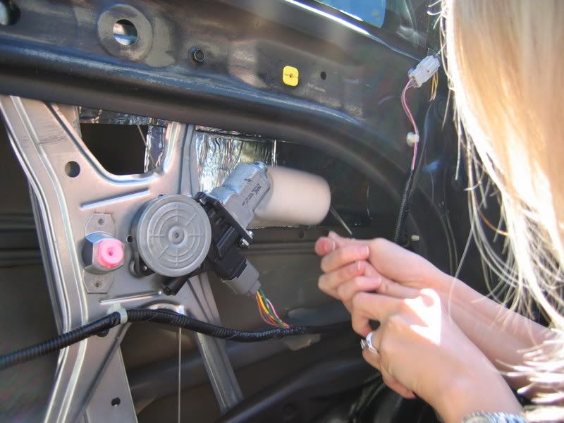

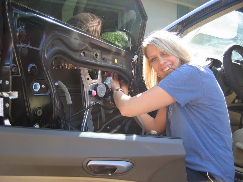

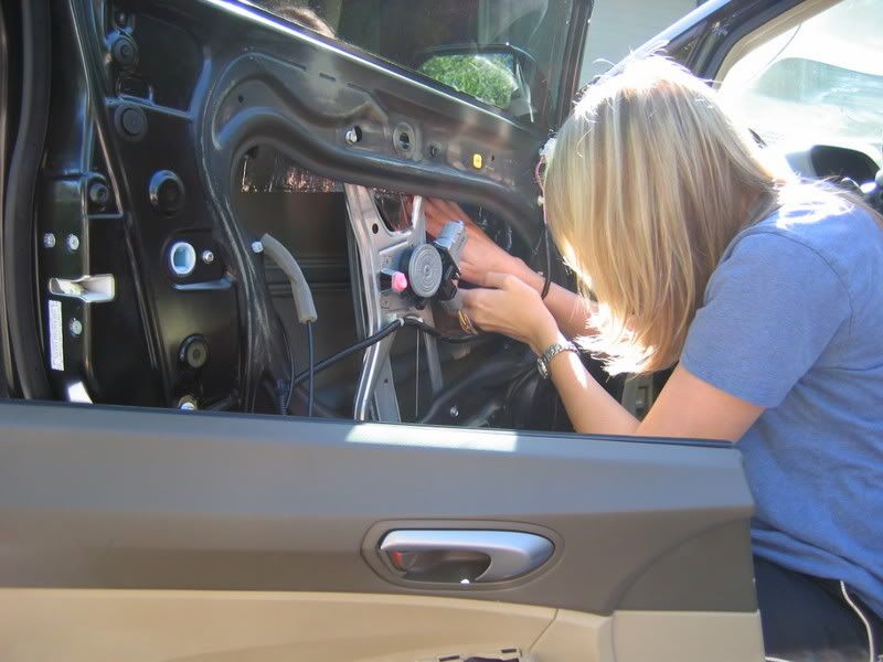

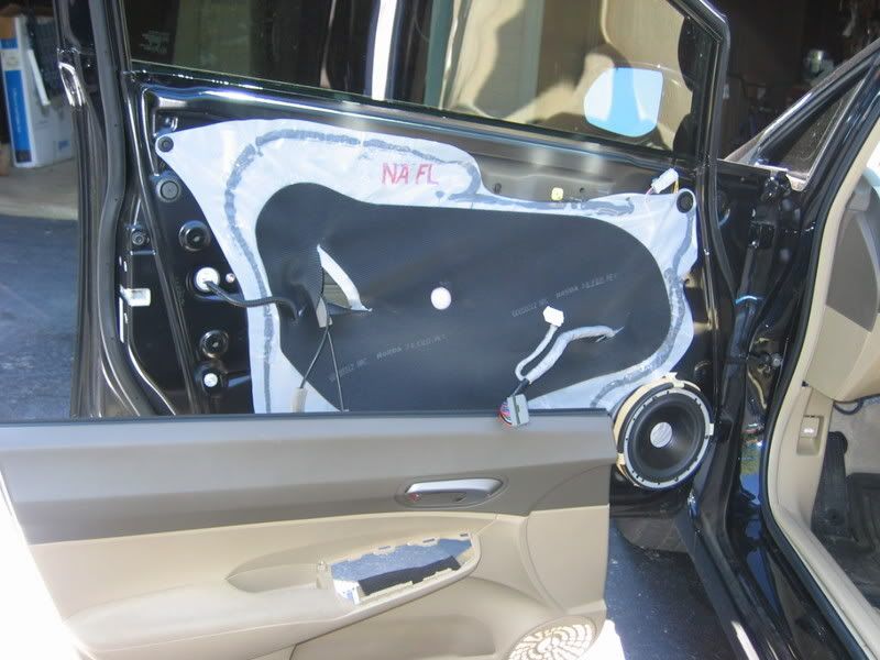

Find a hot chick to help you out. Give her a coke and let her do the work for you. In this case, my fiance helped me out. Use small square, or rectangular peices and little-by-little apply the deadner to the door. Use a roller (we used a paint roller) to help flatten the deadner in hard to reach places.

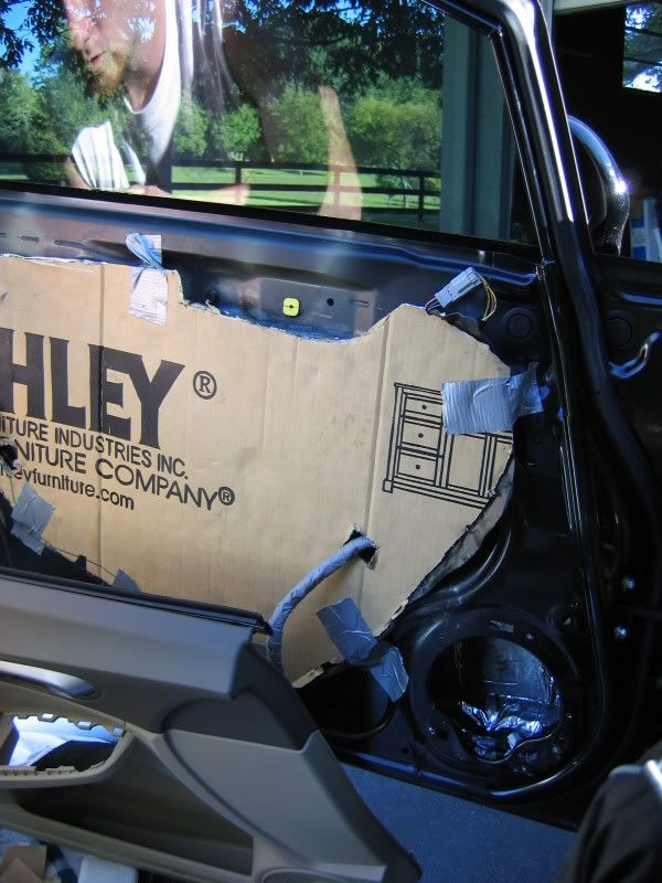

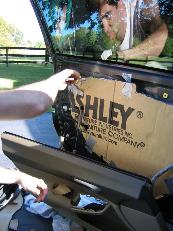

I used the moisture barrier to make an outline in cardboard for the huge hole in the door. I cut mine out of a furniture box. Then deadened the inner-side of it.

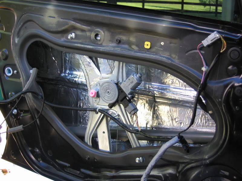

Outer skinned dead:
Test fitting the cardboard cut-out. Use duct-tape to hold the cardboard in place. Then proceed to deaden over the cardboard. Lins had already deadened the inner side of the inner layer while I was cutting.

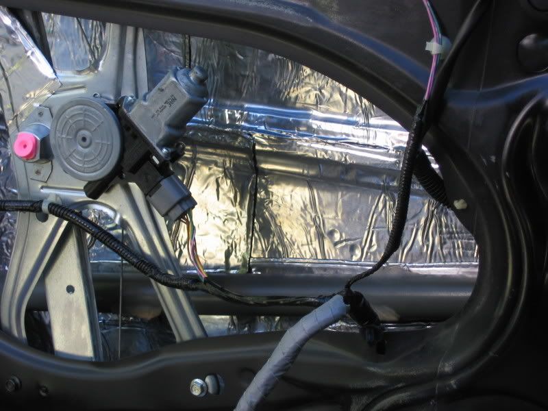

Done. I used some of the material off the moisture barrier to act as a baffle behind the speaker. Not sure if that can be made out in the picture though.
