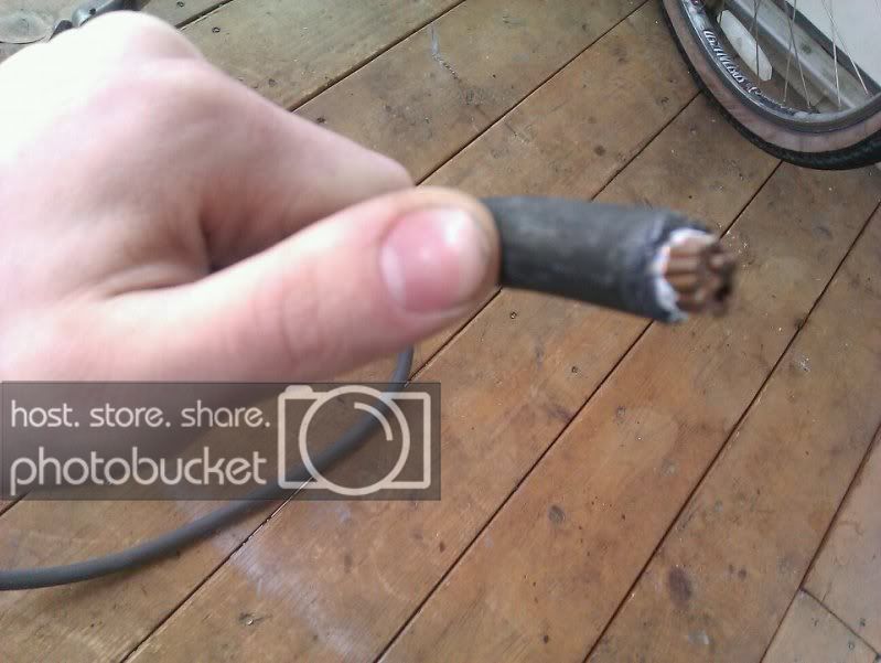

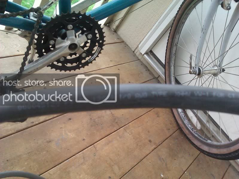

So far, I've finished the box for my HDC318 and got 2/0 welding cable for the big 3. I didn't take too many pictures while I was building the box but I did take some.

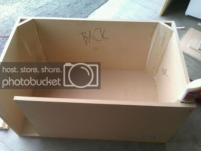

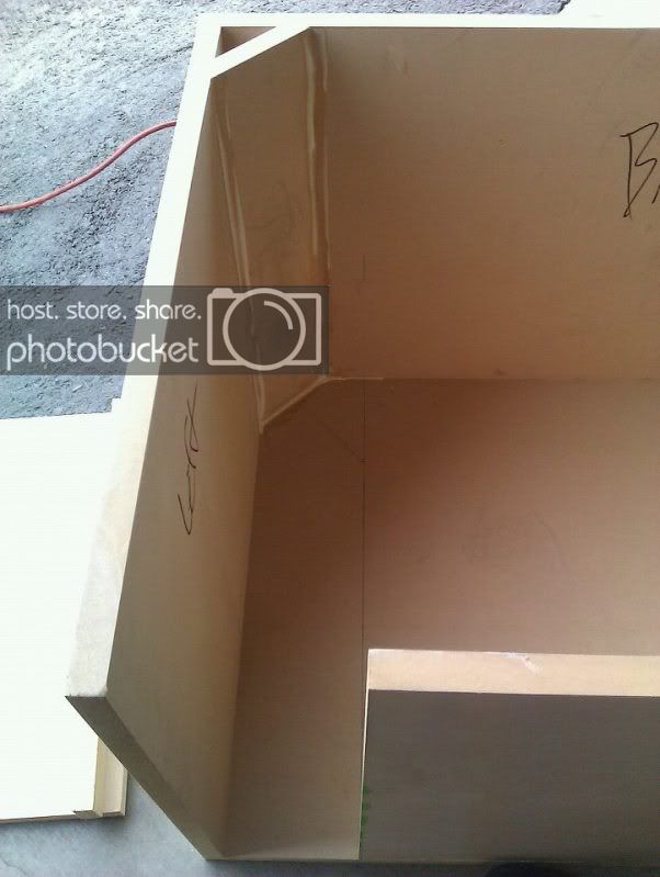

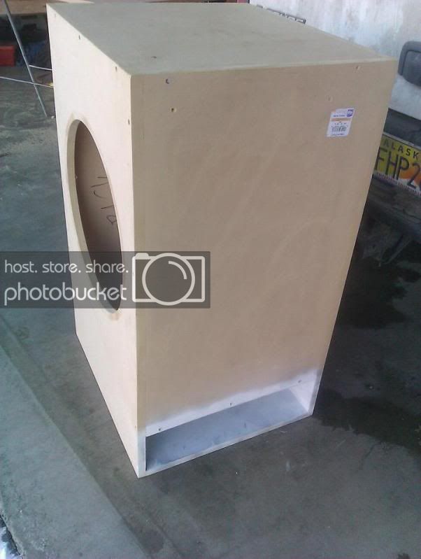

Box is 6 cu ft after displacement tuned to 34 with 92 sq inches of port.

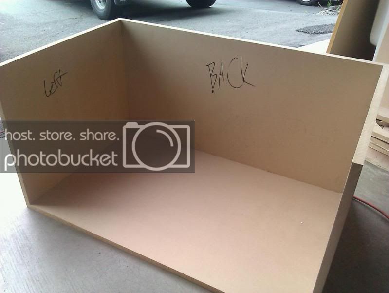

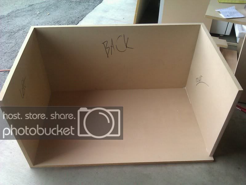

Left back and right side together.
45's put in.

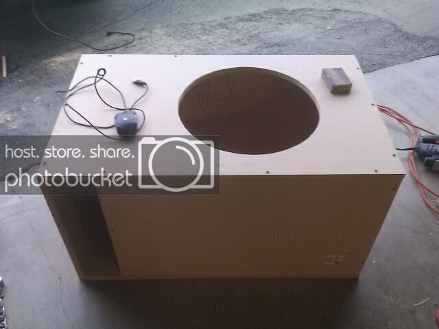

Port layout.
Finished Box.

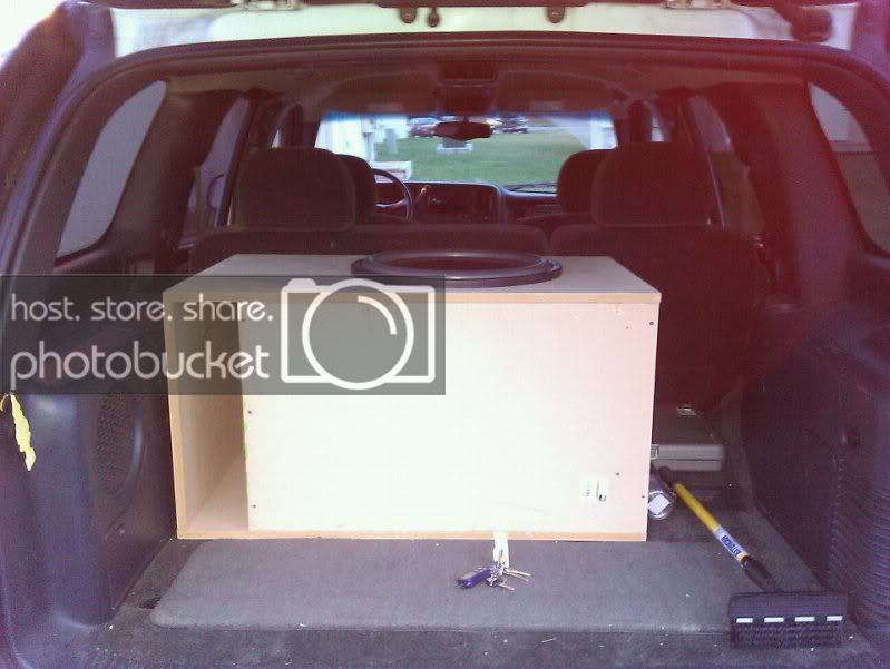

Sub in, and box put in truck.

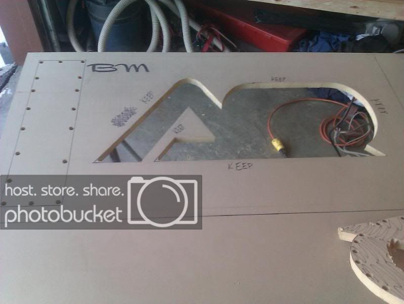

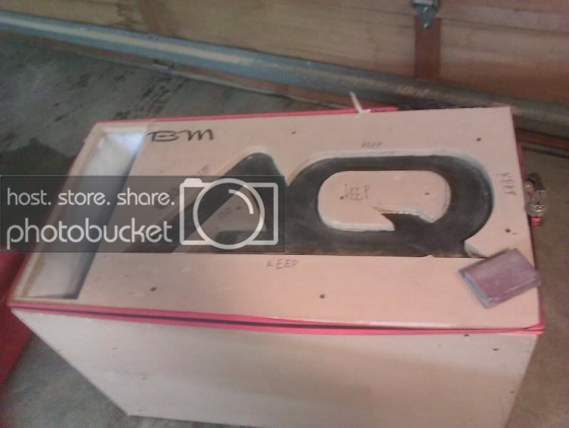

Finally got some more work done. In between moving and snowplowing, its hard to get work done.

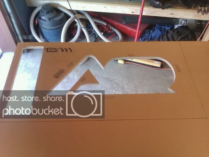

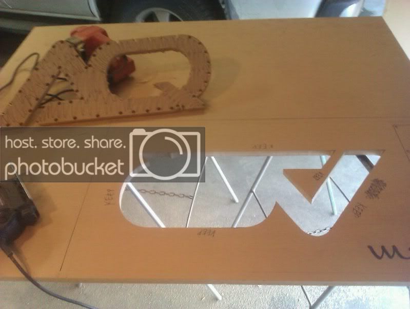

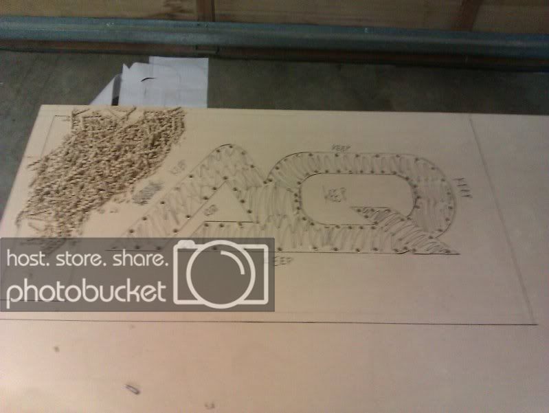

So far, I've gotten the box doubled up all around and the AQ logo cut and mounted on the box.
Pics:
More to come hopefully tomorrow
