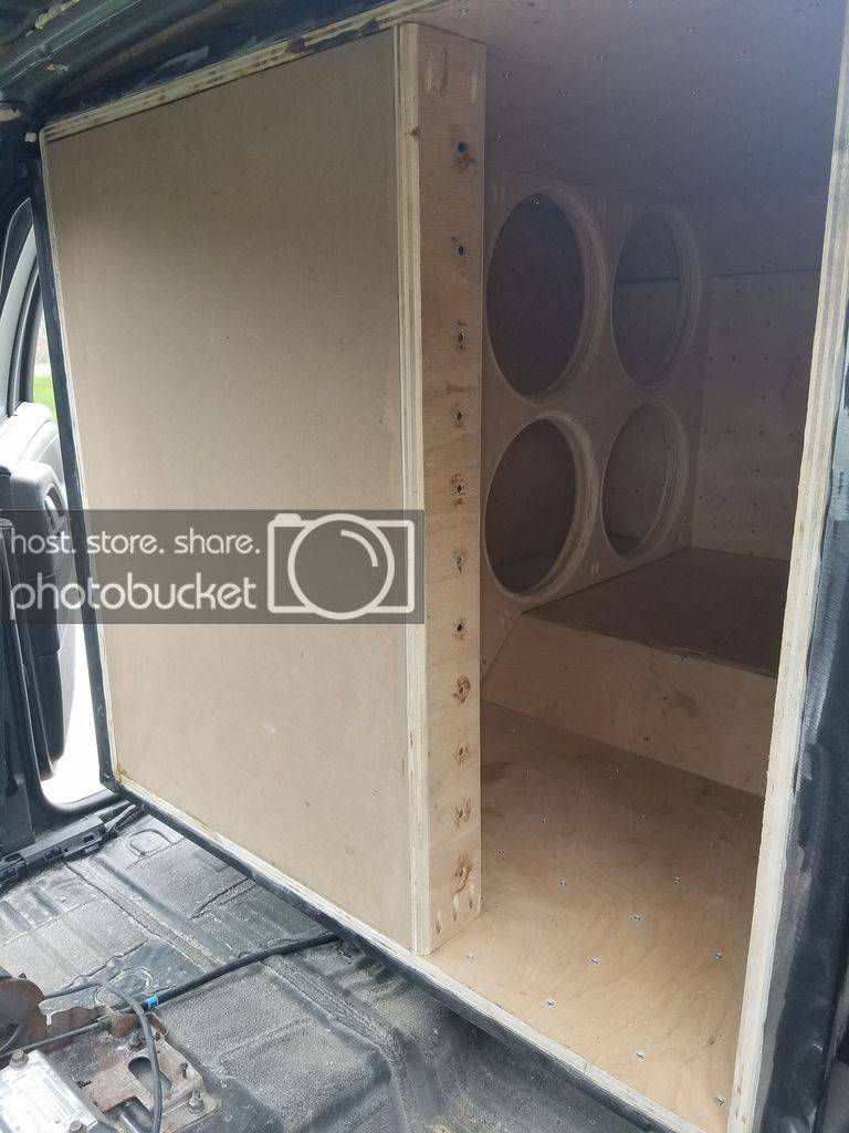

Ok on to what I actually did today, started out by doing Kreg jig holes in both sides of the baffle and getting it loaded in to the shell easy peasy as it was a lot lighter with all the holes cut out. Then I attached the first two layers of loading wall after gluing them together. Afterwards I welded the steel core for the loading wall and attached one layer of wood with PL 8X and 45 self tappers. Ground down all the screw heads and then painted on a layer of Titebond, afterwards I attached it to the two layers of wood that were already in place with 50 more self tappers. So that brings the grand total for self tappers to 719 total so far.*The last layer of 3/4 and 1/2 inch wood are currently drying glue wise so tomorrow I will get that put in place the 1/2 inch is so I can get the proper thickness since the steel core is an inch thick. Tomorrow not much is going to be done as it's supposed to rain in the morning and I'm shooting clays and such in the afternoon with my friends. Might make the rounded piece of the loading wall but it will be alright. More updates eventually....
I'm seeing more and more use of that Kreg drill jig. How is drilling slanted holes for screws diff than the traditional way of drilling straight? Is it hold better, stronger or...?
Screwing boards together that are perpendicular when you can't get to the edges, also works for hiding on the inside.
Sent from my SM-G935V using Tapatalk
I've seen both. Just wondered that's all. Seeing if there was much difference.
Well Saturday and Sunday I just kind of piddled around with some things cleaned up the garage etc. Everyone probably thinks this build is taking me forever but that's okay I just like having something to keep me occupied in my spare time, plus I have to live with it so I want it done right. Got the last couple layers of the loading wall put in and the round over put on if you want to call it that. 56 more self tappers so 775 total for the whole enclosure. Filled in all the Kreg holes with wood filler think I'm going to do paint of some kind. Put a couple pieces of angle iron in the front of the sealed side seemed like a good idea. I also cut some steel braces out of flat stock and left over 1" rod left over from my neo motors. Didn't weld them up though since I'm out of wire. Lastly I painted the fuse holders I made and then wrapped them to match my RCA box I think they turned out pretty good. I should be home in 3 weeks unless I hear from the union thing that I had to test for sooner so that's all for now.*
Oh also the front of the loading wall I did out of MDF because in my experience it's usually a little easier to paint/finish.

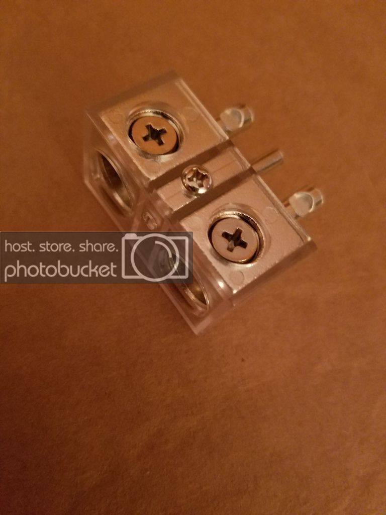

Well flew home today got a couple odds and ends in the mail PAC-LC1 which I thought might be a good idea, Blue Seas bus bars for connecting my relays to that will turn everything on and my Blue Seas OLED volt meter. The volt meter is the most exciting they're way better than the stingers etc and pretty fast I'll post a link to the video. I'm getting to the point where I don't have much to buy (I need 2/0, a fire extinguisher, some fans, different sized alternator belt for whenever I get that part done, fiberglassing materials, some different rear springs to support the weight from the build and that's about it)

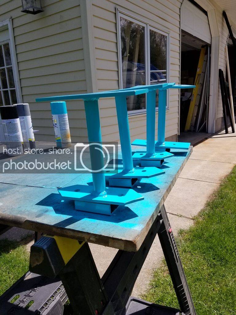

I also welded up the braces for the sealed side finally, amazon sent me this gem of a spool but it works alright. The braces are teal*because they won't be visible and it was the first can I grabbed. The black pieces will actually be visible.
