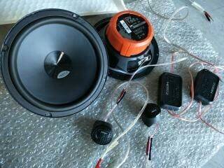

Hey mate, if you are after more volume in your ride then go audition a few components with high sensitivity so they will be more efficient and will get loud without you turning up the knob too high.  I would recommend JL Audio or Kicker even Pioneer are better contenders. It also depends on what brands your local car audio shop has.  You can go Focals but I have found the European brands tend to have a flatter sound for my liking. Hertz components are another contender so is Audison and Morel speakers.   Best to go listen to some and then you can haggle the salesperson to give you a good deal.
