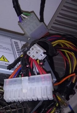

Hi,
from the PSU I only used the yellow and black cable (from the 24 pin molex I did not get them because the yellow and black cable are present)
I can not remember if it's + 12V1DC-8A or + 12V2DC-14A
the fuses are:     15A yellow radio cable
                           0.5A blue radio cable
I connected green (molex 24 pin) + black to a switch to turn on the PSU
I isolated the orange and blue cables from the radio
molex 4 pin (2 yellow + 2 black) is not used
I cut and isolate the sata cables.
psu is leaned on the wood momentarily and the cables are insulated and free
so what should I do?
radio cables :
-yellow  _+12V
-black  _ground
-red     _switch
-orange _illumination
-blue _antenna remote

on the radio, ditch the orange and blue. cut them and cap them. red and yellow together to the +12v (black and yellow) and black to black.
That psu will be enough for the deck, but not also an amp. Period
the cable connections are already made as you can see from the photos and the cables already cut and insulated.
I would like to know now what I should do to secure everything.
and what is the sufficient power required to put an amplifier and a sub + 2 speakers

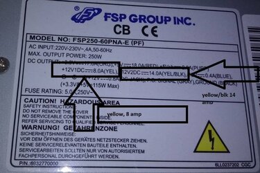

there are 2 lines at 12v with different amperage (+ 12V1DC-8A or + 12V2DC-14A)
where is it better to connect the radio by choosing between the two?
how I identify the two 12V lines since the yellow cable is 12V and the black one is the ground

it says on the sticker that the yellow is the 8 amp and the yeloow/black is the 14 amp. just sum them on a copper binding post
there are no yellow / black wires
there are only yellow wires
I got a yellow one like + 12v and a black one that is the ground
at this point I do not know what are at 8A and 14A
how to distinguish them?

it shows yellow as 8 amp and yellow\blk as 14 amp
summing them just means to put them together, you theoretically should get 22 amperes from doing this. Youre going to want to have a pretty short lead from the PSU and get a thicker wire from there to avoid the wire heating up.
