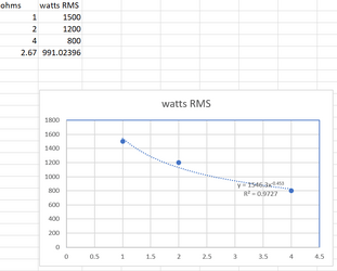

I know this is waaaay late, but I see this question a lot. I won't bore you with the math, but I used nonlinear regression and the specs at 1,2, and 4 ohms to estimate the watts RMS @ 2.67 ohms. You theoretically should get about 991 watts RMS; the R-squared value is not ideal, but it's close enough to 1.0 be confident in the formula Excel spit out.  Hope this helps someone...
