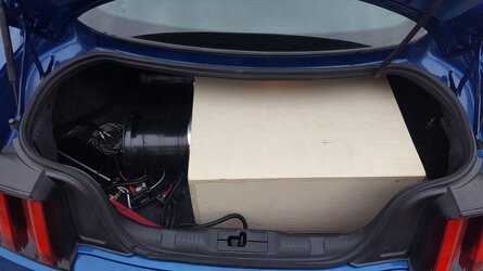

I'd like to see a pic of the install, Mustang trunks sure are smallish...
Got a pic or 2 to post-up?

is your box sealed?
That's why I asked for pics of the install... I'm suspecting sealed
To put it into perspective, this is what 4.2cf looks like in a 17 Mustang. 32wide 13 tall 24 deep, turned sideways 90 degrees. Has to be loaded into the trunk via the back seats, height and depth are maxed as far as getting it in the car goes, You might be able to add an inch or 2 on the width but that's it.
Thank you all for your replys! Here is the only picture I have for now. Until tomorrow the box is ported. I like all your input I like to believe I know my equipment and when things get hot. I'll be able to hear it tomorrow night. My electrical system now is 3 Optima batteries high output alternator and the big 3 I hope that will be good enough to feed this amp. I'll post another pic tomorrow and let yall know how it sounds.
How does that even sound good? Ports toward the bottom section of the trunk and not fired into the cabin thru the rear deck. Correct me if I'm wrong but doing it this way is best for trunk cars.
Actually you're wrong. Sub and port to the rear or to the side is usually best in a trunk.
Port firing through the rear deck is a common misconception for trunk cars. It most leads to cancellation.
His box is not ideal because the ports look too small and most likely the airspace is too small for the cone area.
It might be better to side fire the subs and fire the port to the rear. I've seen/heard that orientation in a 2dr Grand Am and it worked well.
Thx for posting pics Op... if it sounds good then thats all that matters.
Port area looks small for 4 10's but pics can be deceiving.
As long as you think the amp swap will be fine... go for it
Kinda looks offhand that the box will limit output to me tho... idk
