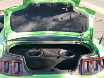

4 Rockford Fosgate P3 10s in a mustang

Actually you're wrong. Sub and port to the rear or to the side is usually best in a trunk.
Port firing through the rear deck is a common misconception for trunk cars. It most leads to cancellation.
His box is not ideal because the ports look too small and most likely the airspace is too small for the cone area.
It might be better to side fire the subs and fire the port to the rear. I've seen/heard that orientation in a 2dr Grand Am and it worked well.

Removing the rear speakers works when the rear seats don't fold down. It's very hard to pressurize the cabin when the rear seats don't fold and there aren't openings to vent the air from the trunk into the cabin.
That picture makes the port look a little smaller then it really is.

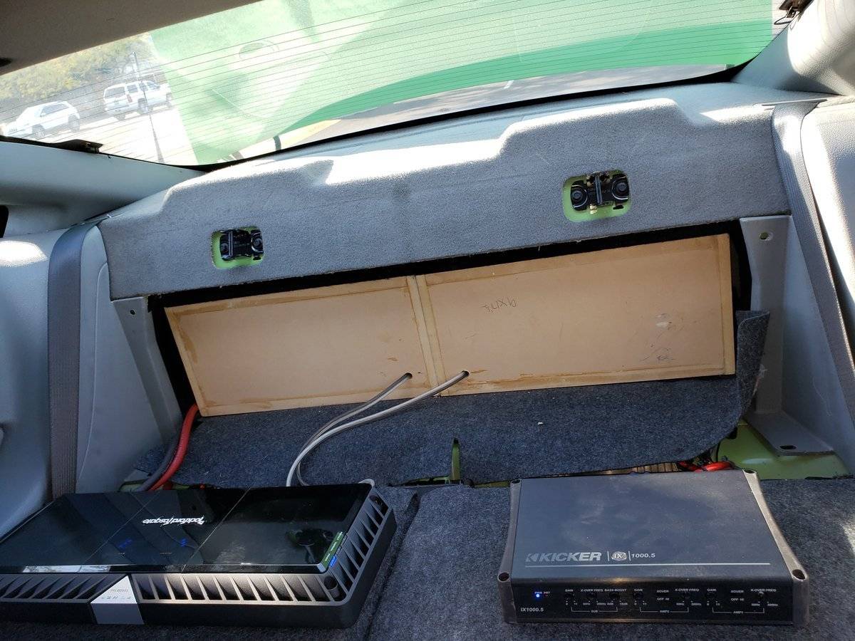

I have to work with the room I have and it isnt much with a mustang sadly. But I made things work the best I can. This is a better pick of the port size.
Are those 2 separate boxes joined with a beauty panel?
Those holes where the wires come out need to be filled. The leakage will cause a loss of output and will create noise and maybe even some cancellation. Get a tube of caulk or use box terminals or binding posts.
Honestly I would look into firing the subs to the side with a rear firing aeroport. The box is bigger than it looks.
Agreed with Kush. fill in those gaps around the speaker wire holes. I'm surprised your not complaining about whistles or weird sounds coming from your enclosures. Looks like he's using 8 gauge speaker wire?? Kinda overkill imo.
