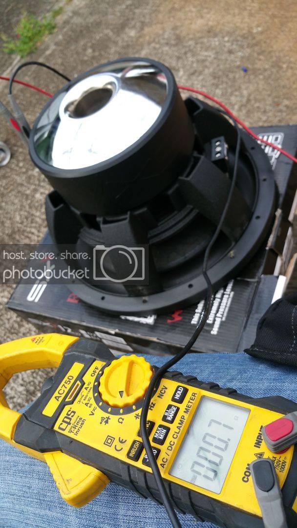

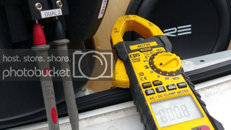

The subs are dual .7. I posted about it before. Both subs are dual .7 and I tried to get them replaced from where I got it from and he would not replace it. It says .8 cause I kept moving the probes while trying to take the picture.
Why does it say dual 2 on the terminal? Were they reconed?
No. Like I said it was a manufactur problem. I tried taking it back to the company but the boss made like he knew more thought I might have blown the speakers or something. He didn't want to exchange it for me. I was pissed. Subs was not reconed. I even tried to call RE and emailed no reply back.
