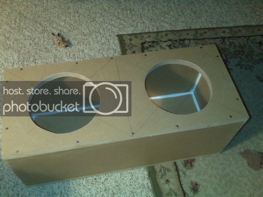

Yo B-rock....first pics of your box mang
bonesninja

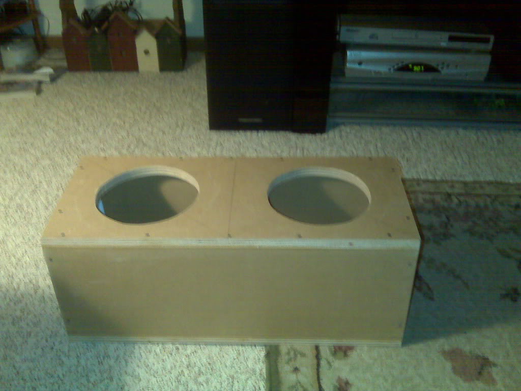

None of the standard stacks of wood or anything like that....just box pics. I still need to put the feet on it....for people looking, it goes in a ranger pickup and has to fit the ledge along the back wall. Also need to carpet it once the feet go on.
0.8cf net sealed for 2 JL Audio 8w3v2's.
are those roofing nails??
lol....no. They are the type of nails that have little ridges on them so they don't back out. I only use them because i don't want to leave the clamps on each joint til the glue drys for a nice tight fit. I pre-drill all the holes and then drive the nails....works amazingly well and i never have to worry about wood splitting or a hole stripping.
sure look like it but what do iknow i am just a dum :) roofer
pretty sure roofing nails are galvanized or aluminum and have a larger head...i use what are called threaded nails or ringed nails because they have much better holding power than brads or straight nails
