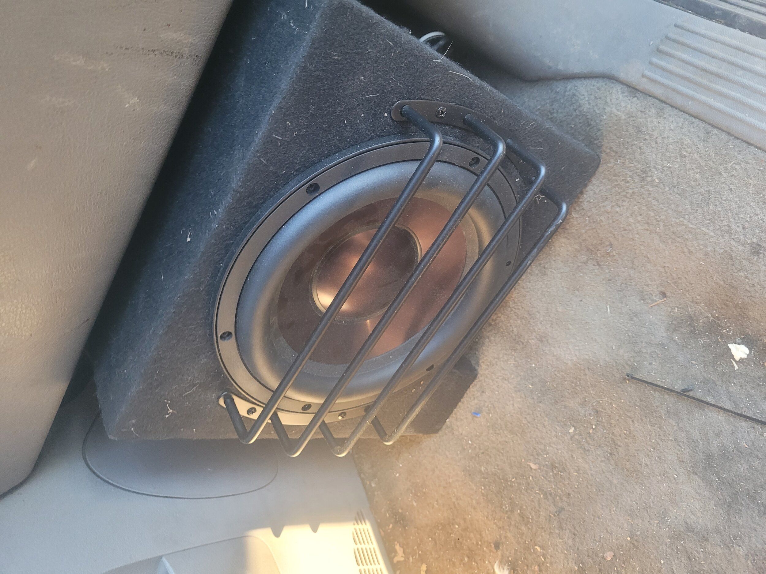

The reference ho I'm running sounds really good. about .75 - 1 cuft would be about right.
mine is in a box barely big enough to mount it 😂
