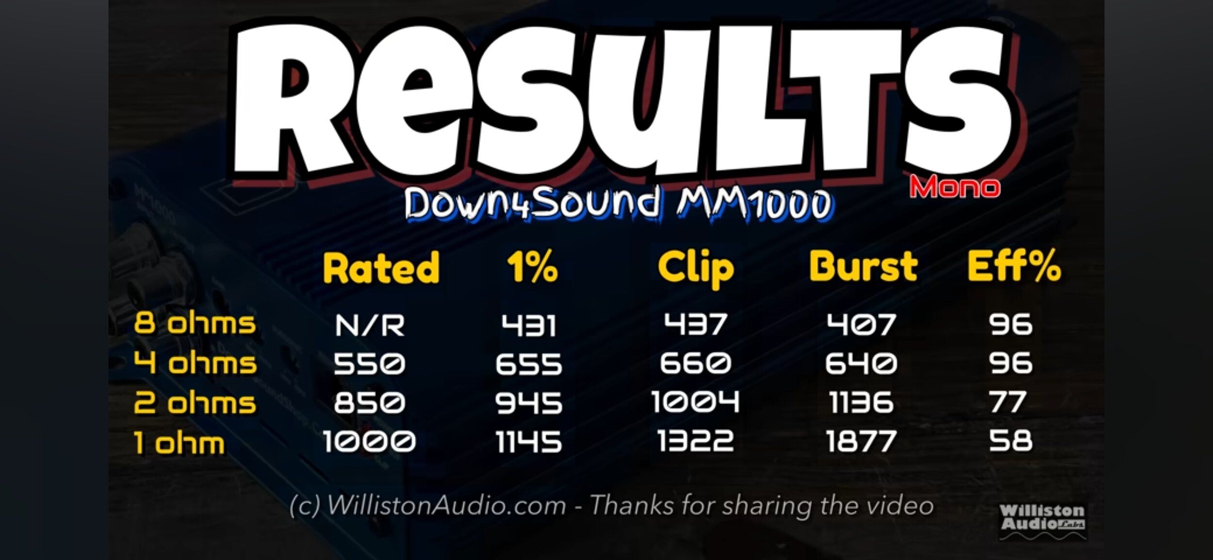

I do think part of it is how d4s designs amps to be extremely dynamic on a dyno since this mm1000 iirc dynos nearly 1500 at 1ohm dynamic. So it's clean power just too much of it.
Well I stand corrected according to the amp dyno I may have been sending rather extreme levels of power for these subs.
so technically I have 1 koda 10 at 2ohm and it's surviving but it's not exactly loud even on 4x the rated power.
My dumbass over simplified things. Usually a 1000w at 1ohm amp makes 500w at 2 and 250w at 4ohm if i wouldve paid more attention i likely wouldve just ran them at 4ohm instead
