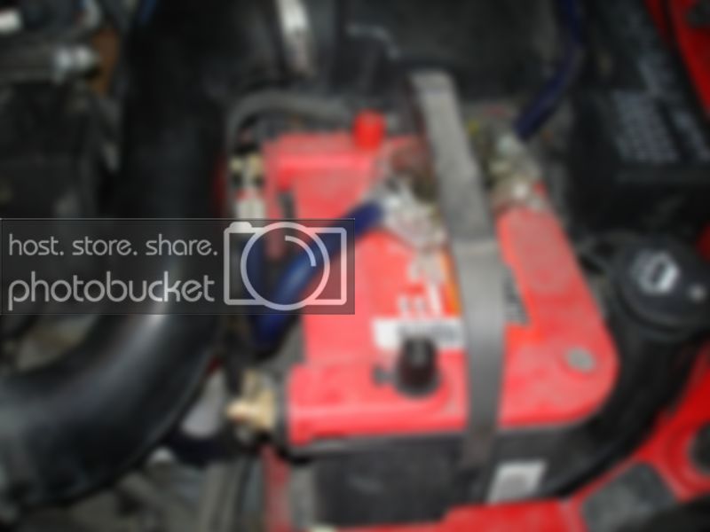

front battery

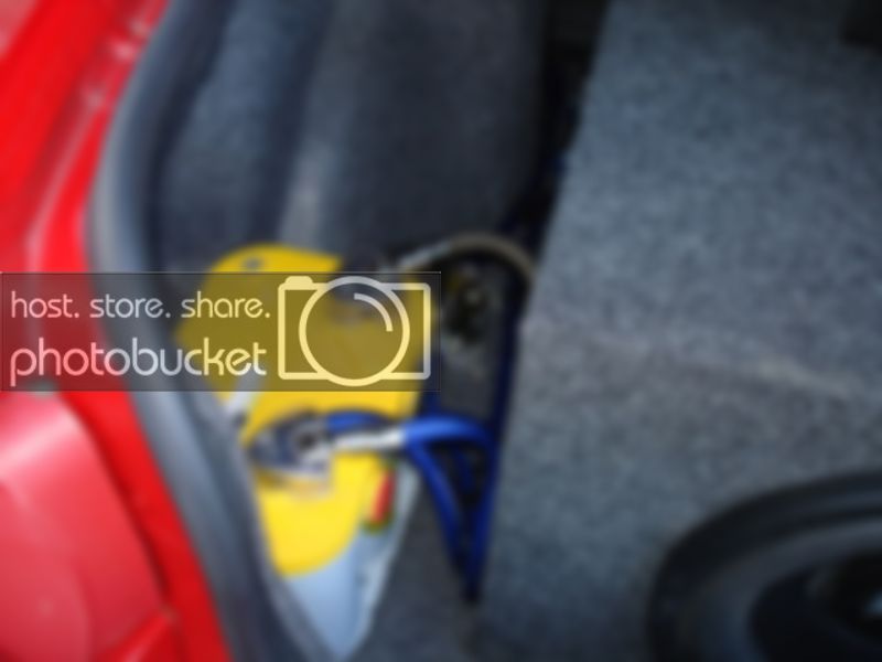

yellow top in rear

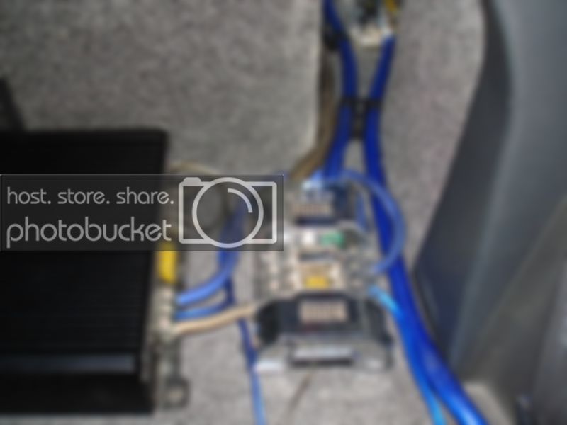

wire coming off battery to distro

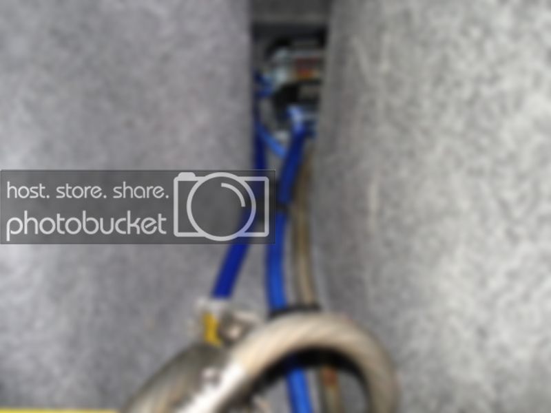

distro
