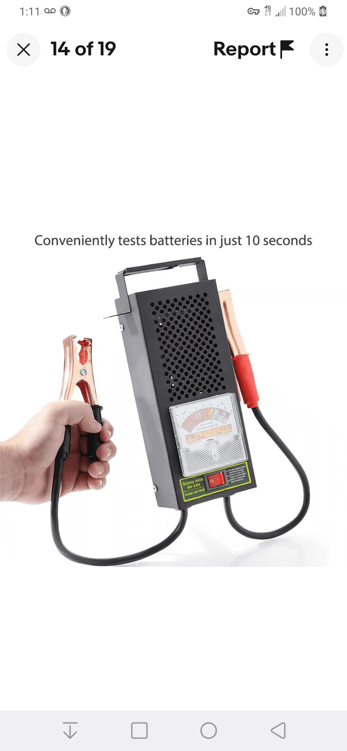

Not yet. What exactly is "battery load"?
It is a tester with a simple resistance that draws alot of power from a battery. After that "pull" the voltmeter shows the battery charge right after. I got one like this at Harbor Freight for $20.
It is a tester with a simple resistance that draws alot of power from a battery. After that "pull" the voltmeter shows the battery charge right after. I got one like this at Harbor Freight for $20.View attachment 62229

I would think your stock alternator / battery would be just enough for that RF amp, but that may not always be the case, or a problem with the battery as mentioned having it load tested. Not sure how old the battery is, but if its a 2020, it might be nearing it's end of life.
