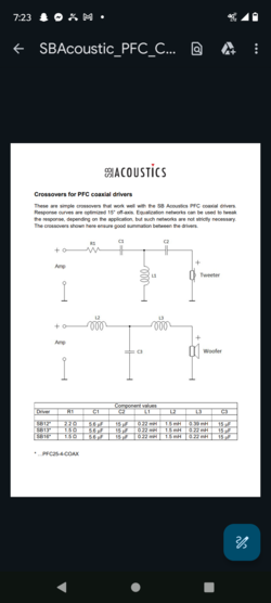

The point source (coax) units from SB acoustics, very good drivers. I would run those on their own, nothing in the dash or other tweeters, dual tweeters no bueno!
That's what I was thinking. But unless I'm reading it wrong, you have to make your own crossover to the coaxial mounted tweeter? I dont see any mounted to the basket like usual

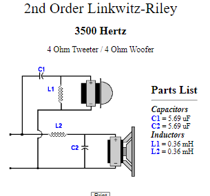

Yea from what all I can see is that you have to make a crossover for the tweeter. I'm sure how how to do that. I'd really like to use these drivers they look pretty high quality and the spec sheet looks nice
that is an Ideal crossover and designed for use in an home type loudspeaker. A simple Linkwitz-riley 2-way is easy enough/ The tweeter wire lead comes out of the back of the magnet , easy access.
