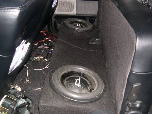

it would be 2 Boston Acoustic G5 off of 500 Watts Each. so the enclosure would need to be 2.0-2.4ish
would be somthing of this sort.
Also how much room is needed between the sub mag and the wood?
On a box like that, I would say 1/2" material would be ok. The panels are relatively small in size. If you use 1/2", just be sure to properly brace it and I bet you will be just fine.
