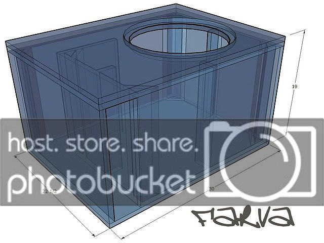

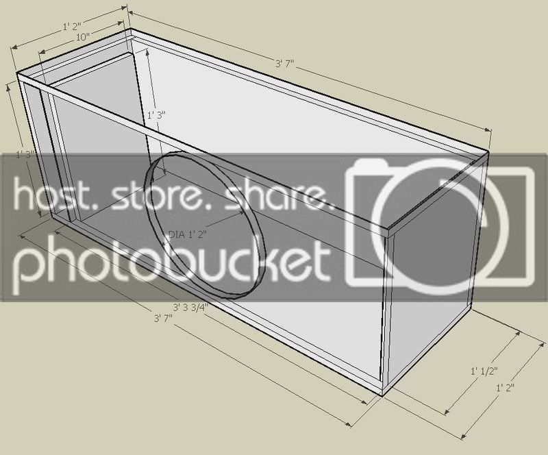

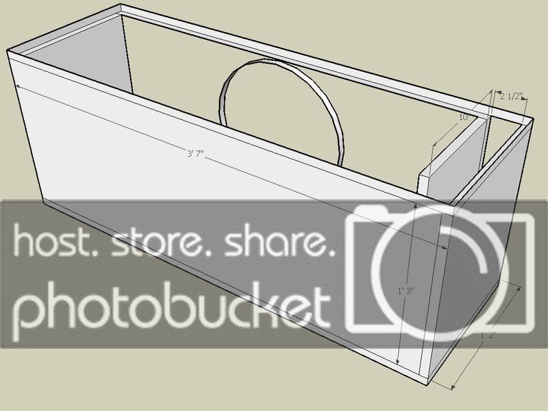

i need some practice. i will do it for free. the only thing i wont give you is a 3-d picture. i will give you all the dimensions needed to make it.
Yeah, I don't need a picture, I just need the measurements.
I'll post up the space I have to work with tomorrow.
anyone //content.invisioncic.com/y282845/emoticons/frown.gif.a3531fa0534503350665a1e957861287.gif lol. I want something permanent, and yes it will be permanent b/c I won't be able to afford new woofers for a while.
wat?
4.15cu before sub dis and after port dis.
port is 2.5" wide at 10.75" long tuned to 34hz.
43W
16.5H
14D
3/4" wood
Its designed to RE optimum enclosure recommendation. Along with 67 inches of port, double baffled for flush mount and fully braced. PM for more info, if interested.
