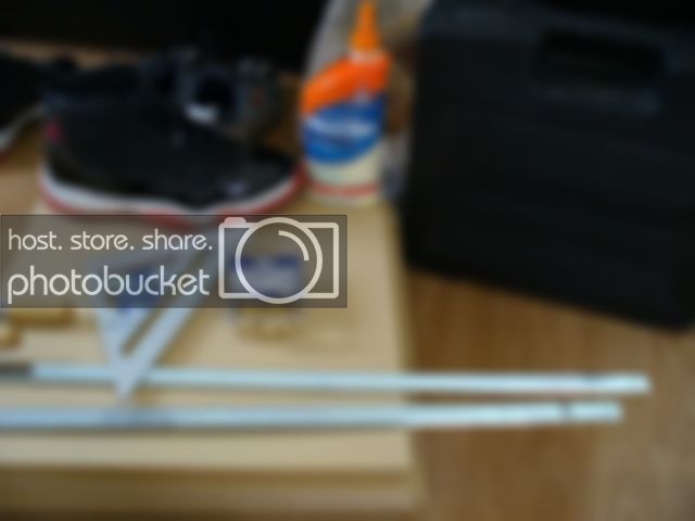

Picked up what I could afford + the wood cut at home depot (no saw at home! and cant afford one) For the most part, the pieces are pretty good, theres a few that is off by about 1 or 2 cm at the most + or -, but it should be alright with a few screws.
Pretty much what I'll be working with... =X!

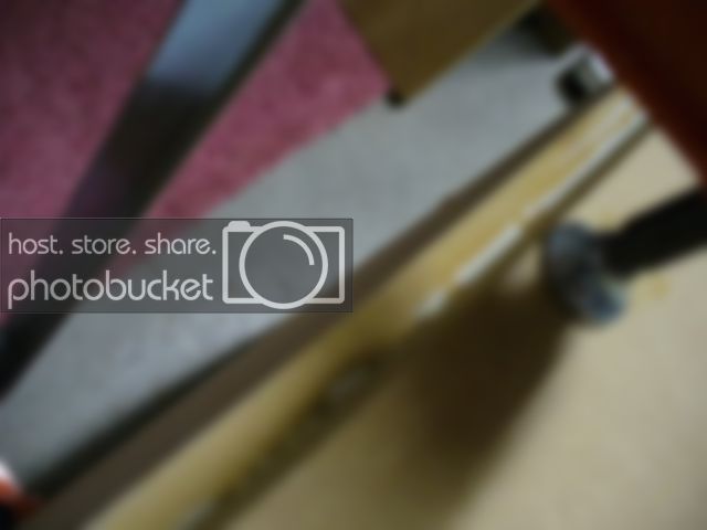

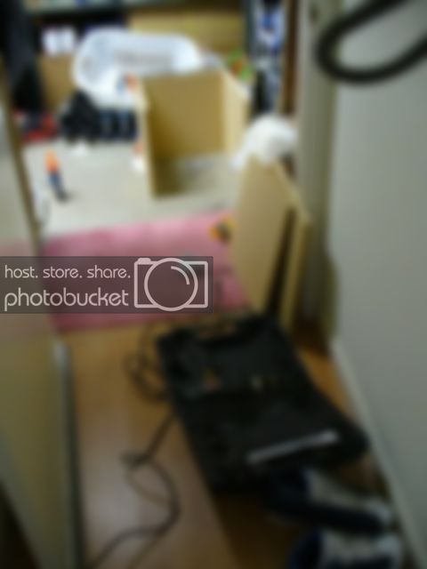

First side up.. notice the little ammount of space i got to work with =(.. **** small house

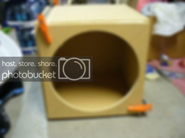

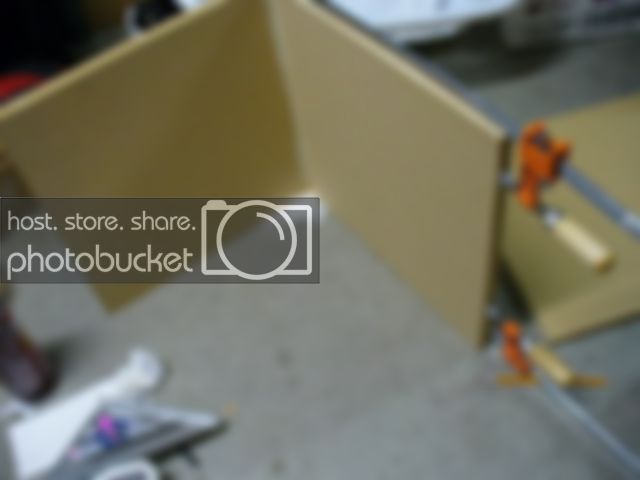

Wall 2 up
Is 3 screws good enough?
from afar.. looking good so far o_O?
Three screws is plenty, the only thing they do is keep the wood tightly clamped together while the glue dries. A lot of people don't even use screws, or they remove them after the box is fully assembled.
i would personally countersink those screws, but thats just my preference
predrilled some holes in it before the screws to save some money instead of buying countersinks =O, 7 screws so far no splits

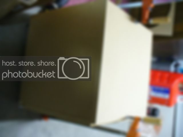

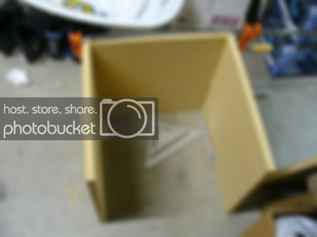

5 sides completed. the bottom doesnt exactly fit flush, but i suppose its close enough, i saw this polyurethane filler stuff thats suppose to fill in cracks at Home depot that i think ill pick up and just fill in the corners just in case there isn't air tight, but it looks air tight!
I wish I had a saw and like perfect cut pieces so that it would look better :\, but I suppose i gotta work with what i got..

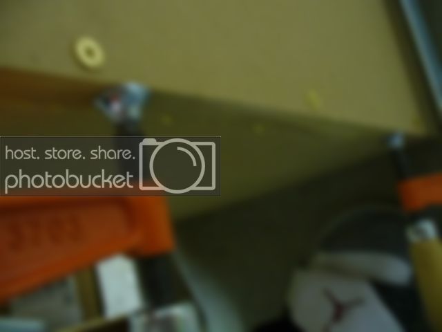

4 sides and the bottom on
about 2cm too short!, gonna fill this part in with that stuff from HD.
think i'll pick up some corner/L brackets for extra support too
