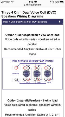

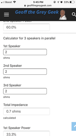

Wiring under 1 ohm

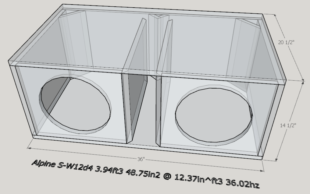

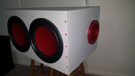

That current box looks like a prefab to me, here's one I did a design for recently for with a 1200 watt amp pushing the subs...
IDK what your goals are but the port area you got looks a little small to me for one thing.
Ya, Type S subs believe it or not in the right enclosure will rattle a trunk real well given a good amount of power, and battery reserve. Instead of investing in a third sub I would invest in doing up a proper box for the two you have and use the difference in a better amp, more power etc.
All my SA's read 3.7ish.. ending up right at .625.
Maybe other coils are different, i never played with anything other that Sundown after i got back into the hobby
