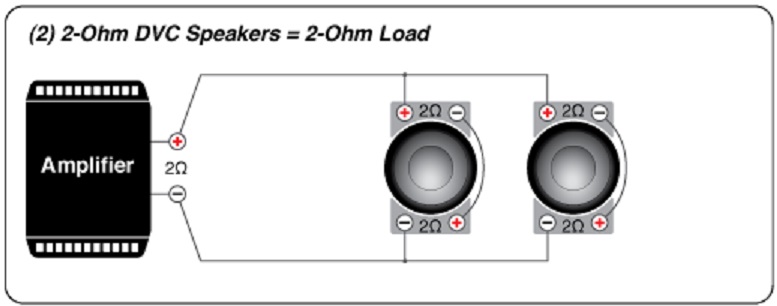

So I have 2 -10" dvc kicker subs. Each sub is max peak 800 watts. Rms 400..
I have a kicker amp. Dx monoblock.. 250.1
Now this amp has 4ohms 125w x1 channel or 2 ohms 250w x 2 channels.
I'm "think" I should wire my subs in series... Is this correct or should it be wired parallel? Thanks

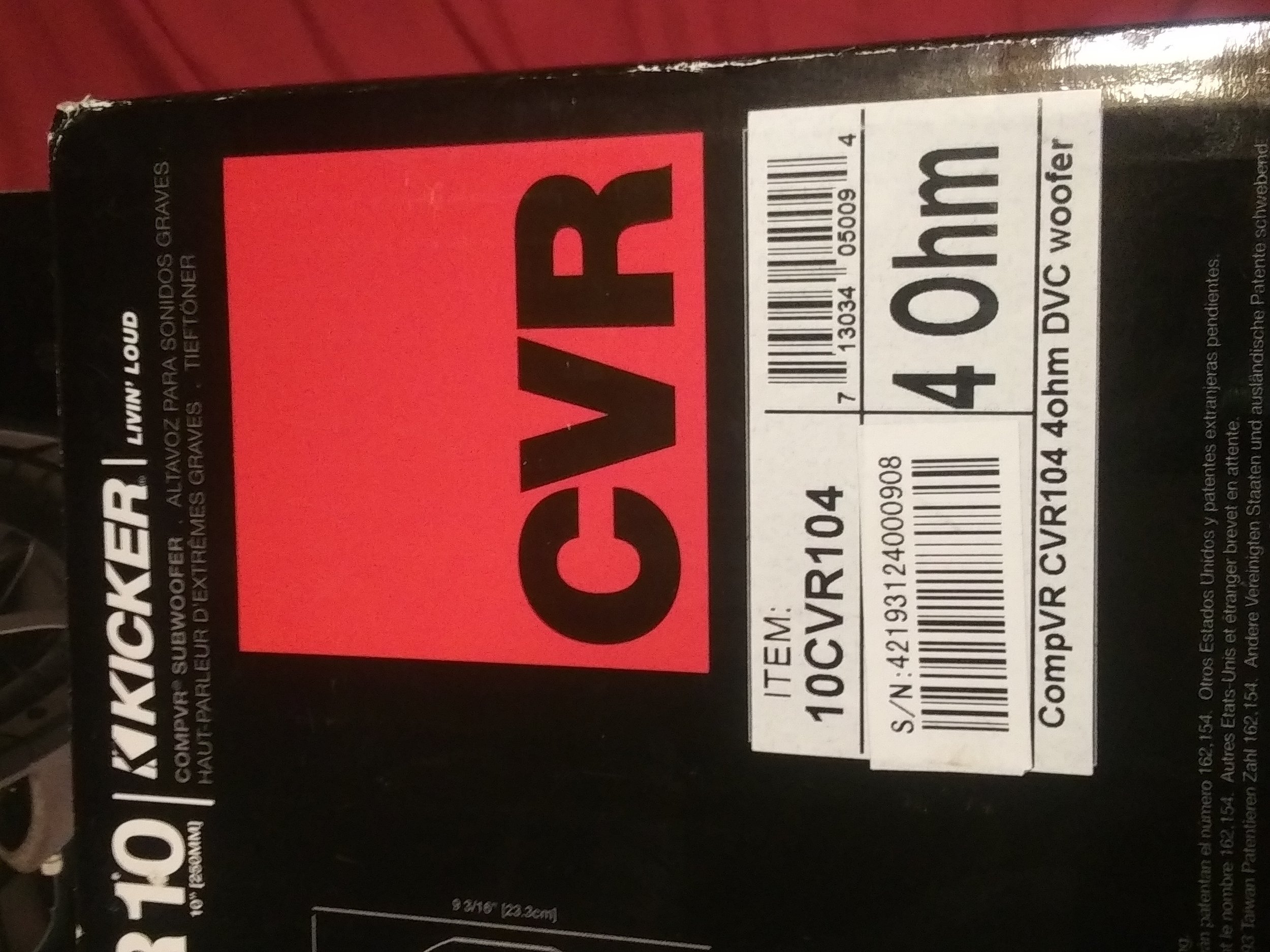

No it's parallel. Your subs are D4s. That diagram will work but your amp will not give you full potential of your subs. Your options are (imo):
1. Go with it
2. Trade the subs for D2s
3. Get a bigger amp
4. Get a second kicker amp and use one per sub
1. Go with it
3. Get a bigger amp
So, in ur opinion, u think I should wire subs parallel and that would work and not harm anything? And yes, soon I will get another amp for each sub. I just don't wanna harm anything. So wiring parallel gives my subs the max they can do. OK thanks.. Man, never thought it was so complicated hahaha.. Tyvm
