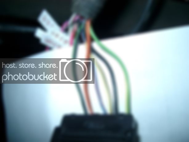

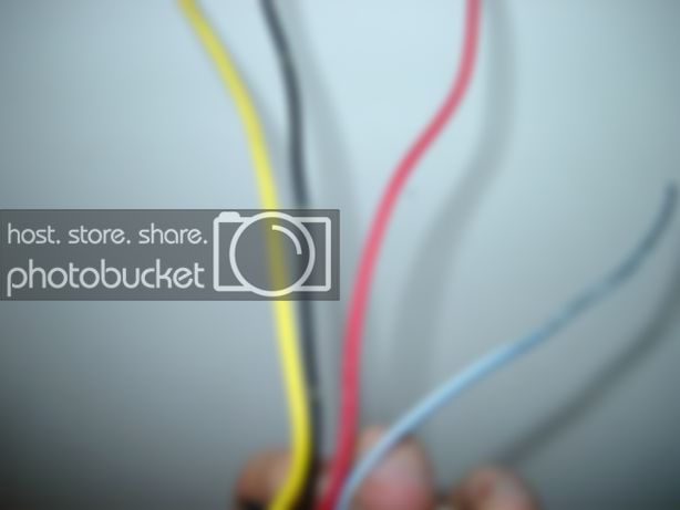

I have all of the speakers wired but im still confused about the other wires on my new hu there are 4 wires and on the cars hu there are 6 what do i do
yellow=battery
black=ground
red=accessory(cd changer)
blue with white= remote
this has 2 match up with this
what do i do im stumped i dont kno what to do
help me
yellow is constant 12 volts, black is ground. the rest are speaker wires, the ones with the black stripes are neg. the blue with stripe is power ant. the solid blue is remote
left fronts are white, right fronts are gray, left rears are purple and right rears are green
i alreaty have all the speakers wired. I dont see the solid blue wire. Ive got the ground now but is the yellow wire the power even though it has a black stripe
the black wire is ground
the orange yellow and green wires all carry a charge
green wire carries a constant charge which probably means it is the clock and settings power wire
other 2 wires arent charged
also what does remote and accessory mean b/c on the hu it says the red wire is accessory but on website it says 12 volt. The stock has 2 power wires but new one has only 1 should i splice a 3 2gether. Im really Confused.
There is an adapter harness that you needed to buy... so you didnt have to go through this hack and test job.
it simply plugs right into your existing harness.
What make, model, and year is your car?
EDIT:
nevermind on that, heres the one you need from Metra 70-1770
