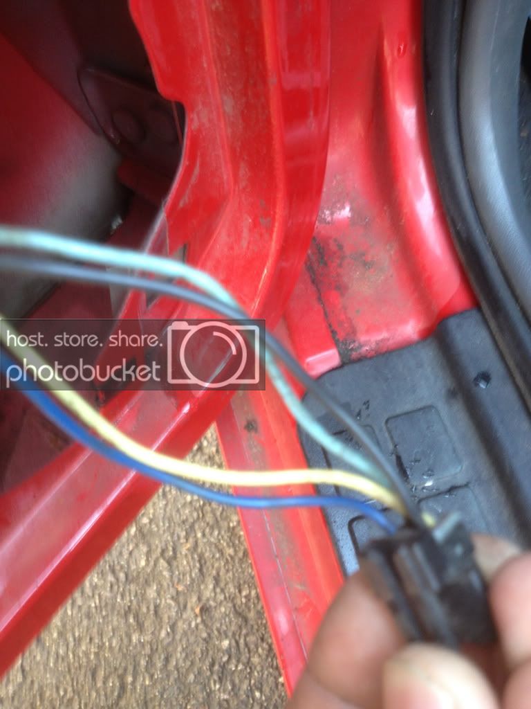

I know that's messed up about my harness. I had a nice alpine with satellite radio I was going to put in until I saw that. When the speaker is out I have 4 wires. I will post picture when I get home. My iPhone won't let me did.
Here is the picture of the wires coming out of the door.http://
[/img]
Guess that is what I'll have to do. Really didn't want to run wire through the door jam but if that's the best thing to do ill do it. Won't be too bad only have to run wires for the mids. Tweeters are going on the A post.
Thanks a lot for your help Trumpet!
