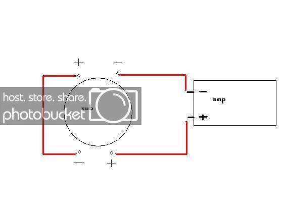

so i have a orion hcca 2400 and 2 p10d4 subs and not sure if the way i have them wired would be the best for the amp , reason i have these subs and not the h2 10.04 is because i only have .61 of a cubic foot of air to work with since its in a dodge truck crew cab , not much room in them trucks .. so the amp is not bright and the amp are wires as so , they are dual voice coil , neg from one side is in the pos. of the other and then the wires that come from the amp are put in the empty slots , hope that helps
if you need more info . please state what info you need to help me out im kind of new to this

you have 2 d4 subs and the amp is 1ohm stable......

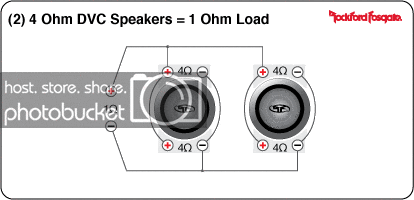

I would wire the coils parallel for 2ohm/sub, then parallel to the amp for a 1ohm final load. that should yield you 1200wrms available, and you can set the gain accordingly.
If I remember right, the P1's are only rated for about 150w and that Orion is rated for about 400 at 4 ohms and 1200 at 1 ohm. Hook it up as a 4 ohm load otherwise you'll be sending 600 watts each to those little guys.
