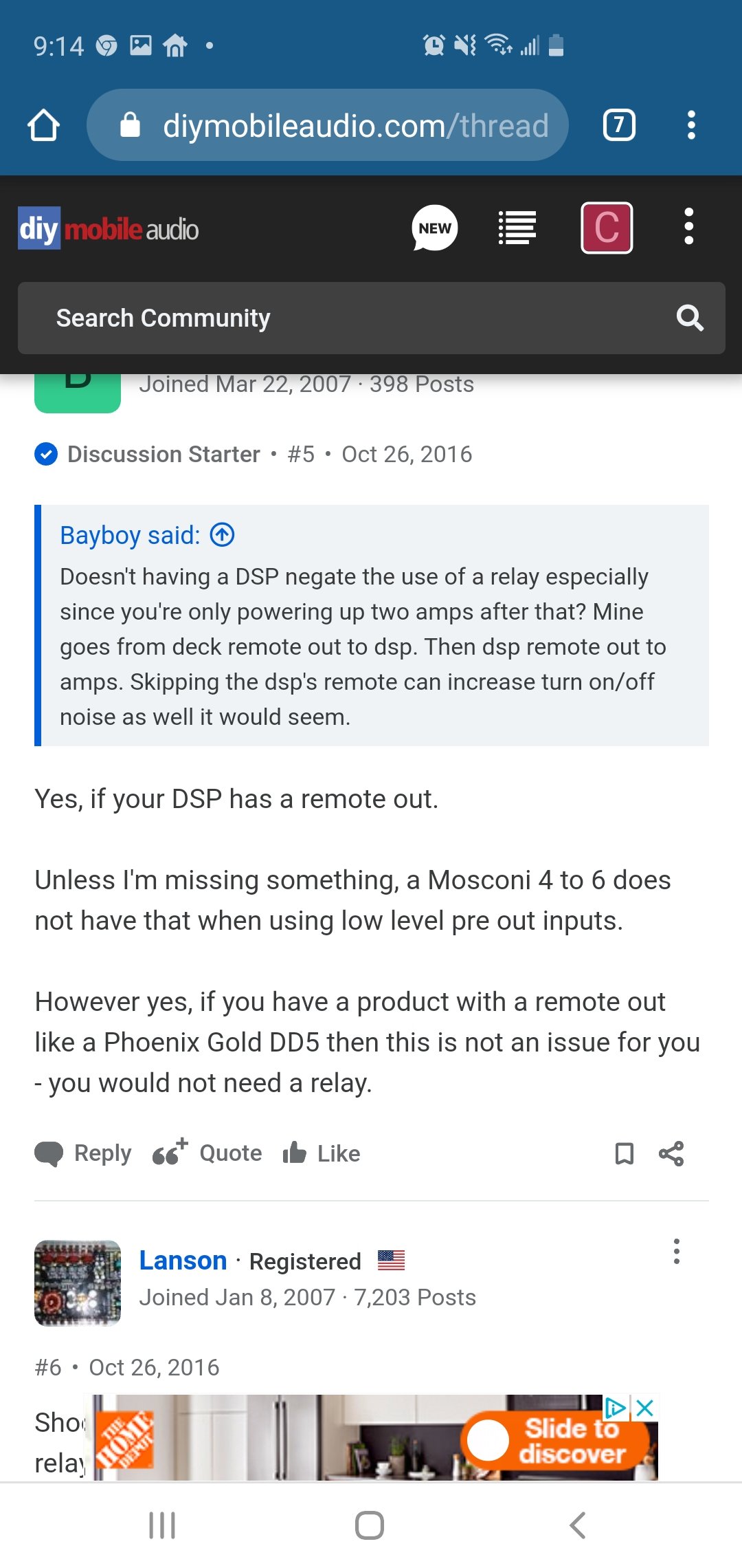

Just reading this.. having my dsr1 DSP.. would I still need a relay??

Thanks very much for the reply..
Why is this though ? Because of the dsr1 able to put out more remote wires ?

I have 3 amps, that use the same remote wire. I have No dsr1. The dsr1 is not the reason you are able to splice the remote wire. I hope I understood your question. You can PM me if you need further explanation. The quick answer to your question is that the remote wire is sending a strong enough voltage that it will turn on your amps.
