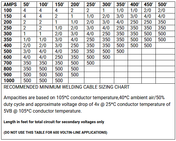

After looking at the 0 gauge wire I used before, I realized it was not ofc.

Agreed technically 2 runs is correct. Shouldn't be a reason why you can't run a 1/0 welding cable to that anl block then use that block to run 1/0 to the taramps and then 4 gauge to the barbara ann. This is CCI Royal Execelene Welding Cable and they claim up to 50 feet you will see 350 amps out of their welding cable. No way you are doing anything close to that long of a run. On a jeep what 10-15 feet?
