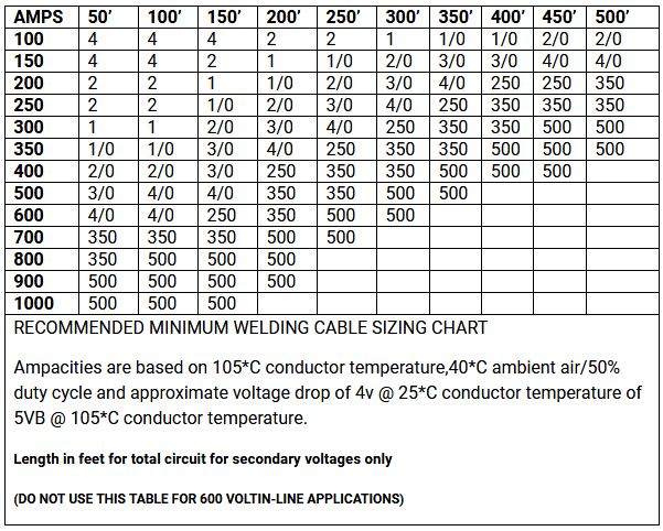

Agreed technically 2 runs is correct. Shouldn't be a reason why you can't run a 1/0 welding cable to that anl block then use that block to run 1/0 to the taramps and then 4 gauge to the barbara ann. This is CCI Royal Execelene Welding Cable and they claim up to 50 feet you will see 350 amps out of their welding cable. No way you are doing anything close to that long of a run. On a jeep what 10-15 feet?

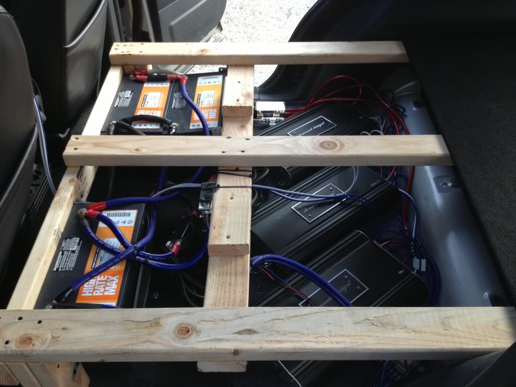

See I had 240 amp fuse rating for my sub amps, and I had 90 amps for my 2 channel. I had 4 runs of zero to the back, 2 pos, 2 neg. Audiopipe OFC 0 gauge. Had them fused @ 250 amp per power wire.

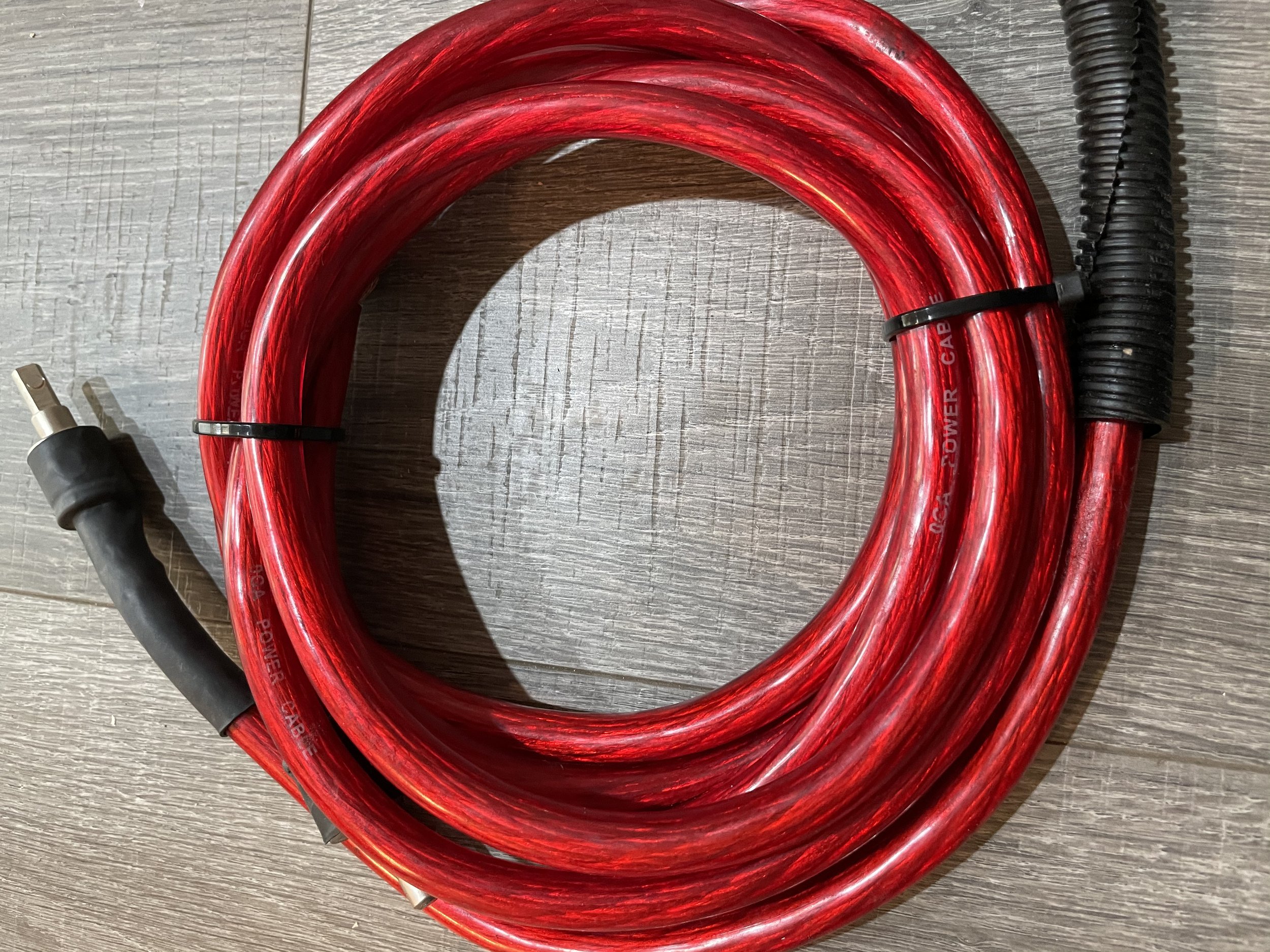

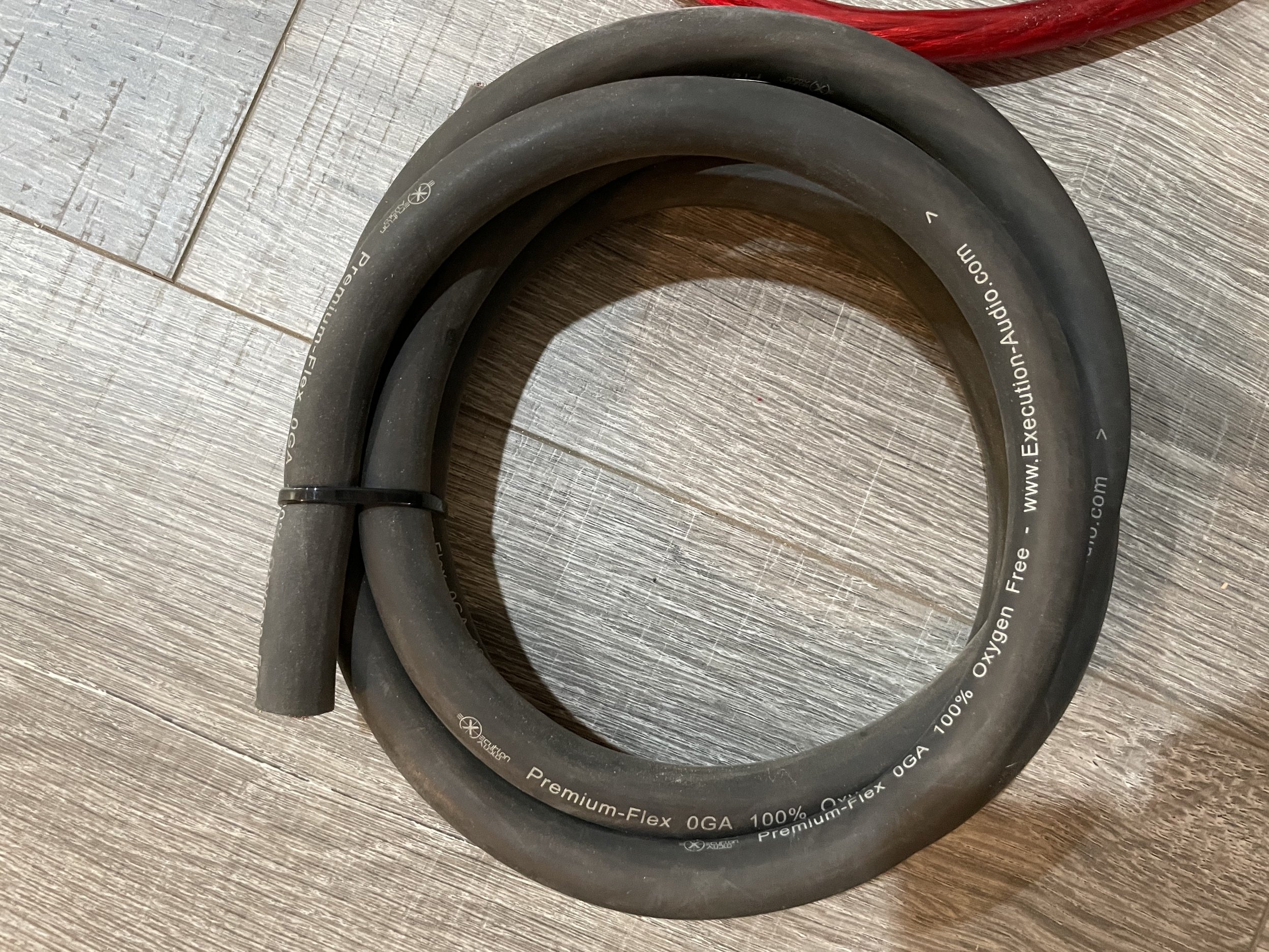

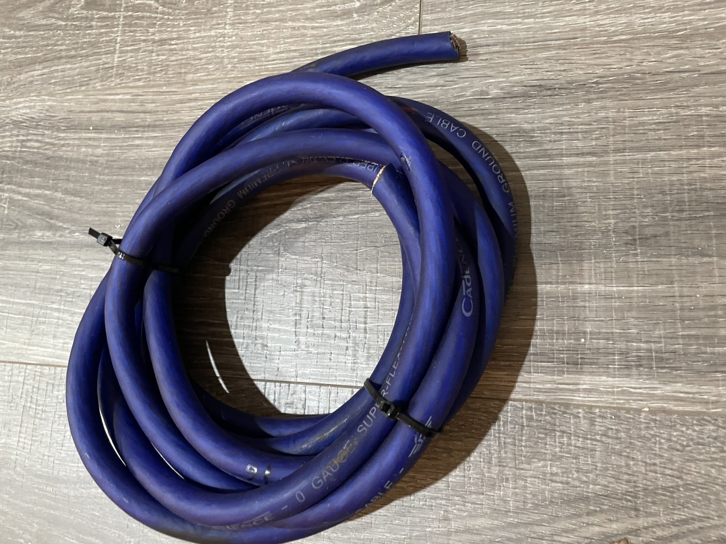

well, I looked and found that I had just about 11 feet of the red 0 gauge “power cable” going from the battery, under the old
Jeep (2007 4 door), to the rear cargo area.
I found the 13 feet of the blue Cadence “0 gauge super flex-twist premium ground cable”
and about 7 feet of the black 0 gauge Execution Audio “premium flex” Oxygen Free Copper wire.
Would I notice much difference replacing any of this?
