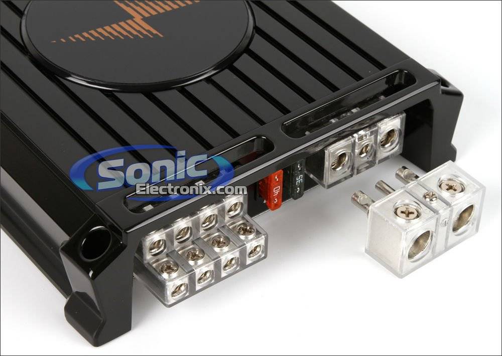

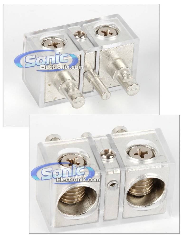

I was looking into the manual on the 900.4 and noticed it specified using 8ga on the power and ground wires. I just wanted to confirm it will accept 4ga since I'm also planning on getting a 1000.1 and the knu kolossus 0ga dual amp kit.
Also, regarding the remote wire; can I just use half of a 16ga speaker wire run to the hu? Noob question I know, but I want to make sure I order the right stuff.

it comes factory with a 0ga reducer
