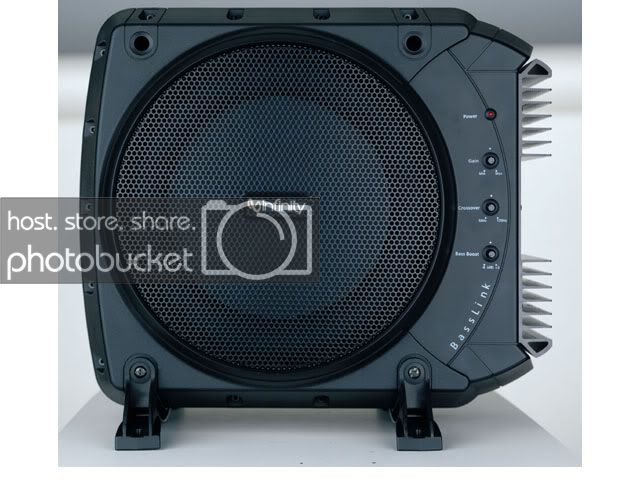

I just need to know what Gauge wire kit i should buy!
I was thinking and was told 8awg wire kit.

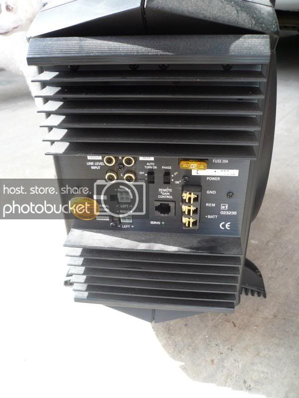

The booklet that came with my powered sub says (under the Power Connections part)
Installation tip
Use at least #12 AWG wire for the +BATT (+12Vdc) and GND (ground) connections. If needed, use at least a #20 AWG wire for the REM (remote) connection.
Install a fuse holder with a 20 A fuse within 18" of the battery + terminal.
The REM connection requires +5 to +12Vdc signal for Basslink to turn on remotely. Most head units with preamp outputs provide this remote voltage signal. For speaker-level applications, a remote connection is not required, since Basslink's Auto Turn-on feature will sense voltage on the speaker wires to automatically turn on Basslink.
THIS IS WHAT IT LOOKS LIKE
