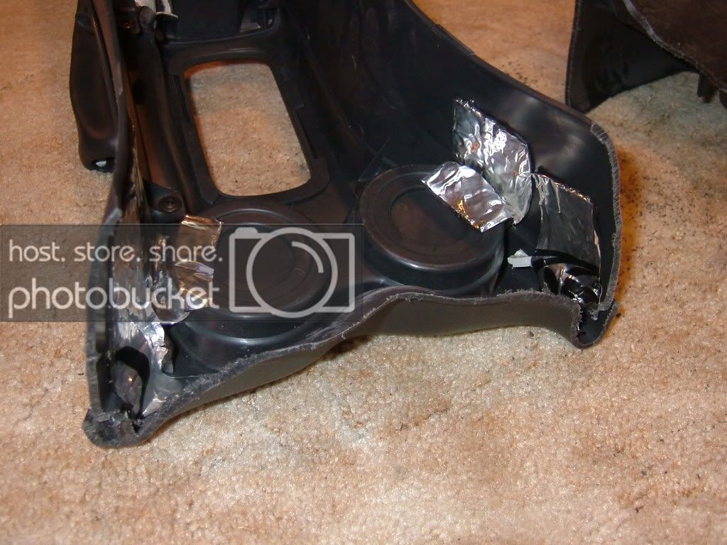

Deadening

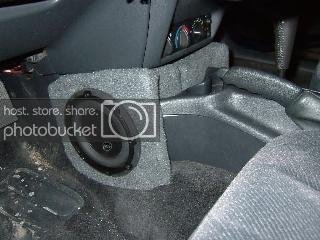

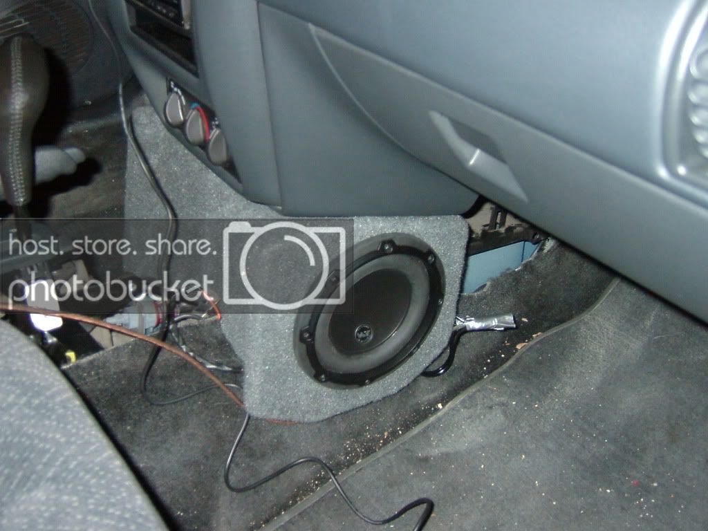

Any idea what the volume of those boxes are?
Almost .10 ft^3. A little less than the recommended .15 but i didn't have a whole lot of room to work with. I stuffed around 2 oz. of polyfill as well.
The construction was a little sloppy but they're sealed, they fit nicely, and sound amazing.
videos! but looks good i was confused unitl i saw the final results and it tuned out very nice!
My camera is being fixed right now. Thanks! It turned out sexier than I thought.
Hey how does it sound? I've been thinking about doing something similar to my center console but i wasn't sure how it would sound....Thought it might sound kinda off with the midbass coming from that angle....lmk....
Nice work....
