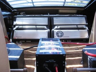

It will work great. Love those old Kenwood amps. Run the sub @ 2ohms and you should be fine. Make sure you set the amps gain properly. I ran these two for a while in a 280zx. That amp will move that sub great. If the sub is in a good enclosure it should sound awesome. Do some research on setting amp gains. It will help a lot.
